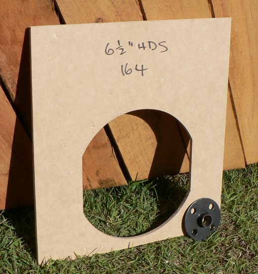

Make a jig and use a jig guide on the router (see pic). The jig is cut oversize and is related to the bit size and jig guide collar.

It's no problem with a good jigsaw as you can cut within 0.5mm easily. I use 8mm MDF for the jig and use a 6mm or 8mm bit to do the rebate. I tend to cause more damage to the jig by sanding over the cut a bit to exuberantly.... better left as cut as the router jig guide tends to glide over any anomalies due to the larger radius.
You can use the tweeter mounting holes to locate and hold the jig but generally clamps work well. The jig just has to be large enough so the clamps are away from the router base. Cleats can also be screwed on the underside to lock on the side etc of the enclosure so there is no movement.
A test run on some scrap material is advisable but I generally just get into the enclosure.

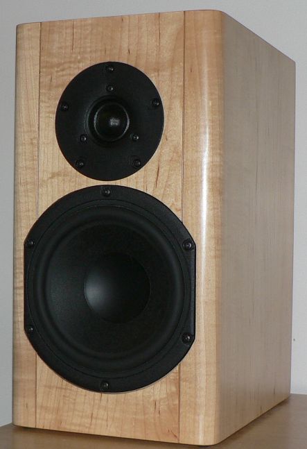

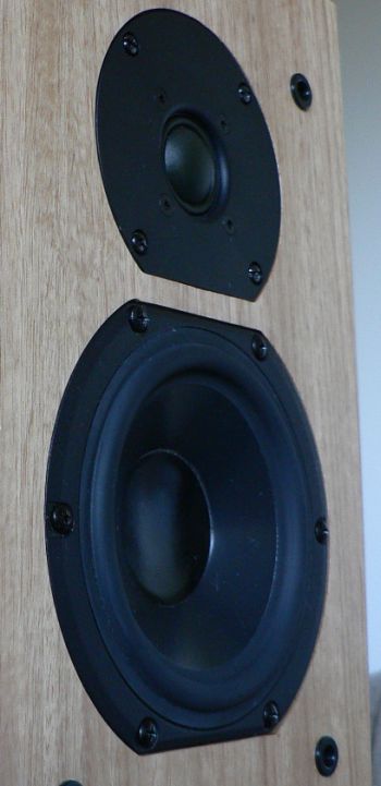

Here's some rebated HDS drivers and one also has the tweeter rebate done via a jig due to the flat edge on the faceplate.

With that you would end up with a gutter (moat) between the edge of the basket and surround. AFAIK, having the surround extending past the baffle has no detrimental effect and is how 99% of speakers are built.
The HDS drivers do have a chamfer near the edge so even when rebated the basket still extends past the baffle. Drivers such as the PL18 etc can have the basket completely flush but the surround of course still sits proud. The 18W8531 has a radius on the basket so the edge can only be flush and the basket near the surround is about 3mm away from the baffle.
The main thing is to rebate the tweeter and it is not important for the mid woofer. I've built plenty of speaker with the HDS not rebated with no detrimental effects. Some who do that turn the driver 90° (also helps with smaller driver centres) to what I have done and place foam on the flat edge below the tweeter.
HDS with foam on top
