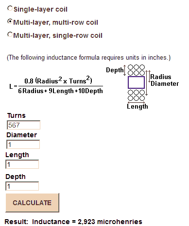

How to create a coil (self) knowing the inductance ?
When I had my shop, I sometimes needed a 2.9mH coil for a speaker. I would buy them from Parts Express, but they only came in even values. SO I bought a 3mH coil, connected it to my L meter, and unwound some turns until it went down to 2.9.
