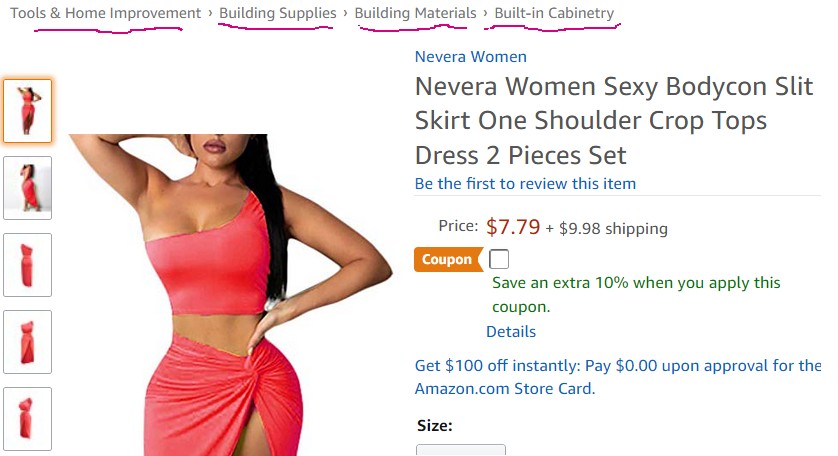

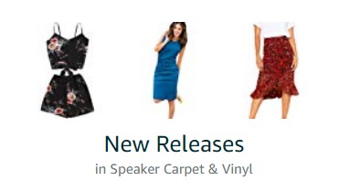

OT: Amazon listings can be VERY messed-up:
