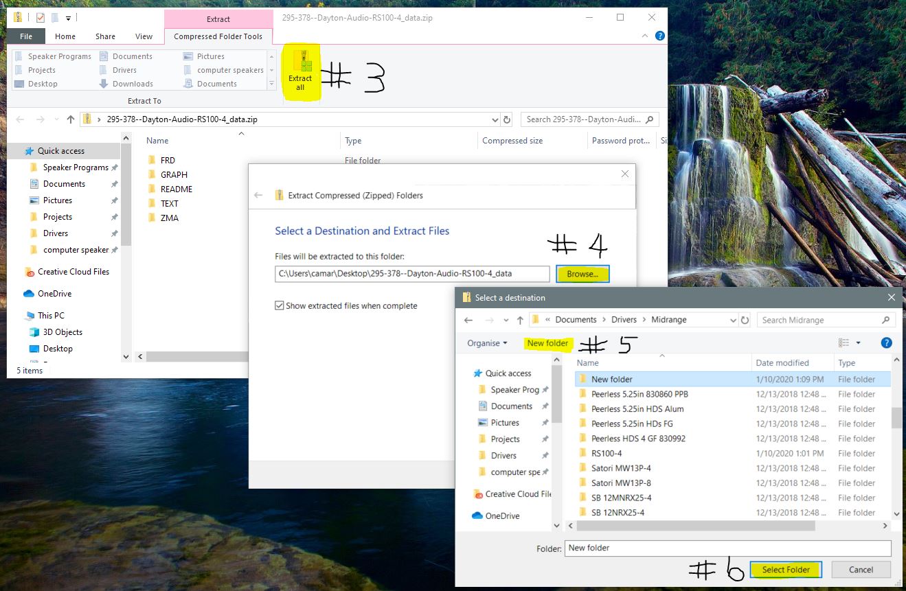

I'm using Windows 10 and it does indeed have an extractor built in. Here's what to do:
1- Download the PE driver specifications, I'll use the Dayton RS100-4 as an example. I choose my desktop as the location.
2- From your desktop, open (double click) the zipped file.
3- Click on the "Extract All" icon.
4- Click on the "Browse" button to choose or create a new folder for the new unzipped file.
5- Create the new folder if it doesn't already exist. It helps to organize yourself here - in my Documents folder, I already have a Drivers folder created, which then contains individual folders for Tweeters, Midrange, Woofers and so on. Or choose whatever works best for you. Here, I'll choose the Midrange folder (or whichever one you want to use) and then click on the "New Folder" button to create a new folder named something like "Dayton RS100-4".
6- Then with the new folder highlighted, hit the "Select Folder" button.
You should get something very similar to the 1st attachment. Appropriate buttons are highlighted in yellow. Sequence is from left to right.

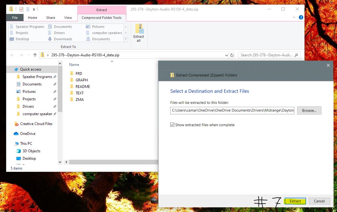

7- Now hit the "Extract" button (pic 2) and you are all done.
You should be left with 2 open windows. Close them up and you can also delete the original zipped folder on your desktop and you should be good to go.
Now in XSim when you are "Tuning" your drivers, simply navigate to the correct driver folder (hopefully after you have correctly added in the box and baffle effects) and open up the frd or zma file you want to use.
There is another way of doing this too which you might find easier. Create a folder for the new driver and open it up. Download the zip file like before, open it up and move it over beside your open driver window file. Now open the FRD or the ZMA folders in the zipped folder as desired and then simply drag and drop the files you want from the zipped folder to your new driver folder (or copy and paste too). Once you have what you want, you can again now delete the downloaded zipped folder.
