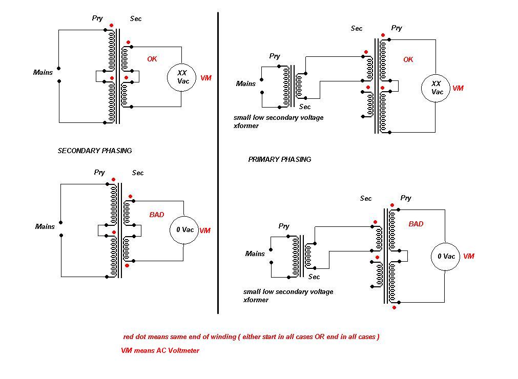

easy
connect two ends of secondaries together , and use that connection as gnd
but you must check phasing
look at this pic and search on forum , somewhere .....
