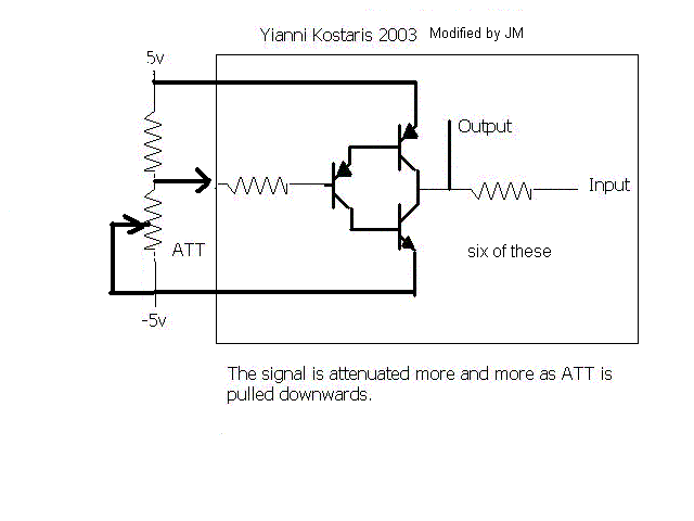

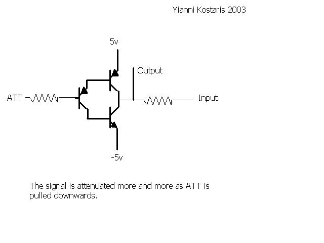

Solid Snake said:
I also wanted to do something like you are doing. I wanted to use a digital volume control or maybe one of those digital pots but they are not very linear so I drew this up one day when I was bored in class, tell me if it makes sense.
Good Lord man!! Get yourself a circuit drawing program!!! :faint:
As for a simple solution...find someone to sell you a 8 module Clairostat, like this: http://www.potentiometer.com/partdata.cfm?partno=389&session=2003112110113389
MS Paint to the rescue...
No I haven't tried breadboarding this. It seems that a 470-1K ohm resistor on the input should work okay. For the ATT resistor you may want to try something like 100K, you can play with different values but don't go too low or it may burn up. You can use a 2N2222 and it's complement, since the signal doesn't actually go through the transistor I don't think it matters much. If you try this, let me know how it works for you.
