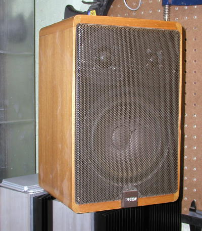

I have a pair of Canton speakers that have a pressed metal grille with a million 2 mm holes ala Jap portable audio speaker grilles.
They dont do any serious sonic damage (better even), look really smart, and are totally little finger proof.
Eric.

These grills do a great deal of sonic damage and anyway he's not going through the trouble of trying to form them even if he could find the perforated metal at the local hardware store.

The grilles on the Cantons are quite fine to my ear, and they are totally finger proof.

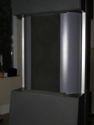

grill cloth experiment in progress
This is going to be a grill cover eventually. Once i settle on a tweeter i'll carve a hole in the wool-felt pad (salvaged from inside a dead Marsland) for the T, stiffen the pad with something (i'll try white wood glue to start), wrap some double-knit over it (salvaged from Ditton 25s) and velcro (salvage again) them to the box. The star helps kill some peakiness in the driver.
By the time i get these giant killer's tuned & finished they should still have cost less than $100 CAD (~$65 USD)out of pocket.
