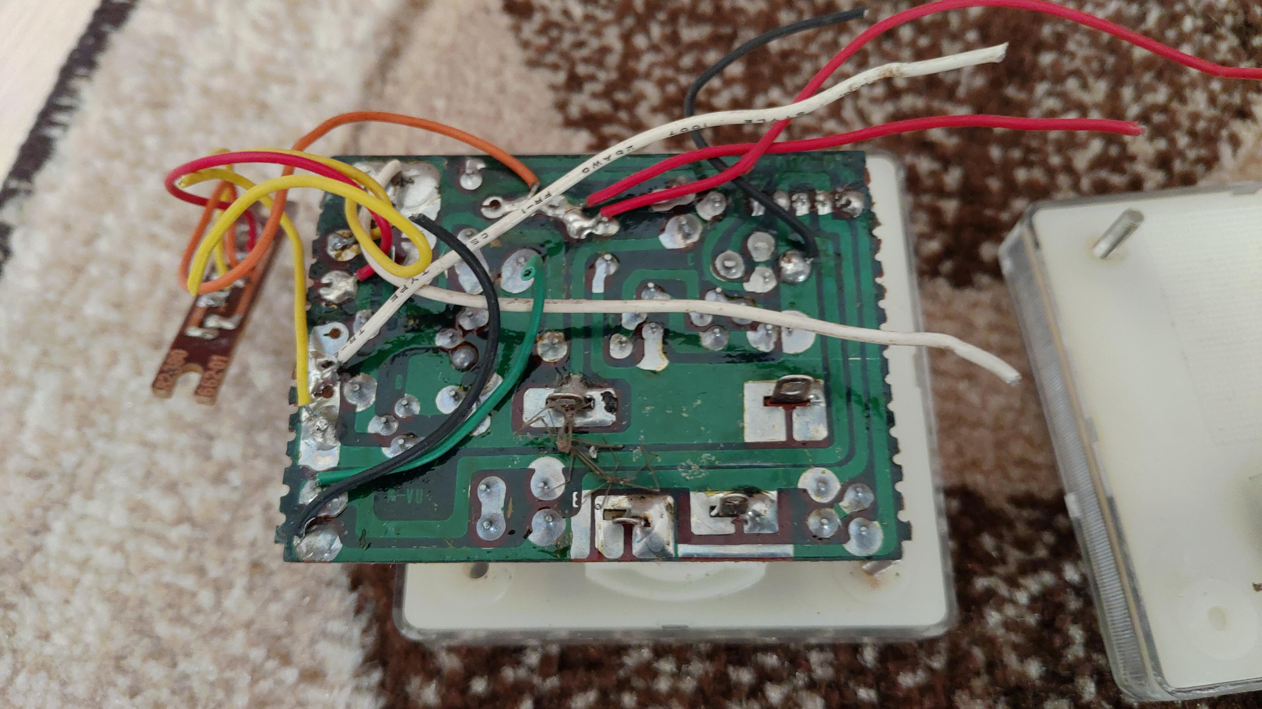

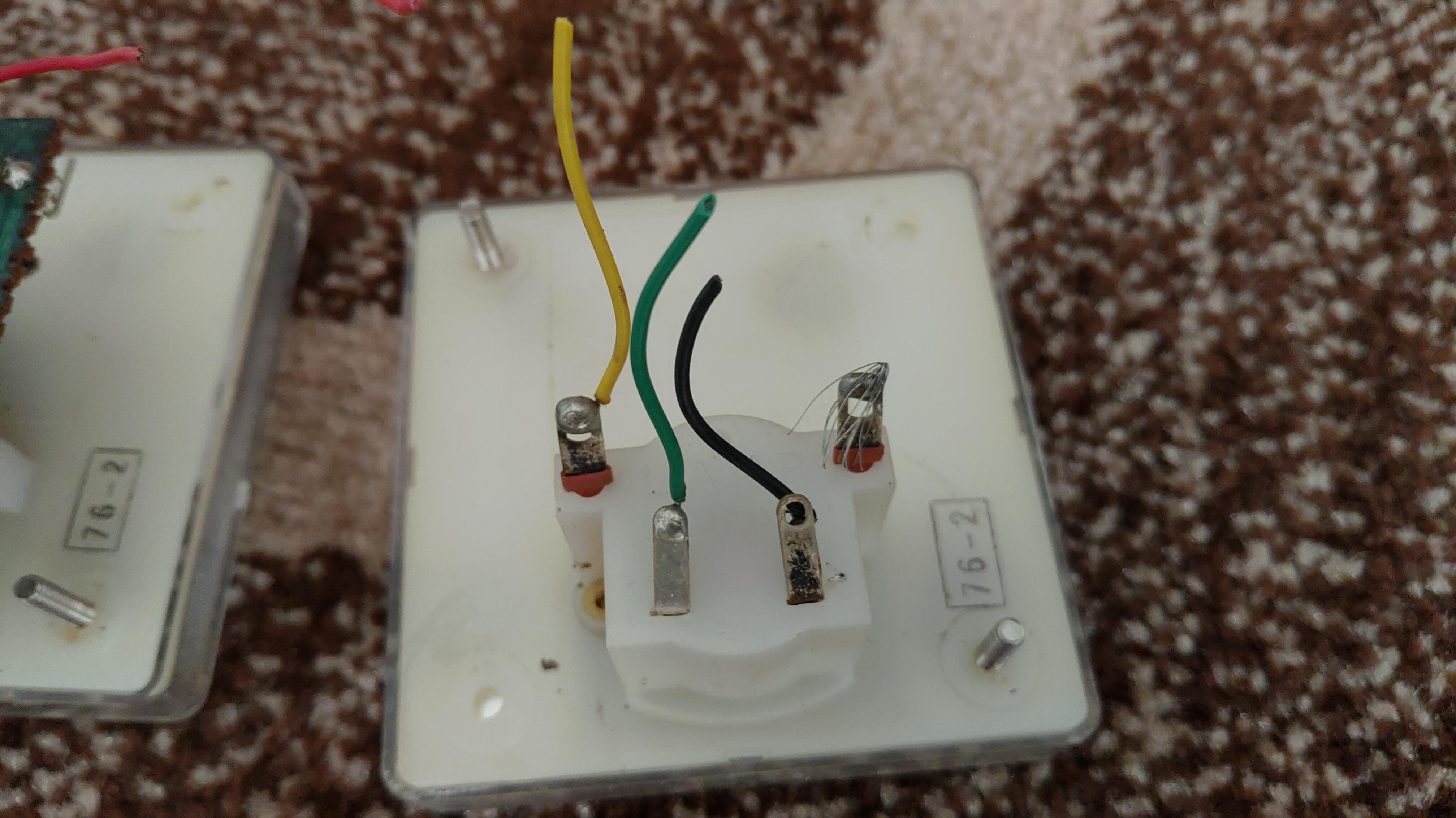

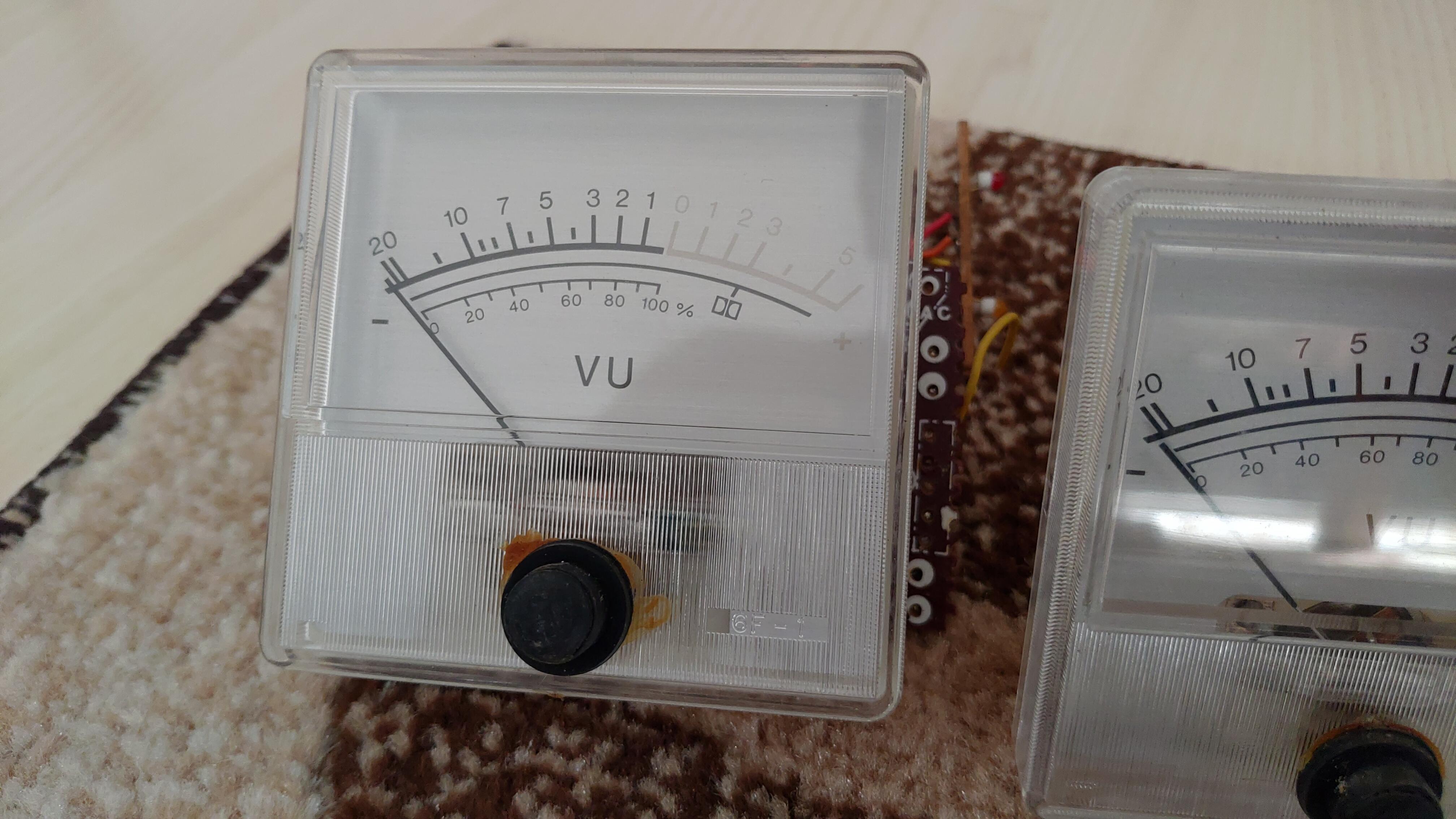

I just saved two vumeters from a deck I saw in the scrap container (Aiwa Ad6500) and I need some advice on how to wire them up in order to use them between my computer line out and amplifier...
Since I am a noob I hope some of you can help me with a few instructions.

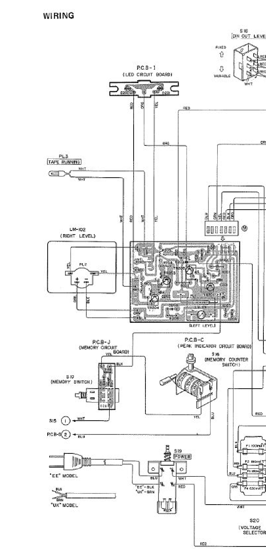

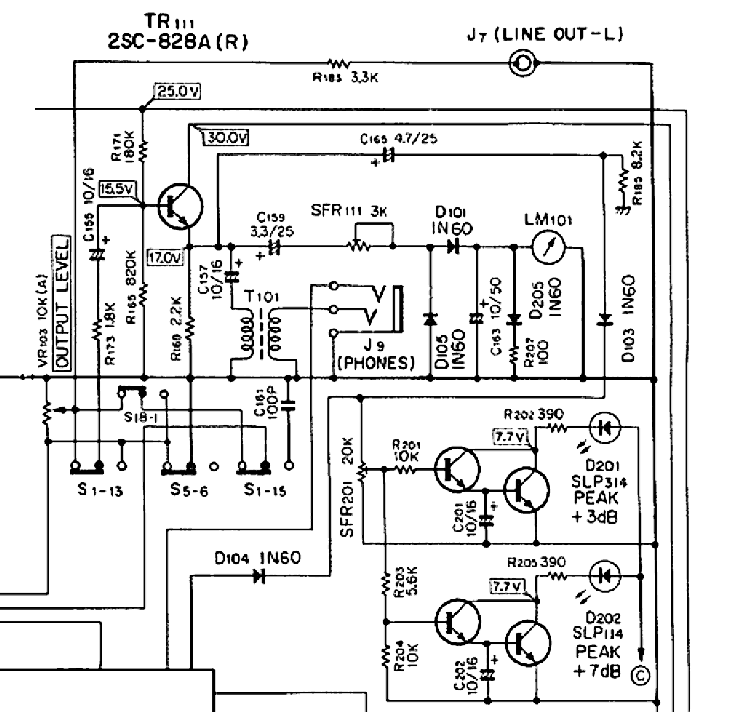

Attached you can find the photos (front / back) and the schematic I found over the net.

You are going to have to do some research, however here are some pointers...
1/ The meters are standard moving coil types and so that means you must rectify the AC (audio) voltage to give DC.
2/ You can use passive rectification using a couple of diodes (germanium types are best because of their low volt drop), however even these result in meters that still need a fair bit of signal to get them to move.

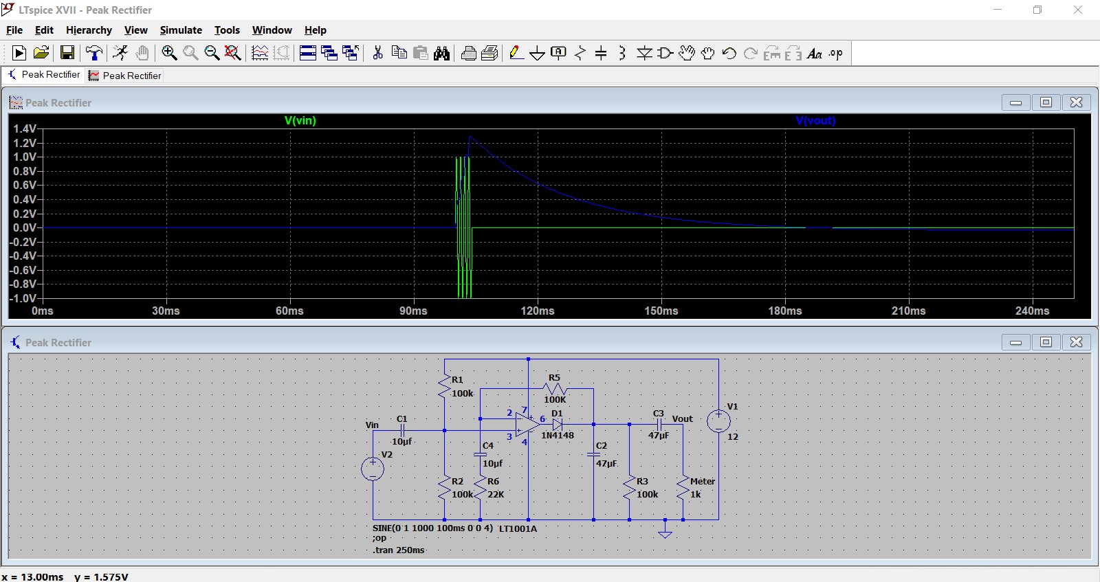

3/ The best method is an active rectifier that overcomes these limitations and this also allows the meter to respond to a fast transient and then 'hold on' a little to the signal so that the needle has to time to move.
This shows a simple opamp stage. Look how the very short duration input signal generates a decaying DC voltage for the meter to work with.
If you want to to use the Aiwa driver then you will have to look at the actual circuit details and not just a board layout.

All pertinent data can be doped-out from the service manual:
Aiwa AD-6500 - Manual - Stereo Cassette Deck - HiFi Engine

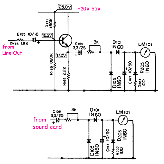

They are DC meters. AIWA put a PCB on back with diodes and buffers. I see you have one; I sure hope you saved the other also. Then all you need is a +20V to +35V DC supply.
The AIWA plan buffered so it would not inject distortion on the Line Out (which is a pot). If you are coming from a PC sound card, these normally have quite powerful (high current low-Z) outputs. Then you can omit the buffer (and power supply). Try that first.
Ge diodes can be had from Small Bear Electronics. (There are many-many on eBay but a lot are NOT true GE, but Schottky which is close or just random sweepings which are probably high-V Silicon.) True 1N34 is equivalent to 1N60 for our purposes. (1N60 is newer so in AIWA's day it seemed better.) In fact any Germanium Small Signal diode will be fine. At The Bear, the 1N3470 ITT, Transitron AN307, and 1N56A Solitron look like good bets.
The 3k trimmer can be a 1k fixed for non-calibrated dancing needle.

PRR, as long as I remember, it was just one pcb on the back of the left vumeter and from there some wires to the right one.

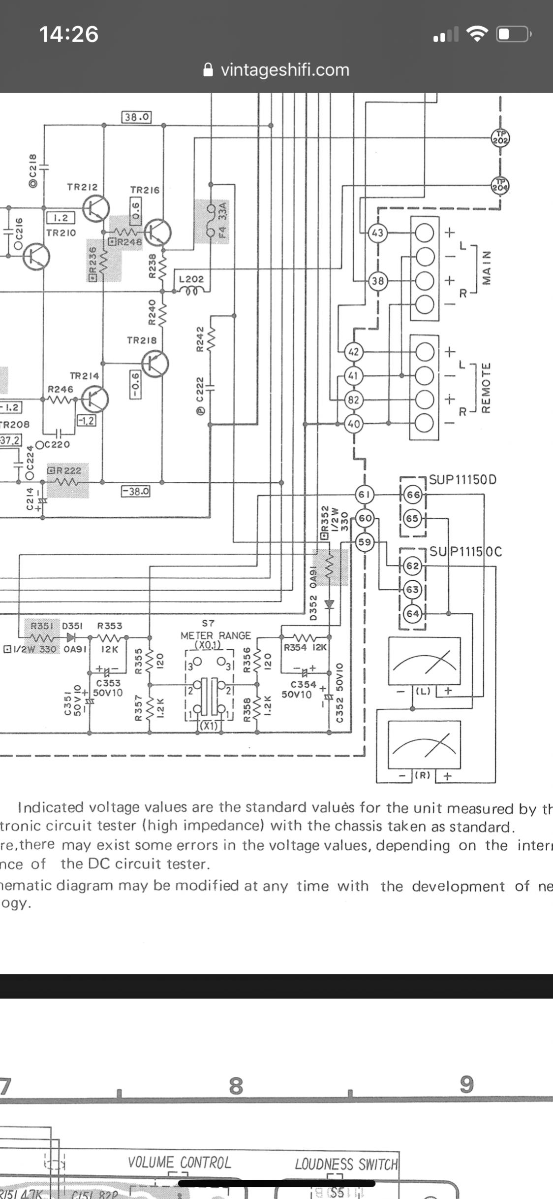

I have a Technics SU-7300 amp from the 70’s that is faulty. I want to put a new amp inside and use some of the original components including the vu meters. Are they sensitive enough to work off the line in after the volume? My DAC has a 2v SE output and the amp had a sensitivity switch for the VU meters. Could I use the original circuit for the VU meters if I get a bit creative? I thought I might be able to wire in a 10k attenuator where the sensitivity switch is to fine tune it.
I would say 'probably not' tbh. Not 'as is' anyway.
The circuit is relatively insensitive being just a passive design. Note the diodes which are OA germanium types, chosen for their low forward voltage.
Another problem is the input impedance of the circuit is a bit low to hang off a low distortion line level source even if it could drive it otherwise.
Hanging it on the wiper of the volume control is out of the question I'm afraid.
Having said that, you could easily rig up a single dual opamp to drive them (with gain if needed) and you could feed that from the volume control directly. That's easy to do.
