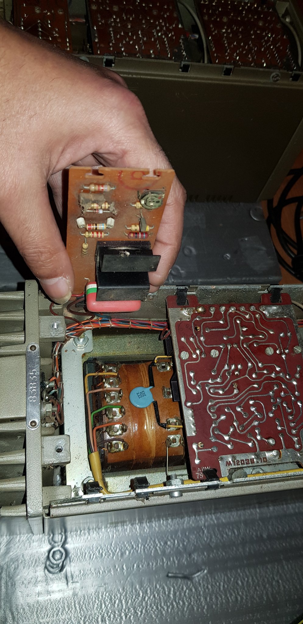

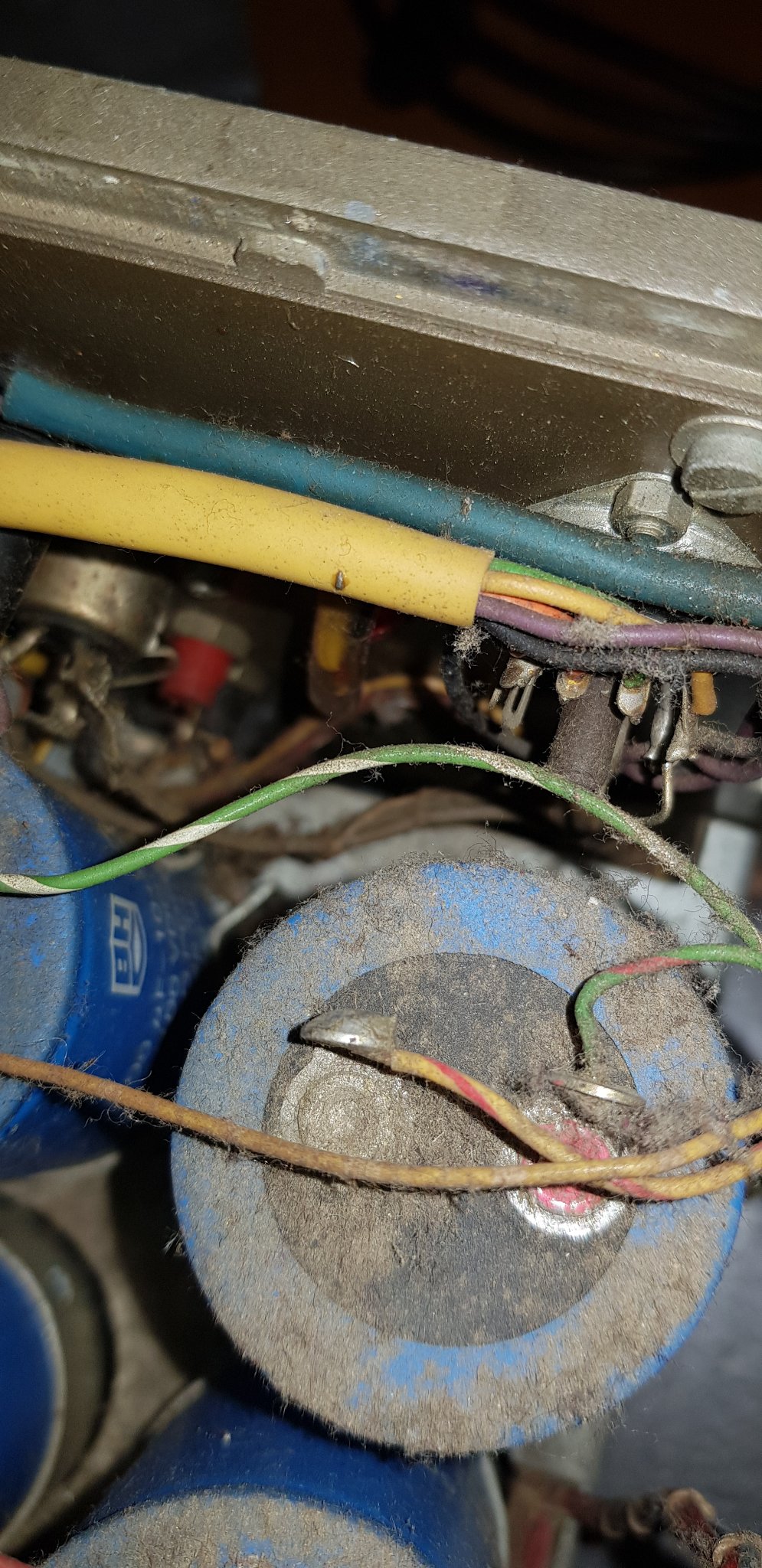

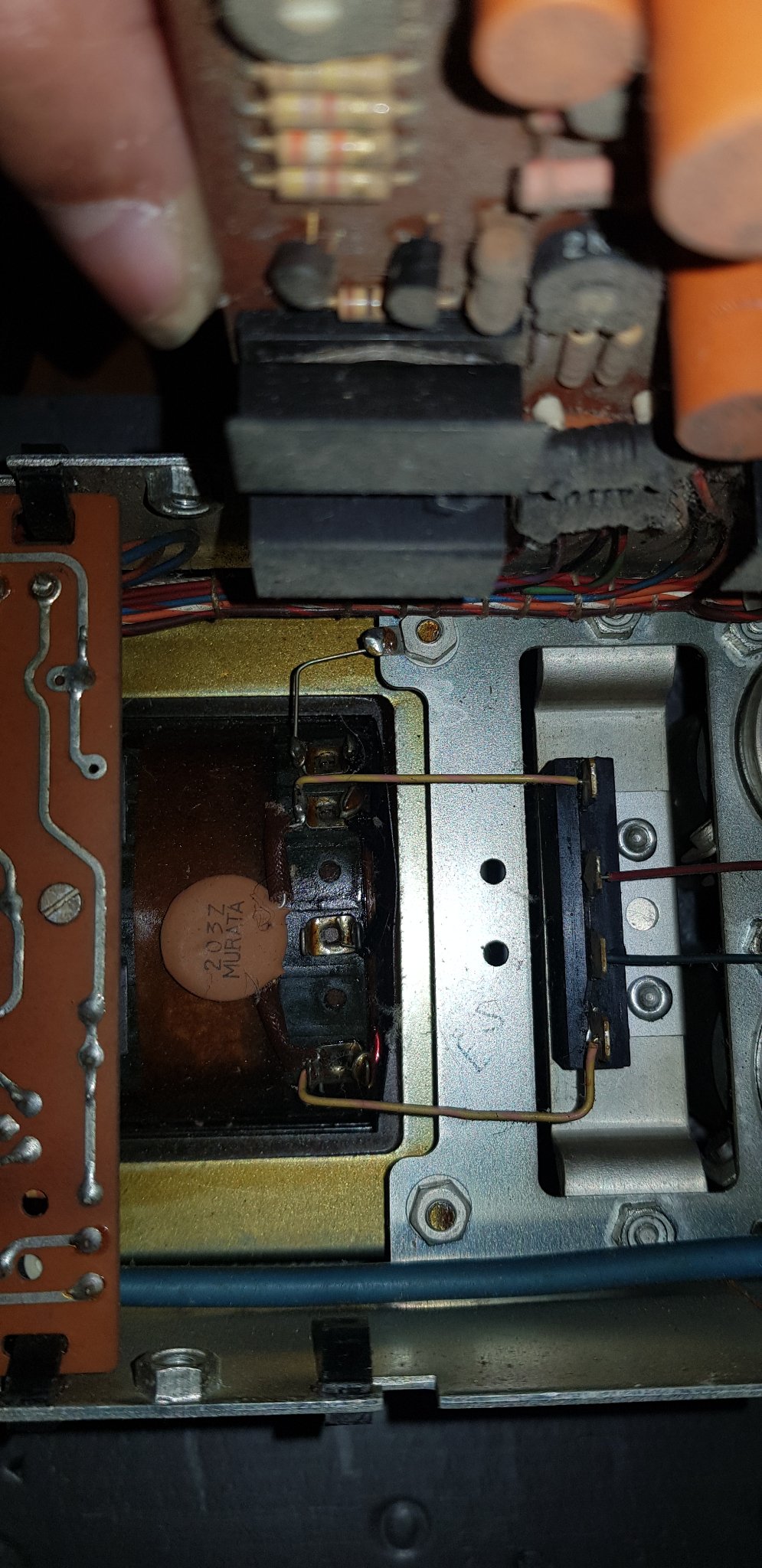

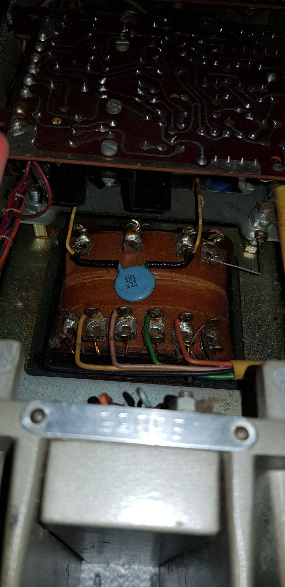

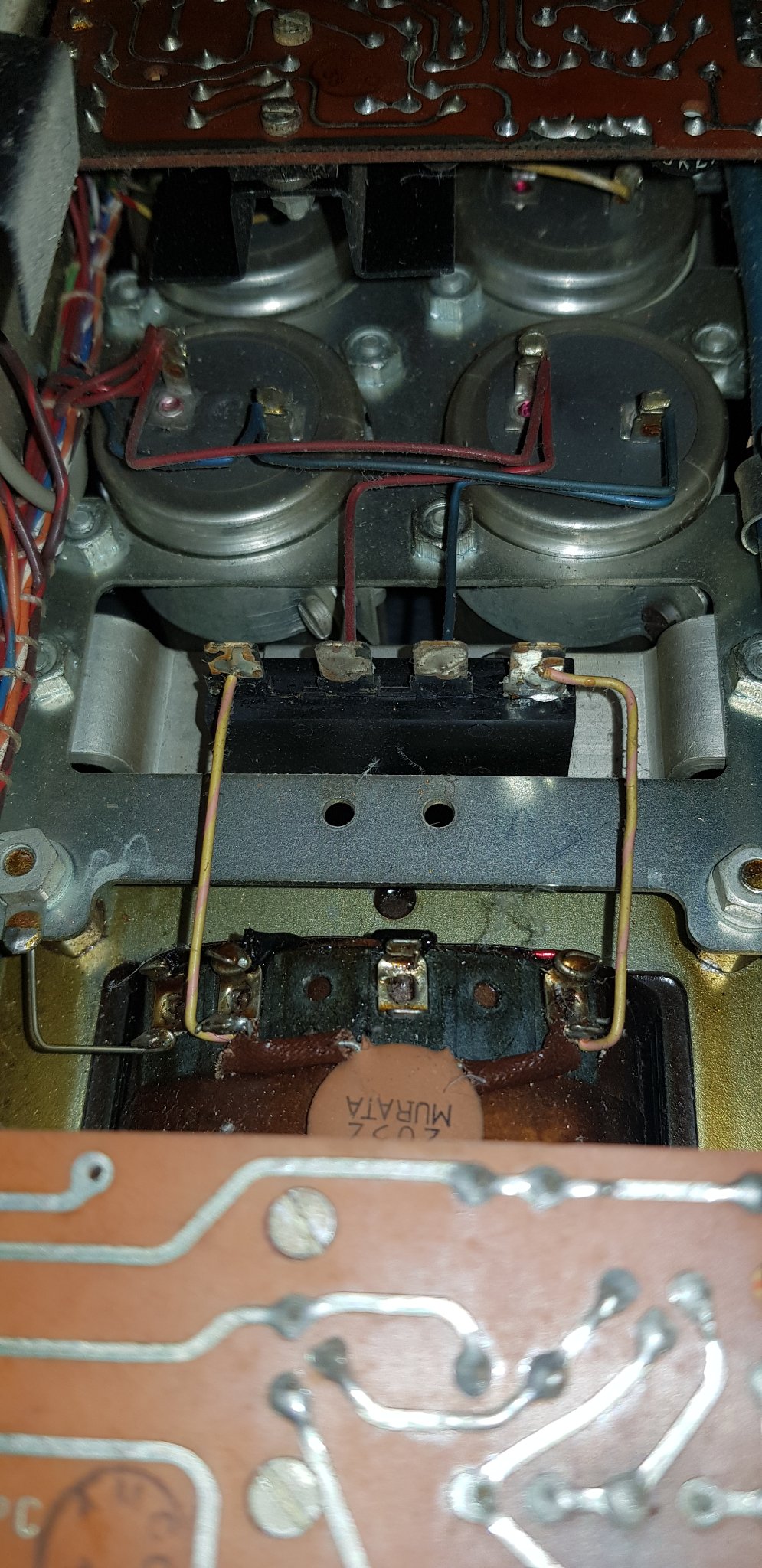

How to connect QUAD 33 to 2×303s (Vintage)
Under transformer

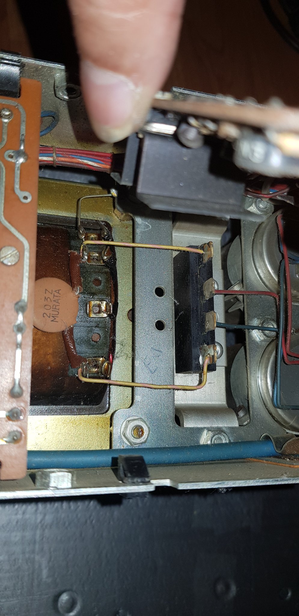

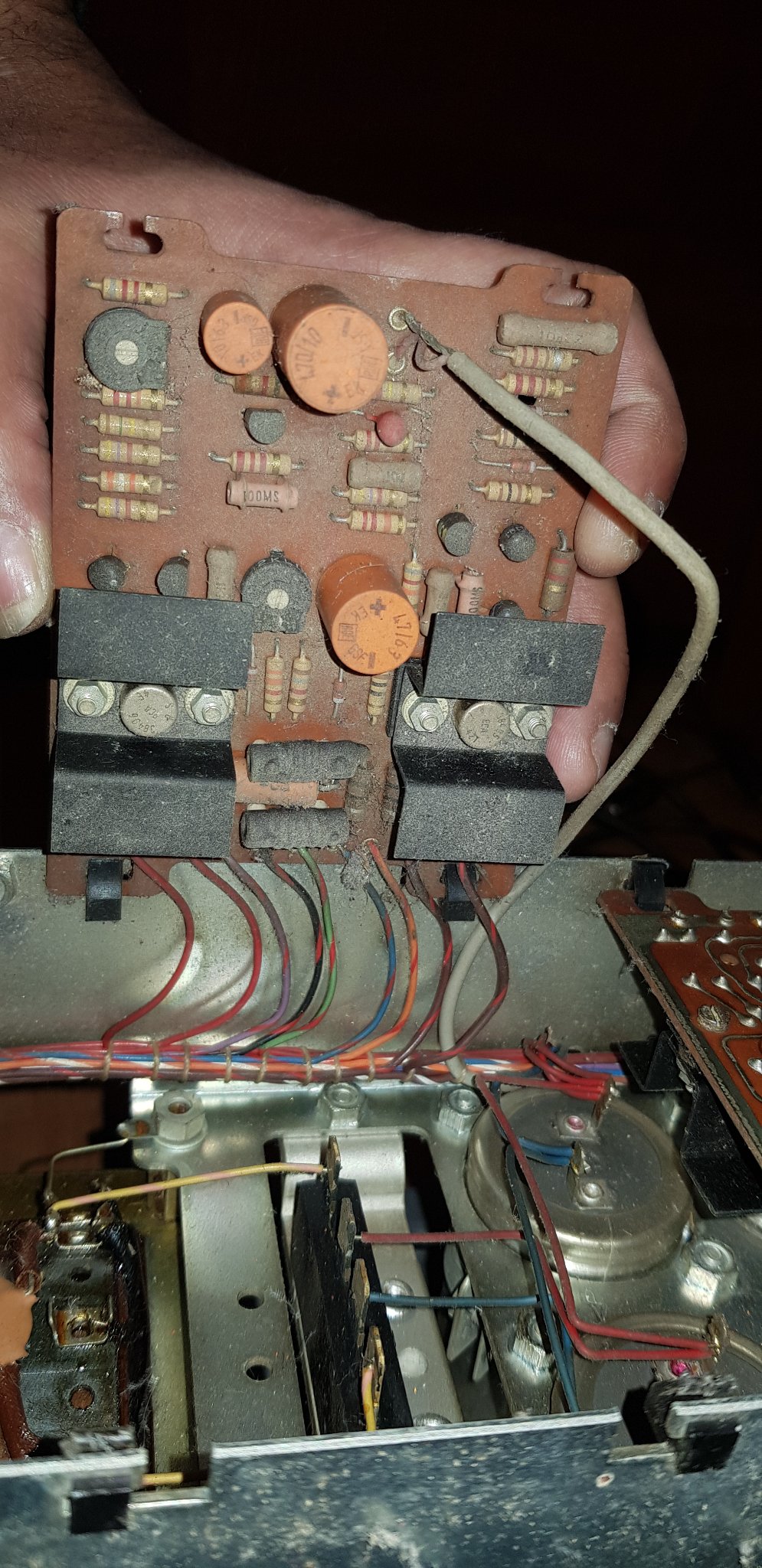

I was hoping to see a preset potentiometer that had been inserted between the rear of the input socket and the destination circuit board.
The 2.2 kiloohm resistors on the speaker outputs would appear to be a later addition.
I'm afraid that figuring out how the previous owner set up the system requires a hands-on approach that I am not in a position to supply.
By removing (or disconnecting the power lines) to one channel you allow the remaining channel to use the entire capacity of the regulated supply.
This is not correct. Each board has current limiting. Removing one will have no effect on the other’s maximum current whatsoever.
It’s curious that Rob Holt posted that misinformation in post #20 when it had already been contradicted in a quote from Joost Plugge in post #16.
  • Thank You
Reactions: Galu

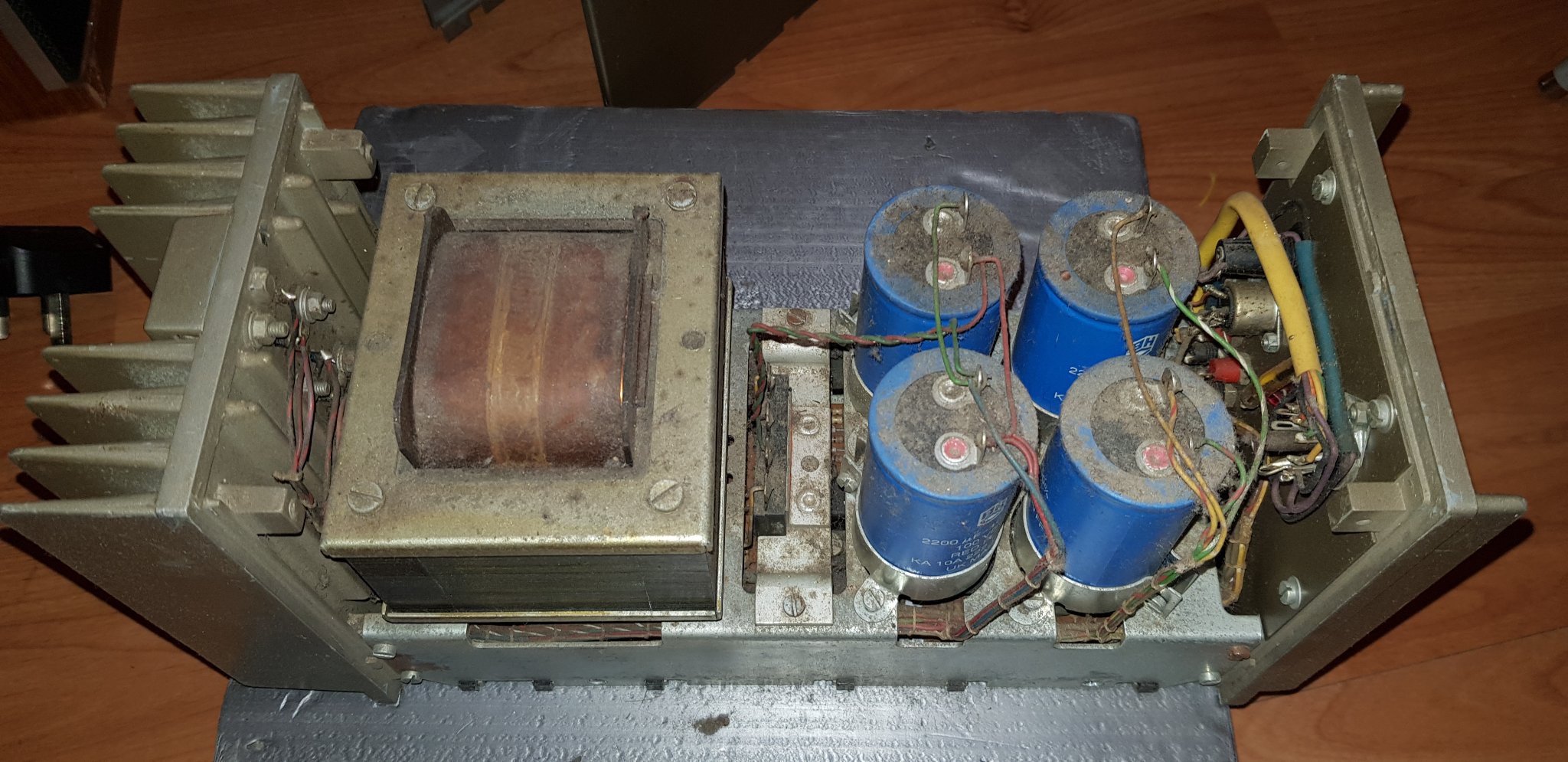

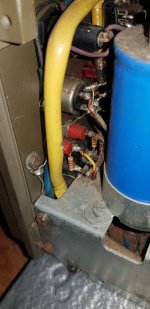

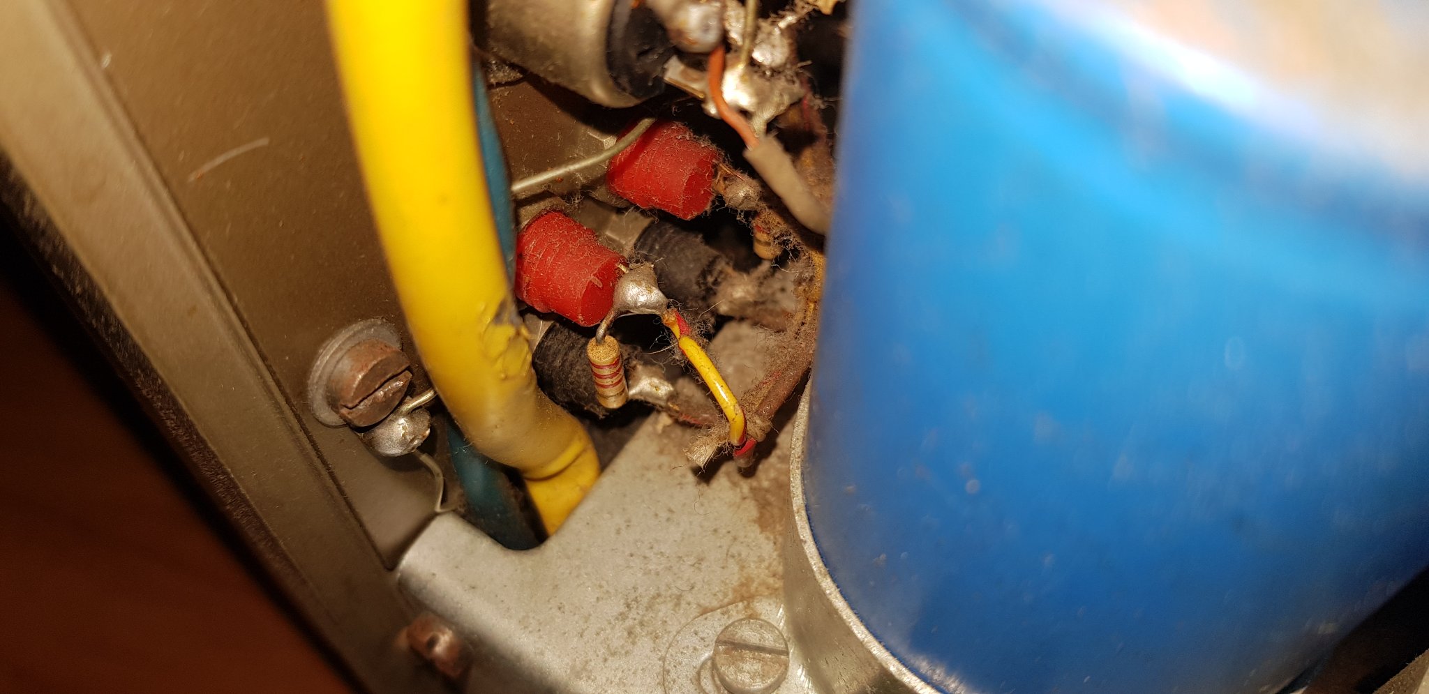

The other 303

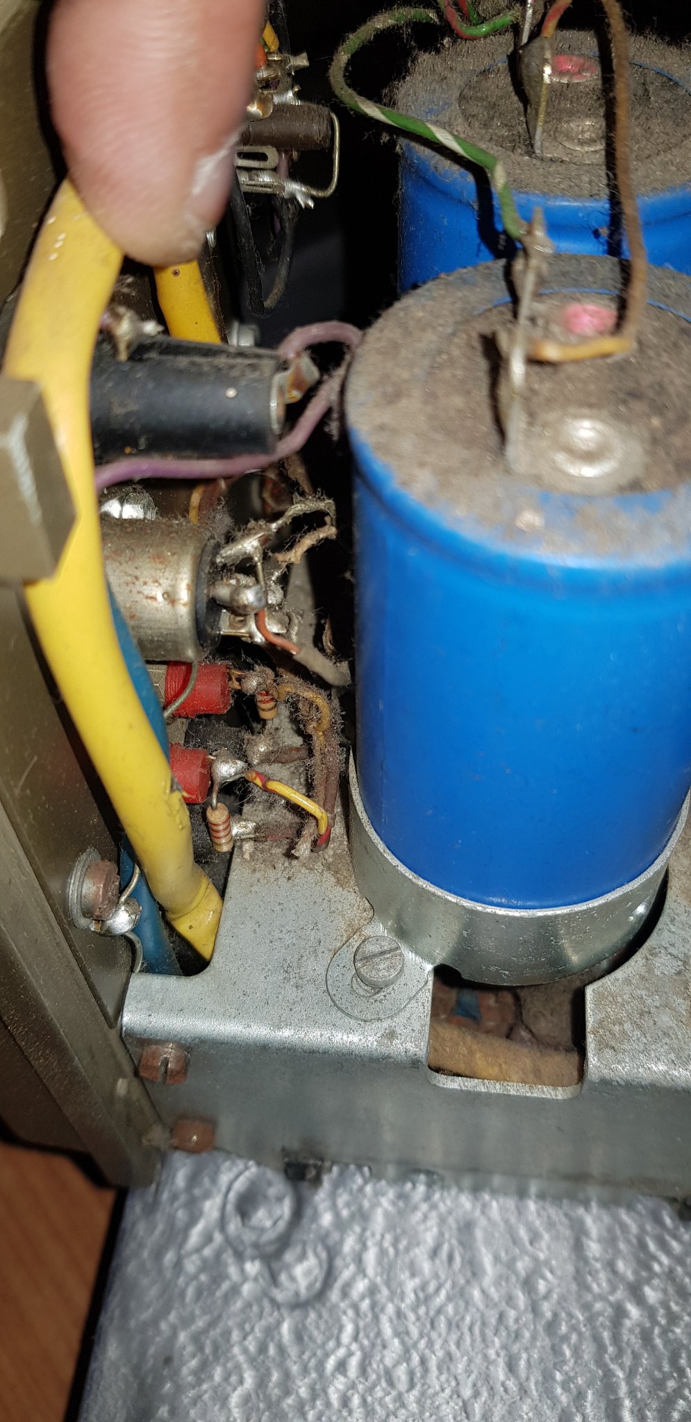

The pictures of the second 303 don't reveal any useful information other than it appears to be unmodified.
I would be checking that each 303 works individually with the 33 in the manner that Quad originally intended.
Only then would I be considering the possibility of converting each 303 to a monoblock.

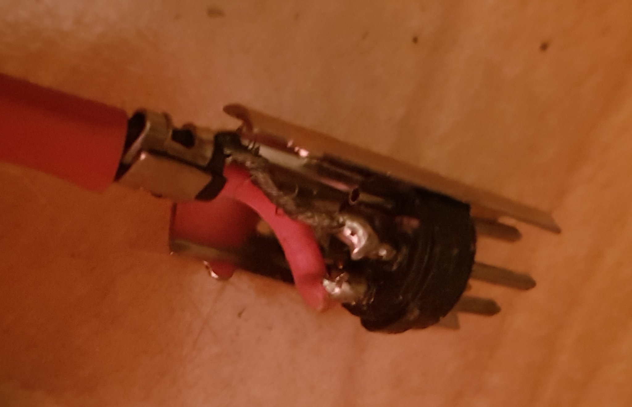

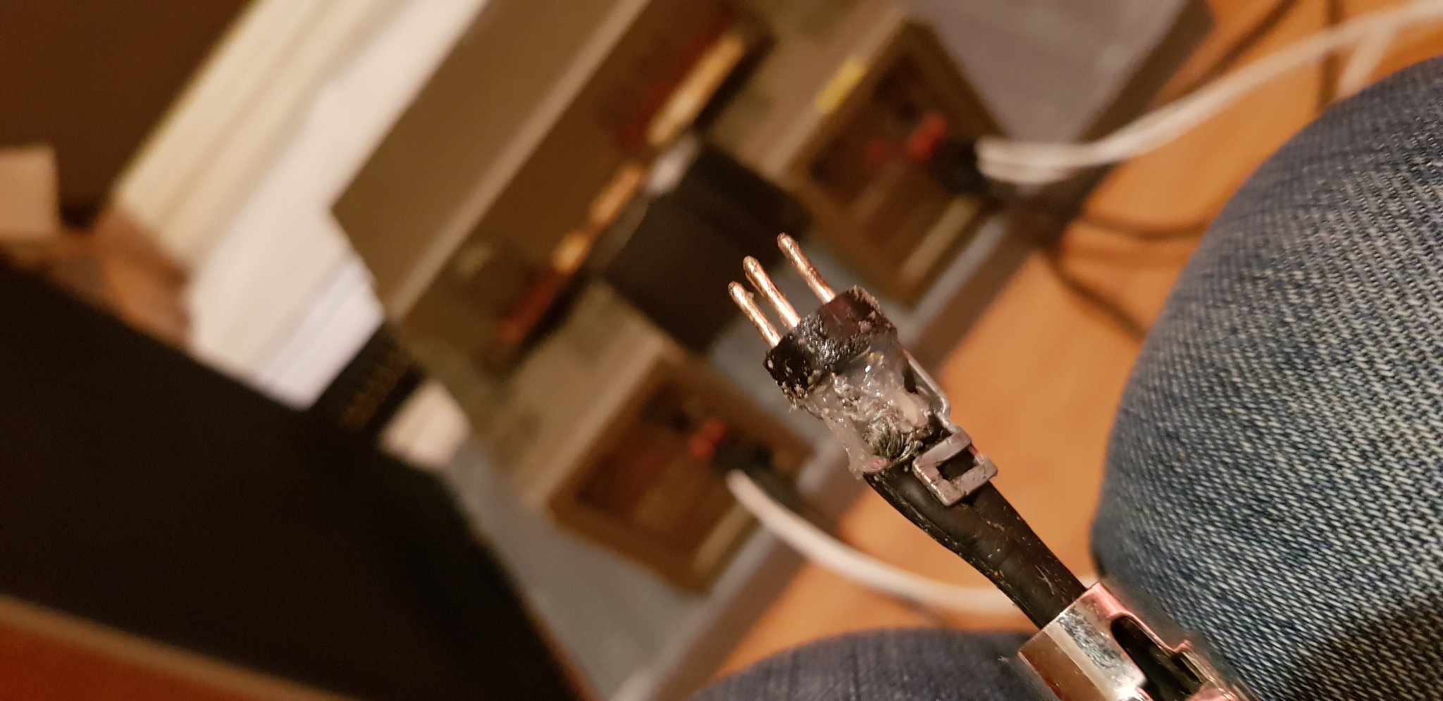

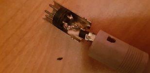

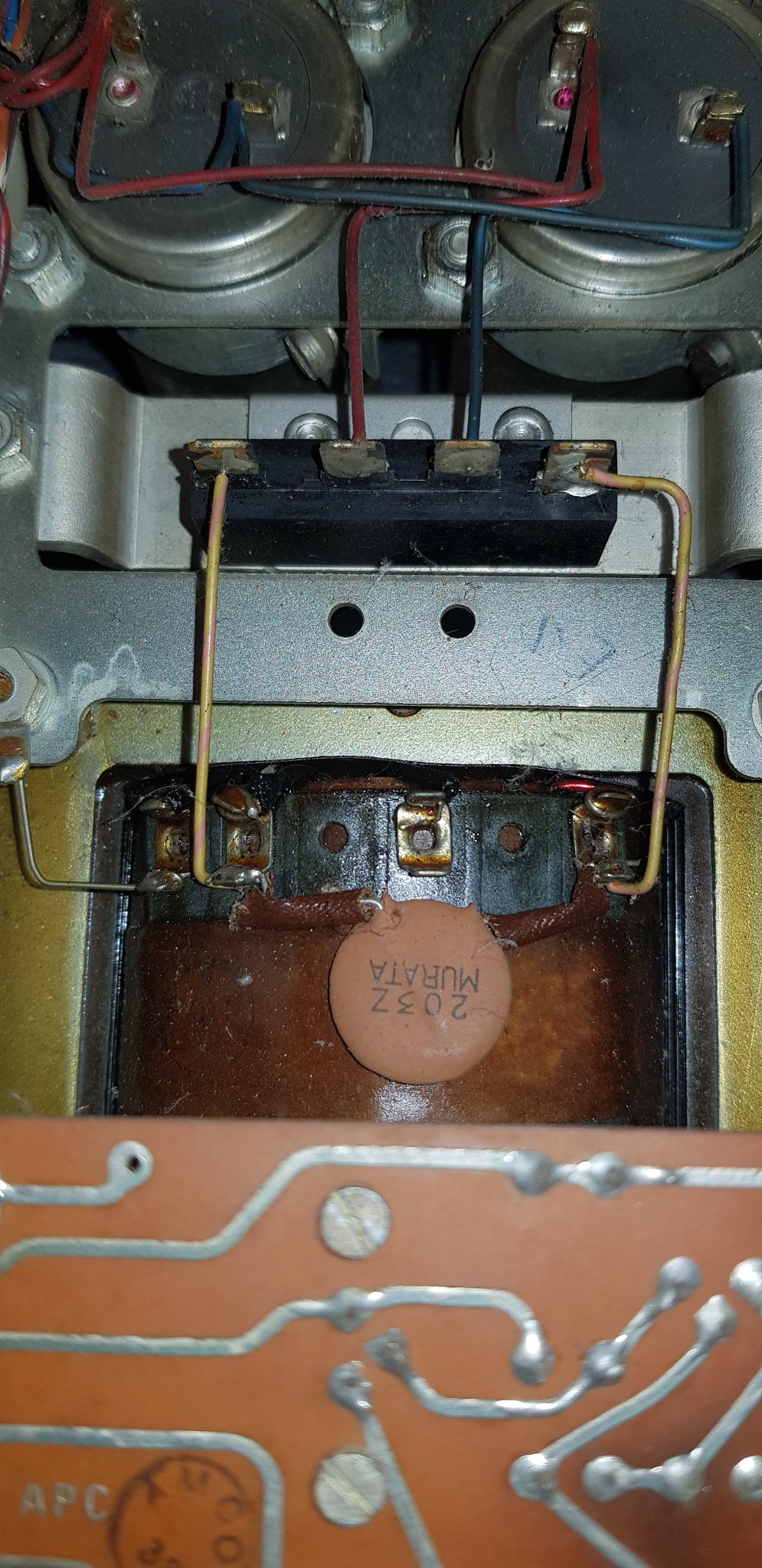

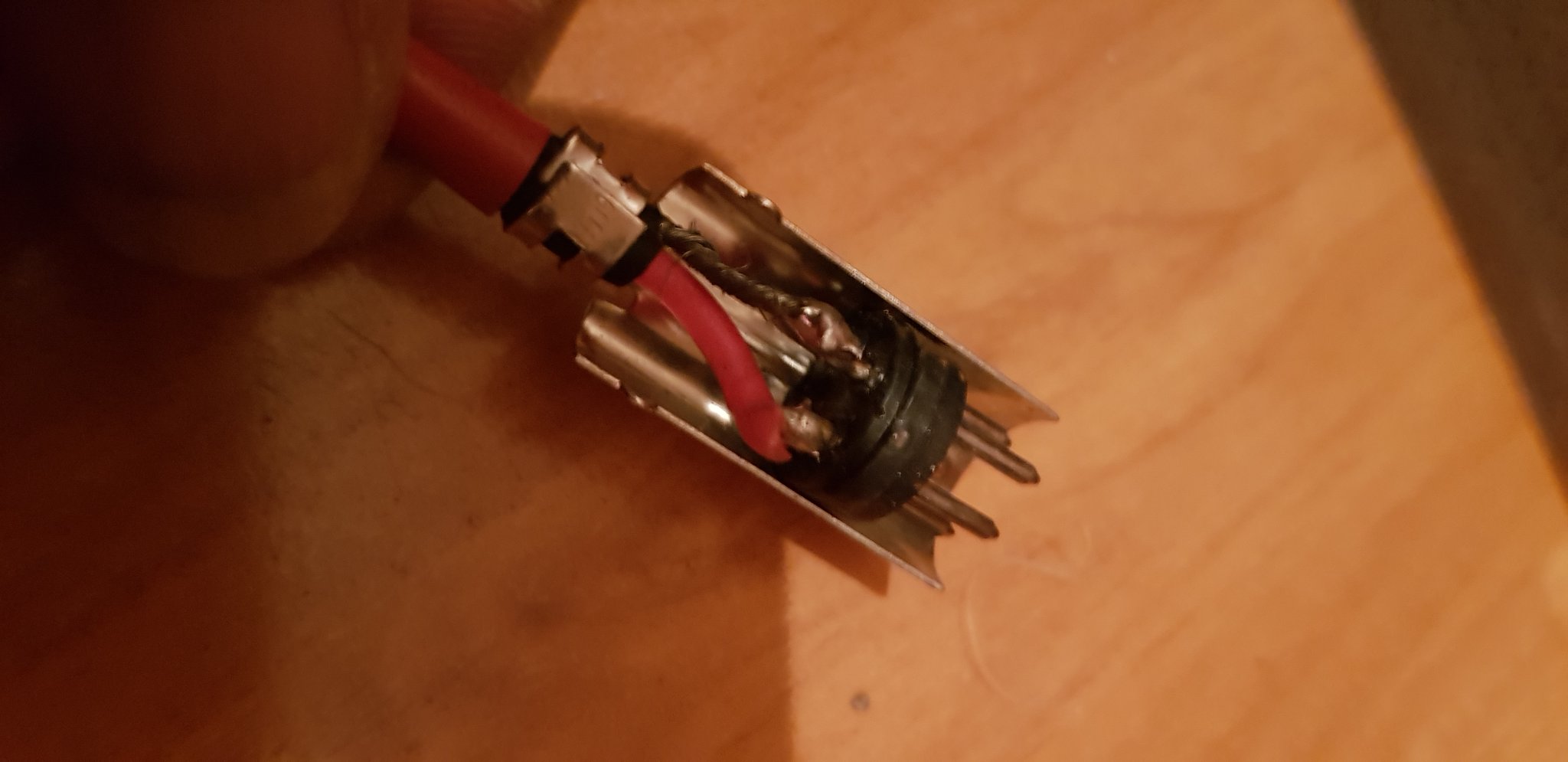

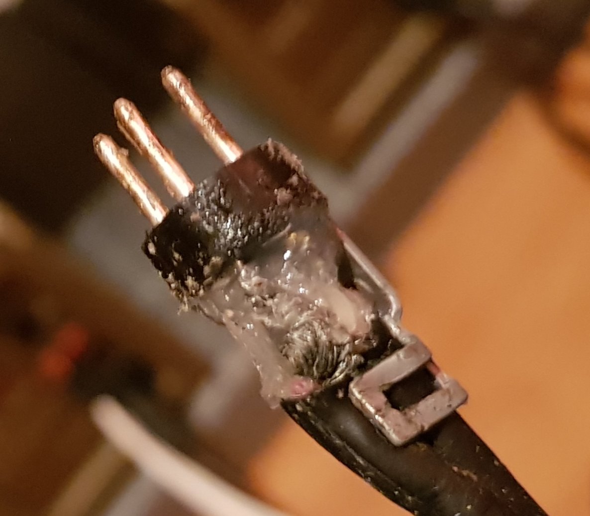

I have checked each of the quads individually and everything works. The cable that is split into 2 ways after the 33 is interesting. Looking at it the original owner has for 1 quad 303 connected only left and right for the other. I hope pictures can explain better
I think by wiring the 303's this way were not utilizing both channels of each amplifier. If one 303 was giving left from both channel's and other right from each channel then yes we have something but this looks like a waste of amplifiers power/wattage.
It would certainly appear so. Perhaps the previous owner was simply out to impress his pals with the visual appearance of his system!
What to do next?
I'd be inclined to use the 33 preamplifier with just one of the 303 power amplifiers and keep the other 303 as a spare.
I'd obviously have to construct the stereo wired DIN cable required to connect the 33 to the single 303.
Alternatively, I'd consider running the system exactly in the way the previous owner did - just for the cool factor! 😎
