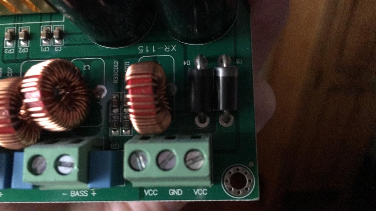

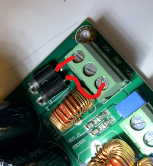

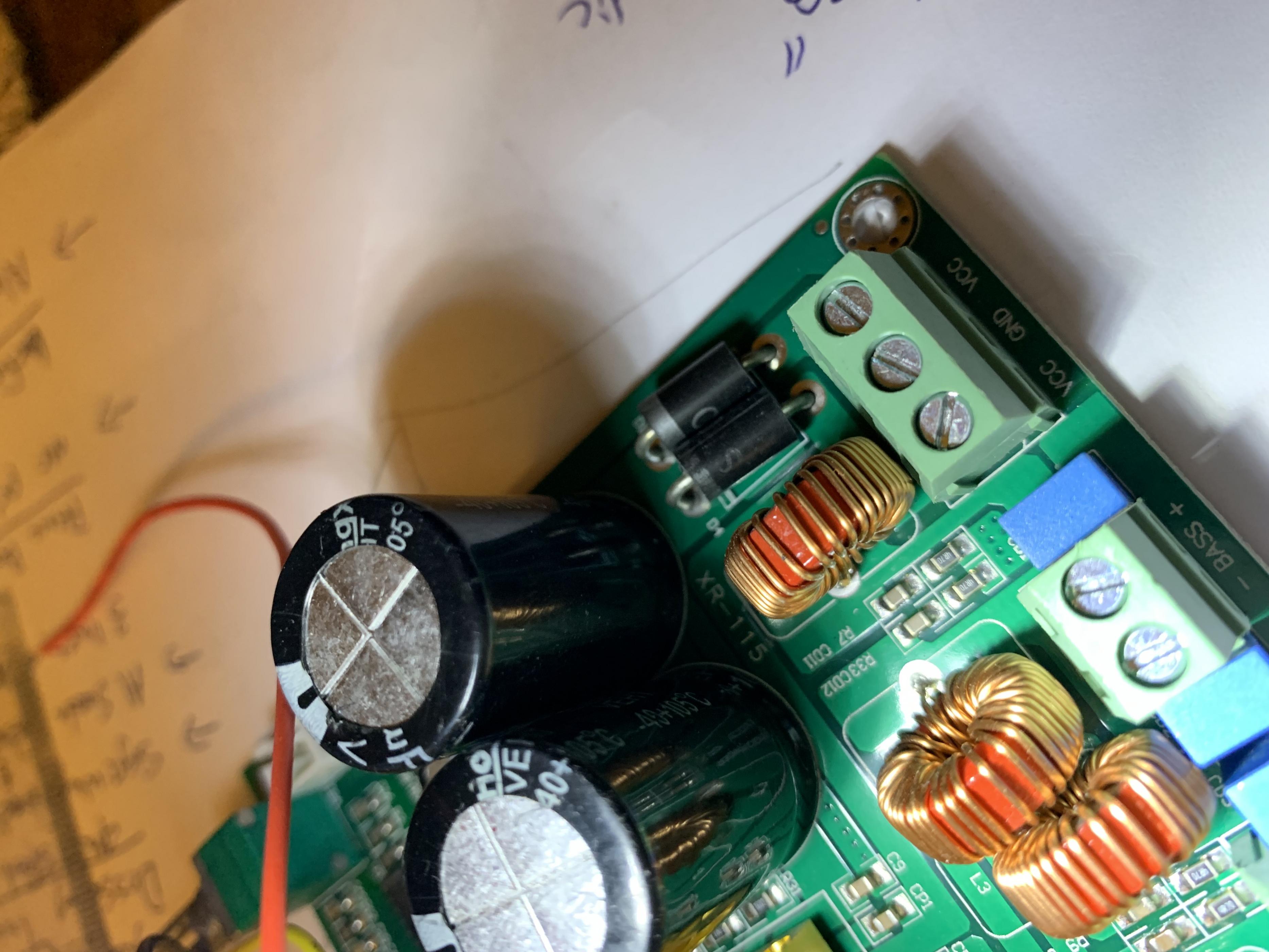

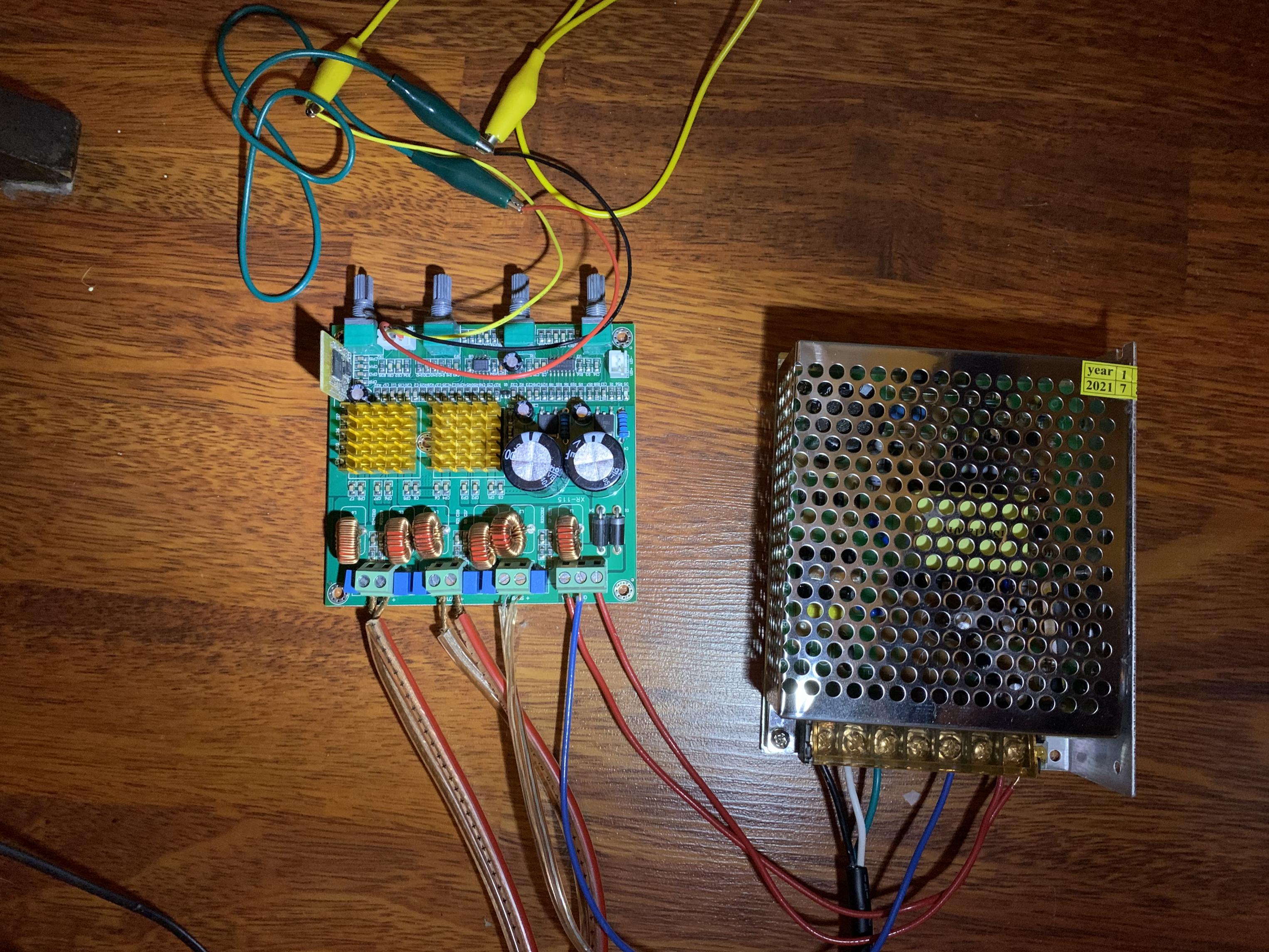

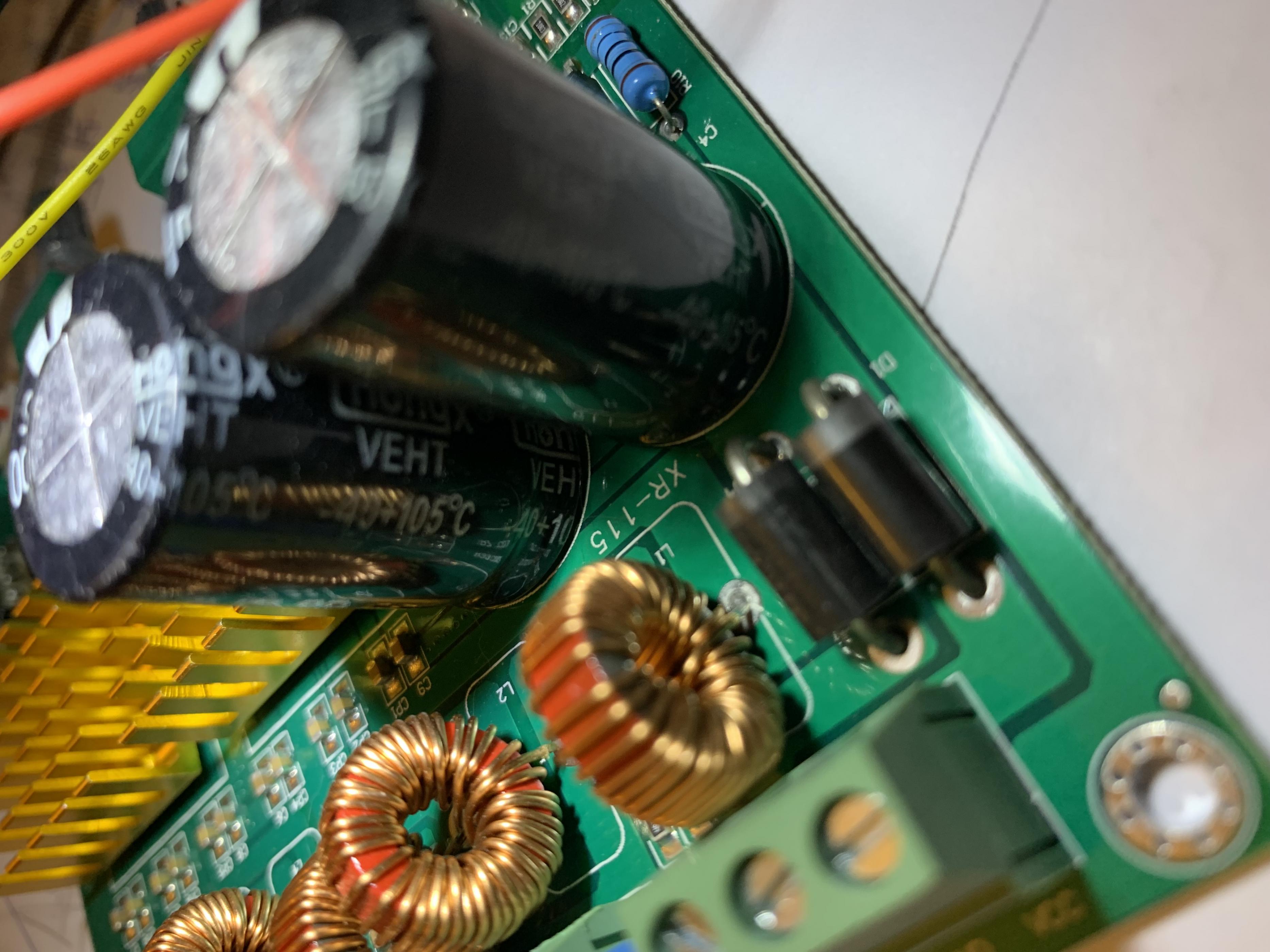

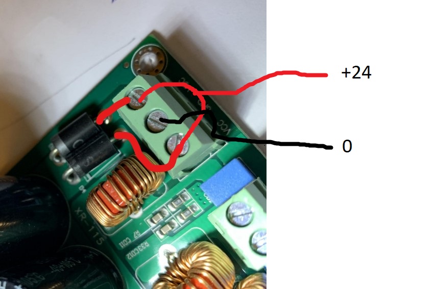

Hello, I purchased a class D amp that advertised as taking a 24VDC 10amp input. I was expecting it to come with a 2 terminal power input labelled + and - but instead it is a 3 terminal and labelled VCC GND VCC and there are no instructions. I have attached a picture below. I connected the power supply + to the left VCC and the - to the GND and it powers up and works (and is actually way more powerful then I was expecting). Unfortunately there is a lot of hiss when there is no input. I am trying to figure out what the problem is and so one option I wanted to try was replace the power supply. I do not have another 24V power supply but I do have a couple of 12V. Does anybody have a suggestion of what the purpose of the extra VCC terminal would be? Do you think this is so I could connect one 12V PS between the left VCC and GND and then a second 12V PS between the the right VCC and GND in order to get 24V?

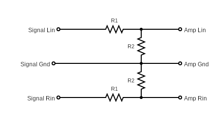

Thank you very much for all your help. The attenuator circuit worked brilliantly. With 10k and 2k2 I get a full range of the volume knob. Thanks again!
Excellent, I'm pleased it all worked out
