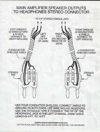

The best way to proceed is indeed to insert a resistor divider rather than just a resistor in serie. The divider will provide a low impedance output, we're not aiming for any impedance matching.
See the attached, as suggested by Grado.
As most headphones have a common ground, you must check if your amp allows this (iow, if it hasn't bridged outputs).
Reactions: androxylo
That Grado adapter (20 Ohm and 2 Ohm) is also how Rod Elliot suggests, but he gives a table of options for different amplifier power, and also an option to let the headphone see 120 Ohms rather than 2 Ohms.
I made one with 25 Ohm + 2.5 Ohm, and that 25 Ohm load gets really hot, so be conservative with the power rating there. Check for very low DC before connecting.

The Rod Elliot's article has to be nuanced.
Many high impedance headphones have big variations in impedance vs frequency and really benefit from a low impedance output (senn hd600, hd650 being good examples). But they will need a bit more than 2vrms and the second table should be recalculated for that.
Otoh, Grado for example have a fairly flat impedance and a 120r output impedance (or even more) will not be a big problem. So you could use the first table (less wasteful), but again recalculated, to give 2vrms rather than 5Vrms, which is too much.
