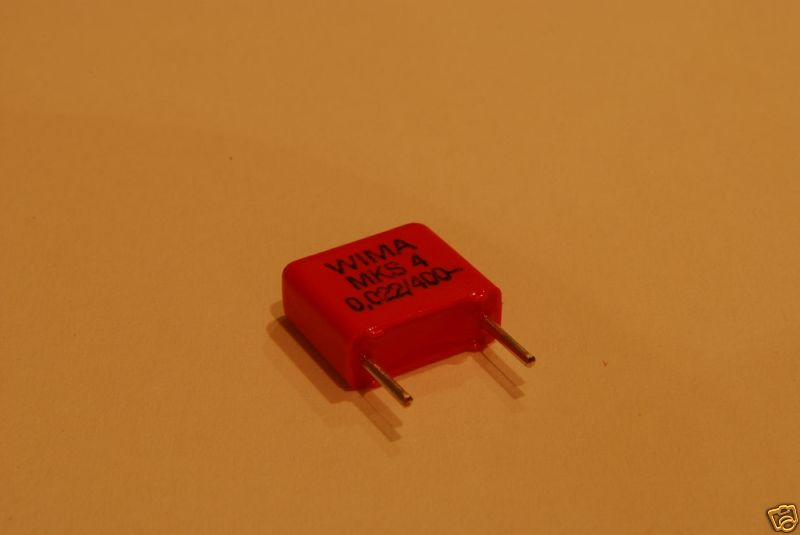

i would take vishay box caps over wima anyday, wima has the bonus of being red, which is why i think they are so popular. other nice small value film and foils (not just metalized films) are the amtrans polypropylene, evox/rifa film and foil and relcap. do not buy wima from ebay full stop; that is 100% fake in that pic. even the legit one would be polyester crap. go for polypropylene whenever size and cost allows
