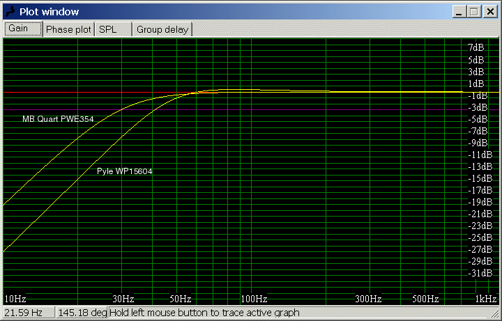

I've attached the WinISD graph. The F3 is 30Hz for the new enclosure and driver, and was around 41Hz with the old driver. Also the old driver has a bit of a peak around 80 or 90Hz (higher Qtc causing different curve).
The new driver definitely has a much better looking response to me and that's at slightly less volume than the original box.

That amount of peaking is fairly benign. The issue as I see it is that your new speaker has much lower F3. Neither Dynamat nor box stuffing will help because cabin/room gain is when the driving mode of the listening space changes from wavelength reproduction to pressure mode. However the Dynamat will help reduce vehicle resonances and will help to tighten the sound up, but it can only reduce things back to what they should be -- which will still be a peaky response where the box output is still flat and the cabin gain is coming in.
Cabin gain frequency is roughly 344 / (longest dimension in metres * 2) and rises with an approximate 12dB/oct slope in a vehicle.
