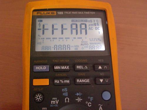

Hi Walter,
Should be an easy fix. Clean the elastomers with 99% Alcohol, and the PCB contacts. Was it dropped? It looks like the contacts are not aligned properly.
Clean the carbon connections in the elastomer very gently using a Q-tip or cotton swab. You should be able to buy replacements from Fluke in case you mess them up. Just work carefully, there is no need to scrub.

Hi Walter,
No problem at all.
You have a really nice meter there, please let us know how everything turns out. These are newer than the ones I worked on, but should be similar. The elastomer should be light gray in colour and fairly flexible. Contact is made by slight pressure from the display frame that lightly compresses the display glass (with conductive traces that are difficult to make out) towards the pads on the PCB. I'd like to know if this has changed at all. The total job should take less than 20 minutes from case off to case together, less time with practice. I hope you don't get that practice of course!

Fluke 189 Display
Chris i buy this one on Ebay 🙂 for 50Euro. The guy sale this as broken.
I normaly using 289.
regards
Walter
regards
Walter
Hi Walter,
You got an excellent deal on that! I would have bought it if it were sold closer to me.
The 289 is a bit nicer, nothing wrong with either meter from a quality perspective.
-Chris
That's great. Thank you and good luck.I will inform the Fluke repair asap.
