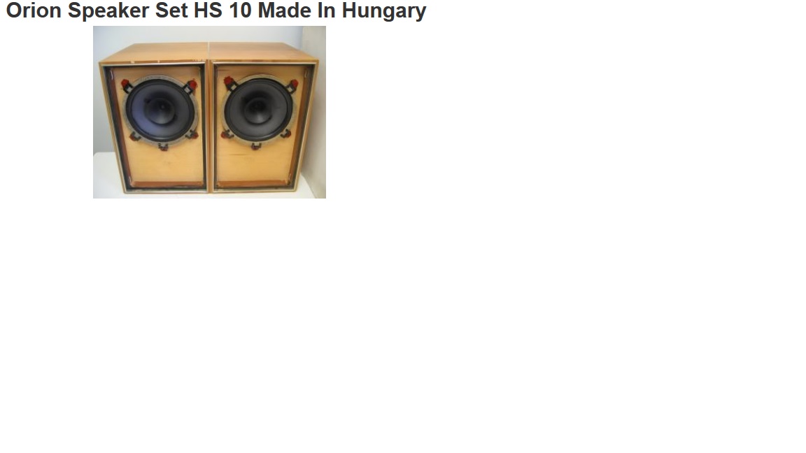

Hello,
I have a pair of Orion HS10 boxes without the speaker. How would I find the right speaker for the size of box. They are well built and would like to use them.

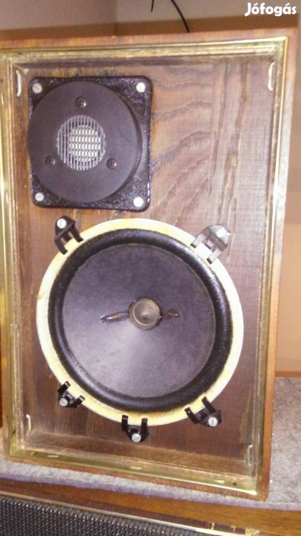

Here's a picture Dave.

Ah! Twin cone drivers!
Shouldn't be too hard to shoe in a reasonable substitute.
If you need more help, then tell us the internal volume of the box, whether it is a sealed box (no reflex port) and the diameter of the speaker aperture in the box.
I'm sure someone will be able to suggest a suitable candidate.
Oh! And the maximum that you wish to spend would be very helpful.
