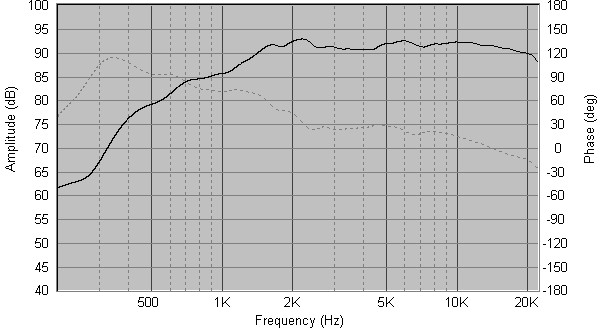

Link to measurement of the tweeter on axis at 50cm from the driver in box without filter
http://www.diyaudio.com/forums/multi-way/236392-help-3-4-way-loudspeaker-37.html#post3852282
I think you should refine your measurements. This is what I have with a different tweeter (Seas 27TBF/C), without crossover but mounted on the box:
http://www.diyaudio.com/forums/attachments/multi-way/350675d1369488525-another-6-5-1-br-design-peerless-hds-seas-prestige-s27tbfcg-baffle.jpg
Anyway, the excel tweeter (with ferrofluid) should behave not too differently, and a 2nd order electrical network at 2.5KHz should be enough to shape the response. I wouldn't use a LCR notch to tame the (non existent) resonance bump.

Zobel is to flatten the impedance after the resonant peak.If you only need to flatten the impedance on a tweeter after the resonance then you need a Zobel.
IMHO, if you learn to use a proper crossover software (Speaker Workshop or Passive Crossover Designer), you'll realize that Zobels aren't necessary.
A notch needed to eliminate a bump is quite impossible to do right without measurements.
Troels Gravesen uses LCR notches on woofers mainly to eliminate the bump in the midrange (500Hz-1Kz) due to the baffle step effect. I think it is explained on one of the recent designs (Seas Curv perhaps).
Ralf
Notch filter is to reduce the impedance at the notch frequency which is chosen to coincide with a peak in frequency response that needs attenuating.
The added resistor determines the depth of the notch to suit how big the peak is.

Excel is very different from Prestige. Don't assume anything. Now in the Prestige, between the soft, aluminum and al/mg alloy, their motors are the same so they are close.

A pasive filter will only be as good as the model predicts IF YOU ensure that what you tell the model is correct.
A single pole RC high pass filter using C in series with a constant fixed resistance will roll off at the predicted frequency and will slope down at the predicted 6dB/octave until the R or the C parasitics begin to take over and eventually dominate the filters response.
If you feed a speaker which has an effective inductance in the voice coil, you will NEVER predict the filter response with an RC filter.
The R part has ignored the speaker inductance.
You can make a better model by adding a correctly calculated Speaker Zobel to the driver to mimic a near resistive loading on the filter.
Now your model does give quite a good correlation to the real filter.
I would never try to design a passive speaker filter using a bad model.
But there again I have never designed a multiway speaker.
I have built a few from proved working designs.

Jeff Bagby's Passive Crossover Designer or PCD is a proven tool for passive xovers - as long as you enter good data taken by measuring SPL and impedance of the drivers in the cabinets you plan to use and generate .frd and .zma files to use with PCD.
