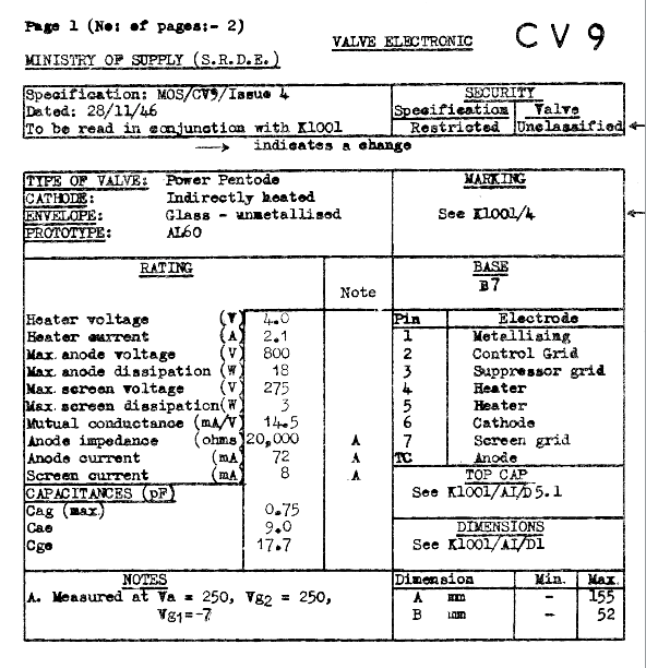

I've never read anything precise about how to calculate a safe screen grid voltage for pentodes/tetrodes in triode. Can anyone help here?
Presumably it's a question of what value screen grid resistor you use, but is it more than that?
As an example I want to know what to do with the screen grid of CV9/AL60 when triode connected. Data says max Vp = 800V, G2 = 275V.
How high a voltage could be used for this in triode and what value G2 resistor?

In a triode connected pentode g2 swings together with the anode. I think this is the reason of lower voltage spec, because the peak might go to double of the idle voltage on both electrodes. It is not about dissipation, rather internal electrode spacing. For comparison, here is the data sheet of the 807, where the max. Vp is 400 Vdc.

Hello Bela - thanks for replying. I would want to run the CV9s at between 50mA and 60mA. Say 55mA as a ballpark. The valve is rated at 18W dissipation so to reach that you would need....
360V a-k at 50mA
328V a-k at 55mA
300V a-k at 60mA
So wondering how high I can go here, since some of my SE OPTs are rated at 50mA nominal.

If the Ig2 max -for example- is 8mA (practically always lower), and total allowed current of OPT is 50mA, the approximate anode current is 42mA.
So if you biasing tube to 360V (if it good for OPT loadline), 42mA operating point, the tube within the dissipation limit.
If the overall (Ia+Ig2) current is lower than OPT max. current, can be increasing Ia (Ig2 also increasing) -with bias changing-, till the limit.

The g2 follows the plate, although often with a screen-stopper. This is how triode connected tetrode/pentodes work.I've never read anything precise about how to calculate a safe screen grid voltage for pentodes/tetrodes in triode. Can anyone help here?
Any limitations on the screen voltage will push the tube closer to pentode mode ( which by itself is not a bad thing)
If this is not acceptable you should use another tube ( KT88 is one suggestion, EL34 another). Forcing a tube way outside it's
limits is often bad.

Edit: wanting precise and safe is asking the impossible when charting unknown terriorty, but careful experimentation with the help of a variac taking care to stay within the specified G2 limits in the datasheet and using a valve which others have successfully tried is about as close as your going to get to a low risk venture. As I recall George (Tubelab) has reported in the past about testing tubes in such a way to destruction which came soon or after a somewhat limited life. The internal construction will make a difference and that's rather hard to measure without smashing the tube and doing far to much maths.

You simply obey the screen voltage and following the current rating of your output transformer and the rest will fall into place, even at the expense of lower plate dissipation than desired. High screen voltage is often the cause of shortened tube life, especially in UL designs pushing for high power. Go conservative here.
