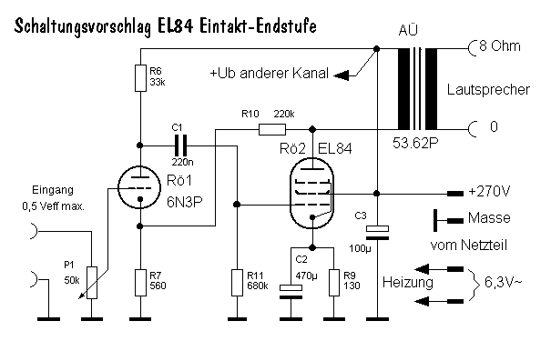

For example, if the shunt feedback resistor is 100k, and it feeds back to a node that varies 1V, and if the gain at the output plate gives 100V, we have 100V + 1V, and that is 1.01mA through the 100k.
It loads the output plate with 101k, it is not 100k/gain 100. The load is not 1k.
Did I miss something?
The shunt feedback resistor works like Miller capacitance, because the anode side is actively driven, not grounded. For extreme example, like an inverting op-amp stage, the G1 side approaches zero impedance.
Or, it could be thought of as the opposite polarity of boot-strapping.
All good fortune,
Chris
A 100k resistor that is swinging with the output tube's plate, and the other end of the 100k resistor is at a Zero node, it is still a 100k resistor.
If the plate swings 100V, and the other end of the 100k does not move, there is a change of current of 1mA.
Actually, the "zero node" has to move 1V, or the output will not move 100V (if the gain is 100).
You said the feedback resistor resistance is effectively divided by the circuit gain.
So, for a gain of 100, the 100k would effectively become 1k. That is not possible.

Chris Hornbeck,
You are correct, the 100k looks like 1k at the Zero Node.
We were talking about different points in the circuit.
Given a gain of 100 . . .
The output stage plate 'sees' 100k. It moves 100V
The driver stage plate 'sees' 1k. It moves 1V
In both cases, both ends of the 100k current changes 1.01mA.
You were talking about the zero node.
I was talking about the output tube plate that sees the OPT primary in parallel with 100k.
The 100k does not 'become' 1k at the output tube plate.
The only plate that becomes heavily loaded is the driver plate.

There's no issue with speaker impedance, and as always, negative voltage feedback (as long as it's negative) taken from an output improves an amplifier's performance into *any* load.
Rather, a potential issue arises with shunt feedback when the feedback is returned into the working loadline of the driving valve, especially a triode, whose distortion increases with decreasing load impedance, universally and monotonically.
It is certainly possible to graft a shunt feedback around the output valve of an otherwise conventional amplifier, but it's not trivial. The driving valve is tasked with supplying current into the fedback node in amounts much, much larger than would otherwise apply. Bringing the feedback a little further back, to the cathode of the driver valve, removes this potential issue at very small cost to stability, but isn't fashionable.
All good fortune,
Chris
Hi Chris,
I think it's been done before, something like this drawing EL84 with driver tube ecc88 or ecc85?
Yes, that's an excellent example. A type ECC83/12AX7 driver, although amazingly linear, would potentially benefit even more due to its lower Gm and perveance.

To wander reluctantly back to the OP's question: your approach to design here might best be to find an optimum balance between the advantages of lowering output stage distortion, output transformer distortion (through lowered driving impedance), and speaker damping (maybe better thought of as immunity to impedance variations - but the same number) vs. increasing distortion and lowered slewing ability in the driver stage. You'll want to start thinking of the driver stage in power delivery terms. Not at all challenging, but different than our usual approach.
Conventional designs (meaning those that don't significantly effect loadlines) all have a longer feedback path. This can be made a liability or an asset, depending on design. But even very short feedback paths, like a cathode follower, can have stability or linearity issues if abused (and they often are). Beware of gurus.
I hope that the take-away from this discussion is that the "Rfb" needs to be treated as we would treat Cgp for Miller capacitance - input impedance (at the output valve's grid) is reduced by the factor A+1.
