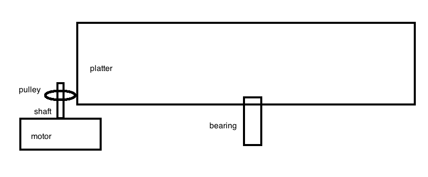

I understand. My initial description also lacked pertinent details regarding what I have in mind. There will be no spring mechanism involved. Rather, the drive wheel--housed in an enclosure separate from the platter--will be pressed against the side of the platter. Examples of this type can be found in the Teres Verus system, VPI rim drive, and others.

How much of a push does the turntable need?
Unless the bearings are bad, very little.
Imagine tying a fish-scale to a string around the rim, and run away at a speed which results in 33RPM. It may take a good pull to get it up to 33. But that is very short-term, and the motor side-force rating is about long-term wearout, it will stand much more for a second or two.
I'm going to guess that platter, disk, and needle altogether "could" need an ounce of force at the rim to maintain 33RPM.
If coefficient of friction was 1.0, you would need >1oz of force on the contact point. Rubber tends to be CoF near unity, but a highly polished rim might need more. So say >1oz. What is that in Newtons? Maybe 0.6?

I am not sure I understand your question completely. Some rim drive systems use gravity by leaning the shaft/pulley against the platter. Teres Verus and Transfi are examples of this. Systems by VPI and TT Weights seem to couple the pulley without leaning it, leaving the motor shaft parallel to the platter bearing.
I have to experiment with this yet, but I imagine it requires a force similar to that needed to place proper tension on a belt.
It may be counter intuitive but contact area is not necessarily part of the equation. IIRC normal force multiplied by the coefficient of friction gives the driving force. It has been many years since statics so I might be mis-remembering....How much more force does a rim drive require to couple to the platter than a belt drive due to reduced contact patch?
If you arrange the motor on a swinging arm in the right orientation, the driving force will generate the contact pressure and the greater the resistance to turning, the greater the contact pressure. Arrange the arm in a different orientation and the reverse would happen so a jammed turntable would cause the drive to slip.
