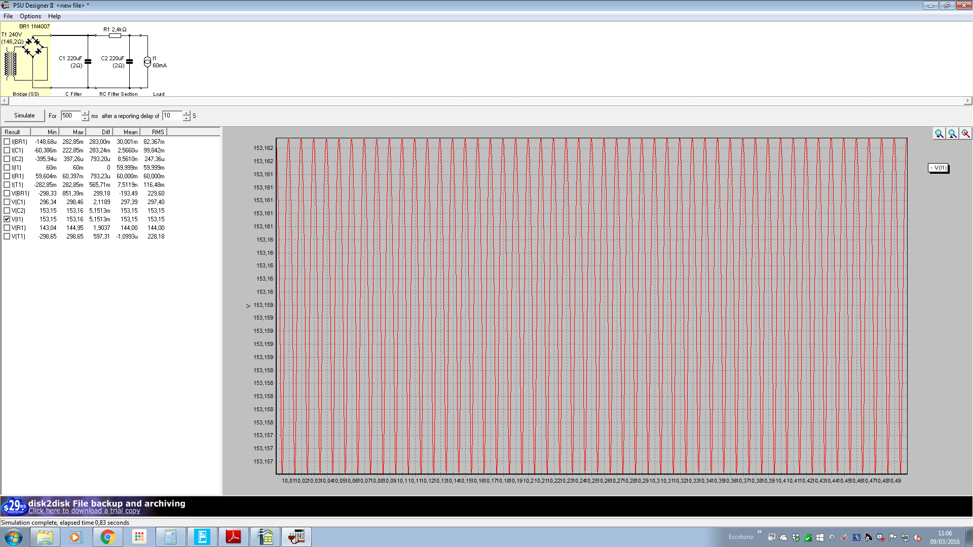

I simulated with PSUDII and I guess I can use it for 4P1L preamp using Ale Moglia gyrator, attached simulation done.
