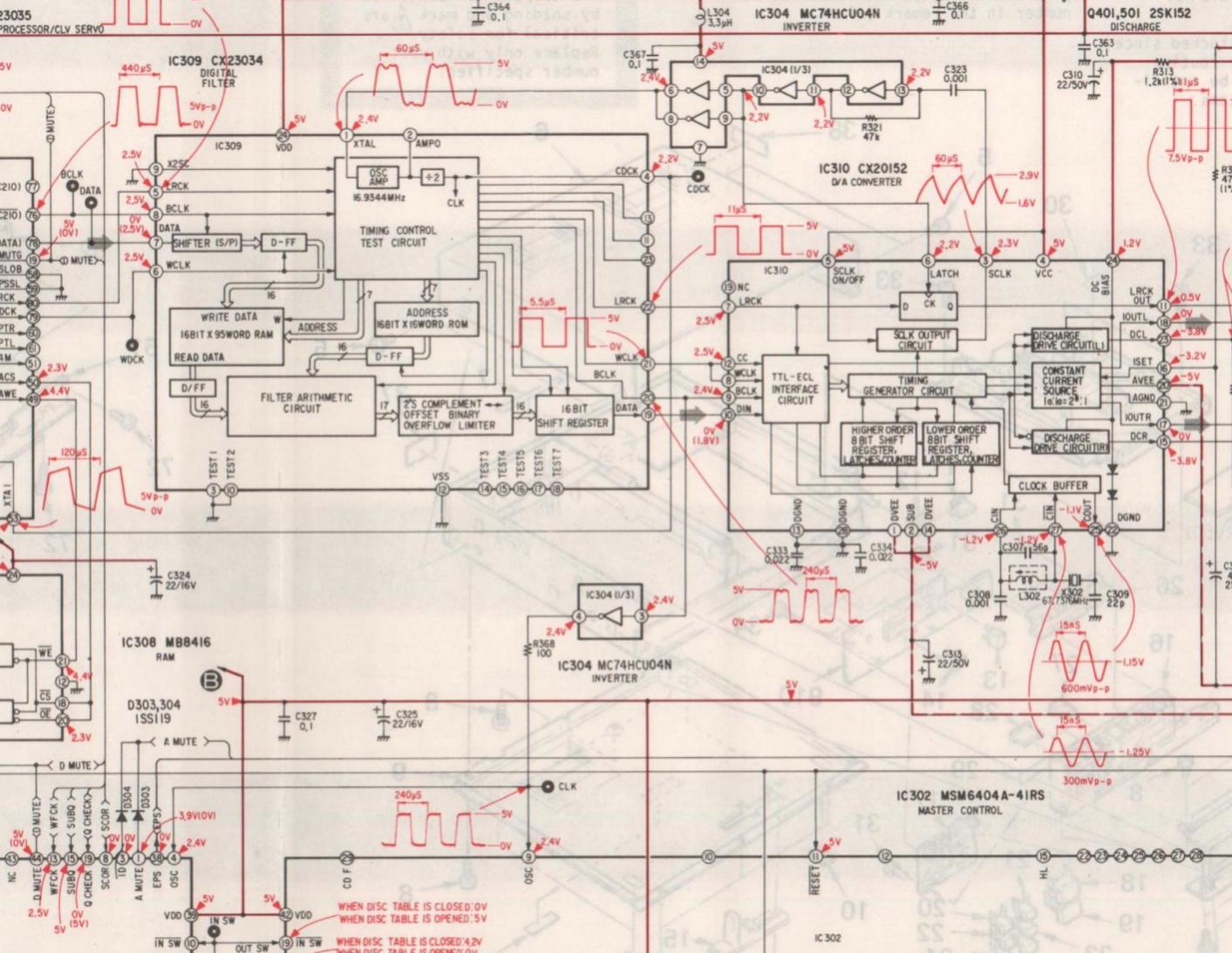

Which frequency has the bitclock ?
Salar
From the datasheet.
LRCK Fs 44K1
WCLK 2Fs 88K2
BCLK 48Fs 2M116800
