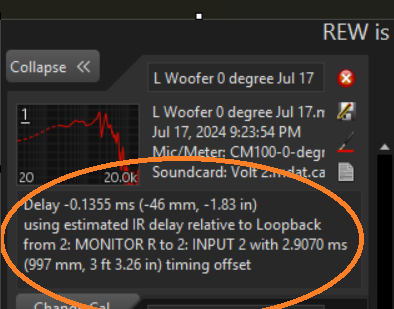

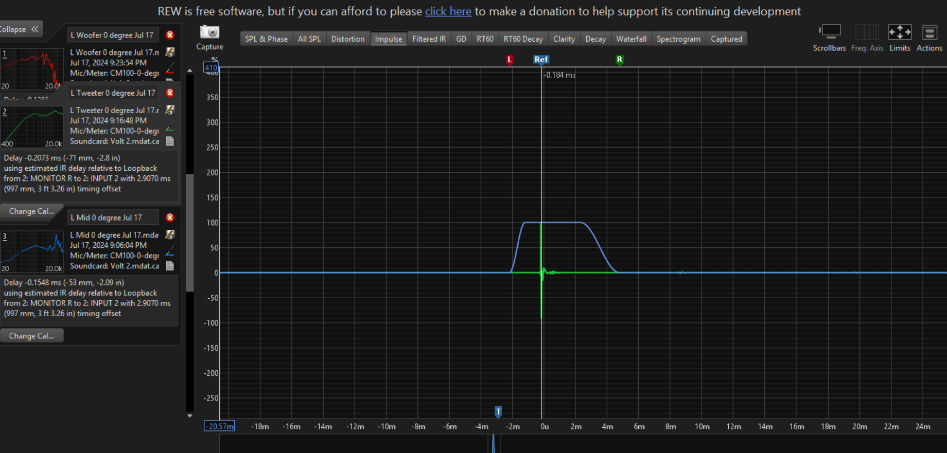

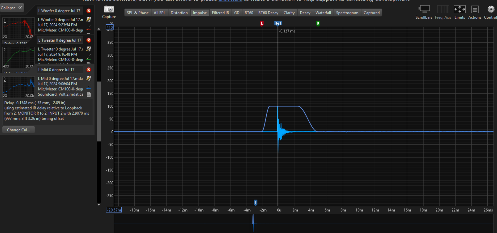

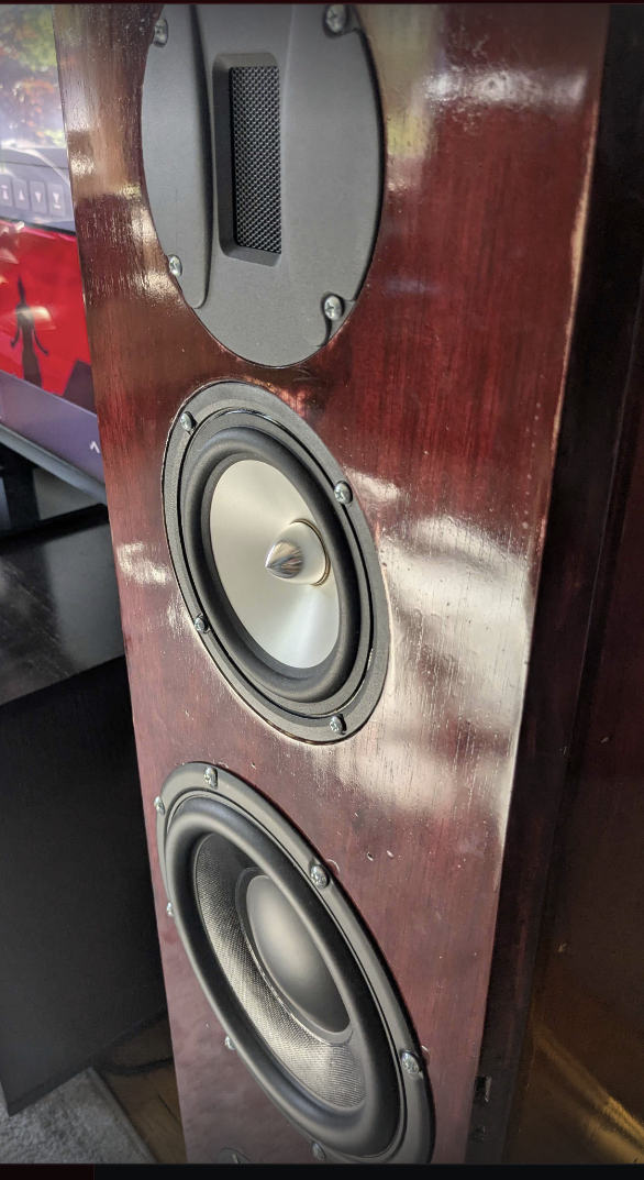

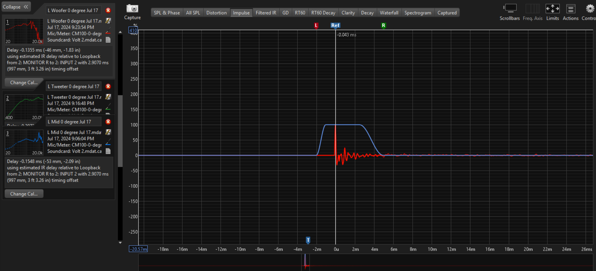

To be honest, I don't really understand the intention of the question. Should the acoustic offset of the drivers be corrected mechanically? I would prefer a pure phase adjustment, because steps and edges on the baffle are not exactly advantageous from an acoustic point of view.
Or you could develop an active crossover and then adjust the offset using delay.
I'm a bit puzzle on this phase adjustment or delay on active crossover. I agree it works correctly on axis.
But it adds delay also off axis where it should probably not be added.
We can clearly see on the pic that that at 90 it is already align (I never done the exercise to make a measurment taught)
I fully agree that it is better to time align on axis rather than 90deg
But it's not obvious that making a steped baffle is worse than having off axis to be not time align ...
By the way, having a Umik all those questions of phase and time alignment bother me.
Jeff bagby method works quite well on axis. But when it comes to take off-axis measurement I'm not sure to do it correctly ...
And I even don't know if we NEED to make measurement mooving mic on Y axis to always be at driver hight. Or we just can keep it at same height. (especially for vertical measurement) ?
