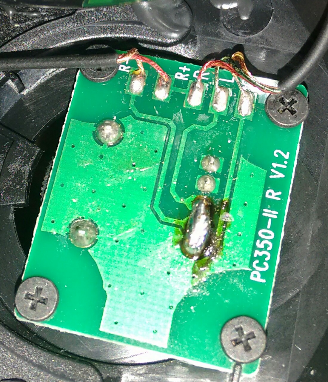

Thanks a lot for this thread, it helped me a lot figuring out the fix I needed on mine. Here's my contribution to it 😉
So I had to do this mod on my PC360 (bought in december 2016)(hm, I just realized I still had a couple of months of warranty, but having to wait for the thing to RMA back, get approved or denied, then finally get a pair back is not something I would enjoy anyway).

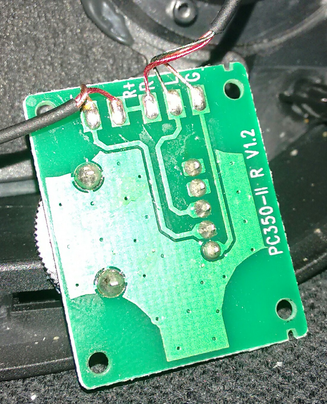

The PCB version is the following: PC-350-II v1.2.
I only had to make a solder bridge covering the Left (L marking), Ground (G marking) and Right (R- marking) wires. The sound is clear and volume is finally balanced between the Left and Right drivers, the microphone still works flawlessly.

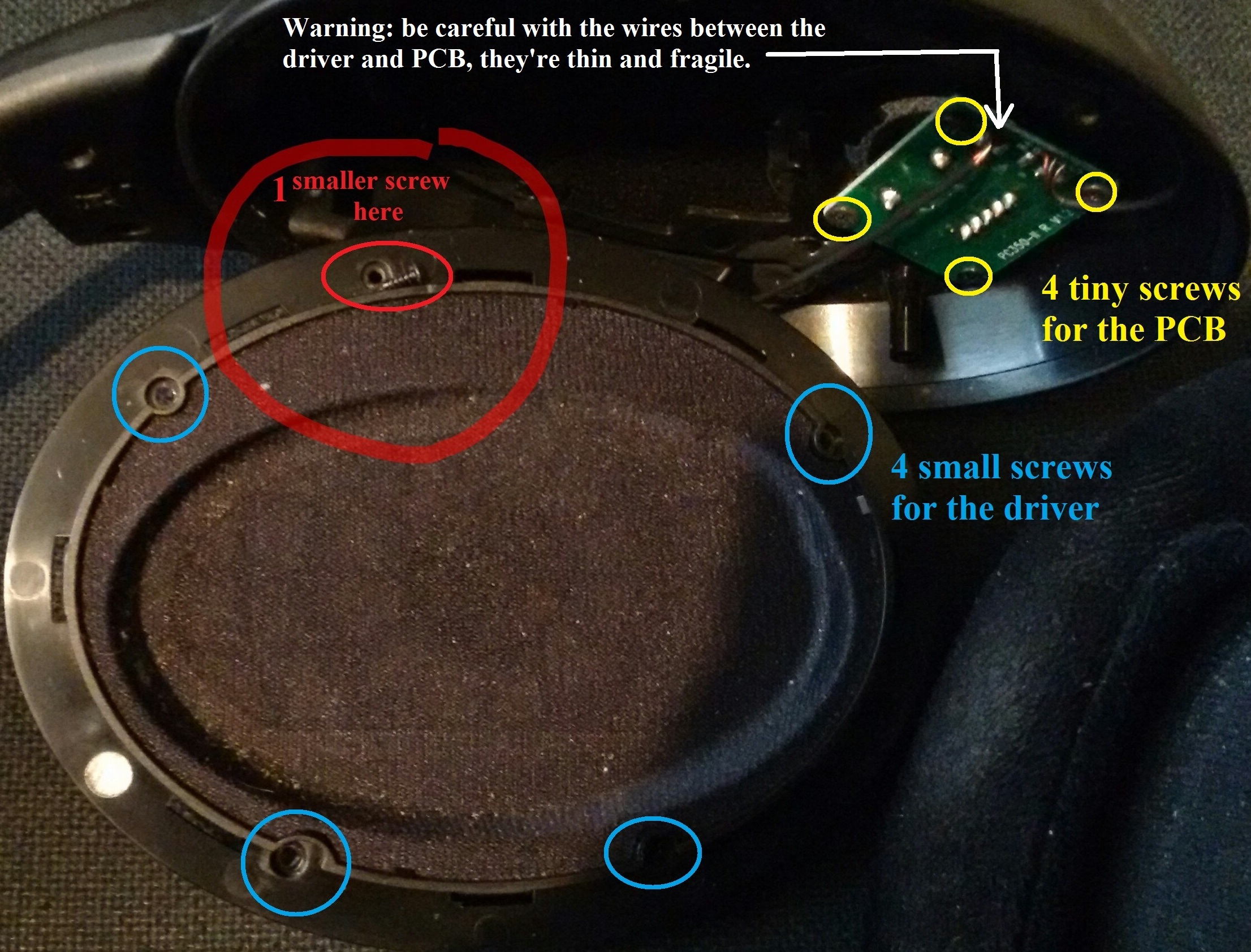

(1) Removing the driver to access the PCB (warning: don't pull on it too hard, the soldered-in wire is thin and short!):
(2) The original PCB (notice the marking up there: R-, R+ R, L, G):
(3) The bypassed PCB (the brown/dark trace is just the flux I used):
Reminders:
- to remove the earpads, simply pull on them while holding them closer to the plastic housing. They should come off relatively easily.
- as seen on the first picture, there is 4 small screw (blue circles) and 1 smaller crew (red circle) for the driver assembly.
- once the driver is ready to be removed from the earcup plastic housing, do it gently and do not pull it away. The wire between the driver and the PCB is rather short and thin, so it might break if you are not careful and methodical in how you place each element on your table.
- when separating the driver and the housing, a small rubber bumper might fall off. Do not panic, it is simply located at the top of the housing in a tiny hole: it prevents the earcup from hitting/grinding against the earcup bracket.
- to have a better access to the PCB (to solder the 3 legs R-, L, G), you might need to remove the 4 tiny screws holding the PCB to the plastic housing. Once it is done, be extra careful about your movements and where you place each element (driver, PCB, rest of the headset), since there is now 5 thin wires to watch.
- you do not need to add that much solder, since the 3 legs are very close together. Make sure your soldering properly cover the 3 legs down to the PCB, and isn't just a solder ball (or a grain of rice) hanging off the tip of the legs.
- before assembling it back together, test if the sound is free of statics and if both drivers are emitting the same amount of sound.

PS: if your PCB is different from the v1.0 previously posted, or the v1.2 detailed in my post, then draw your PCB layout on a piece of paper, to see which wire is already linked (on mine: +) and which one goes through the potentiometer (on mine: - and Ground).
Then, turn your potentiometer wheel to the lowest volume position, play some music on the device (computer/mp3 player) a little loud (if the volume knob was not at its lowest volume position), then see what happens when you short (= connect two separate legs) the wires you suspect of being the ones controlled by the pot (on mine: G and L/R). To do that, a small wire or a paper clip can be used.
Whenever a driver produces loud sound, it means we just found one of the two pairs of legs that needs to be soldered together.

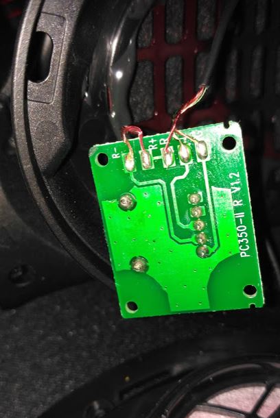

Thanks much! I have had Sennheiser G4ME ONES for a few years (since before they changed the "4" to an "A").
I've been unable to trust them for the past few months because of channel imbalance, so I finally decided to pop them open today. The integrated volume potentiometer has been getting shifty and I can force it to regain balance by maxing the volume and tapping on the side a bit... but that's dumb.
They have the very same PCB as yours: PC-350-II v1.2
I grabbed a thin pre-soldered wire (lovely stuff I use for guitar pedals from GuitarPCB) and the soldering iron, bridged those same 3 legs together, and now I have perfect channel balance.
Thanks!
Update: I also checked out my Sennheiser G4ME ZERO headset, and it also uses the PC-350-II v.1.2 PCB for its potentiometer control. I went ahead and soldered that one to be a fixed volume as well.
