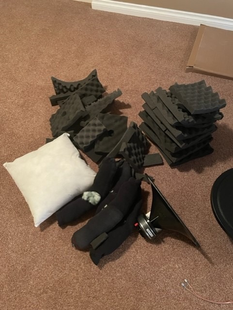

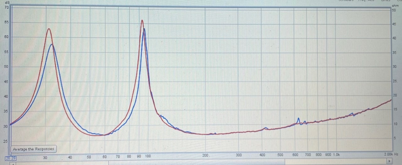

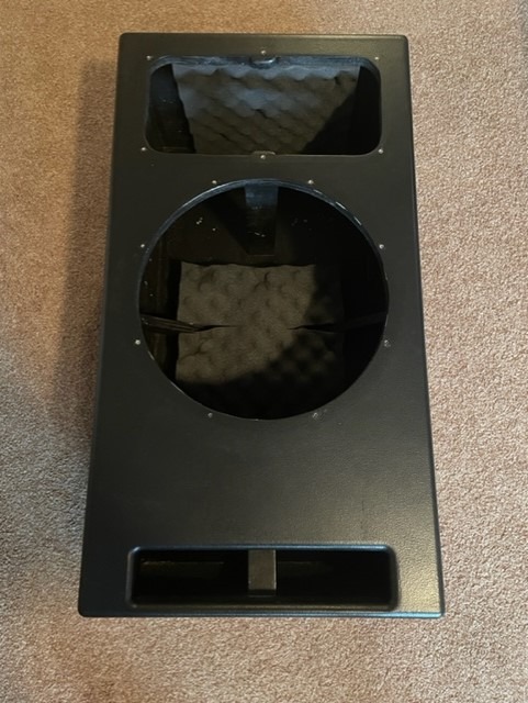

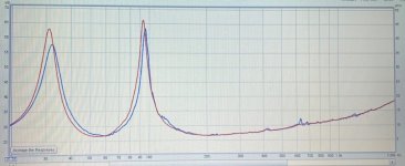

I have been experimenting with different fill/stuffing/lining of a 2 way BR cab. Based on lots of impedance sweeps of different configurations I've come to my own conclusion that it is impossible to kill all the resonances while also retaining the full performance of the port. An empty cab has the best bass performance, and a totally filled cab has the least resonance. Finding the best compromise was interesting. Placing acoustic foam and poly stuffing in different places in the cab and different amounts and thicknesses all have very real implications. Adding more fill material in some cases made the resonance worse depending on where it was placed. My current leader in the house is a single acoustic foam pad covering the top panel of the cab, and two stacked foam pads directly behind the driver but not reaching out to the edges. Nothing on the left and right sides or anywhere near the port. It is much less fill than I had thought was needed, but measurements say otherwise.
I don't want to get too far involved as I don't have time today, but re the above: damping material is at its most effective at Vmax (i.e. the point of maximum air-particle velocity), and least effective where pressure high and air velocity low. That isn't always practical for various physical reasons (vent, bracing, duct or driver position etc.) but any point where velocity is high is usually a good starting point. In practice though, for most vented boxes of decent proportions, you should be fine lagging non-opposing faces with OC-703 or an equivalent, & making what adjustments you want via the old click test, unless you are using the damping to help achieve a particular alignment. In general, I avoid acoustic foam -there are some good examples, but most is mediocre - poor.
