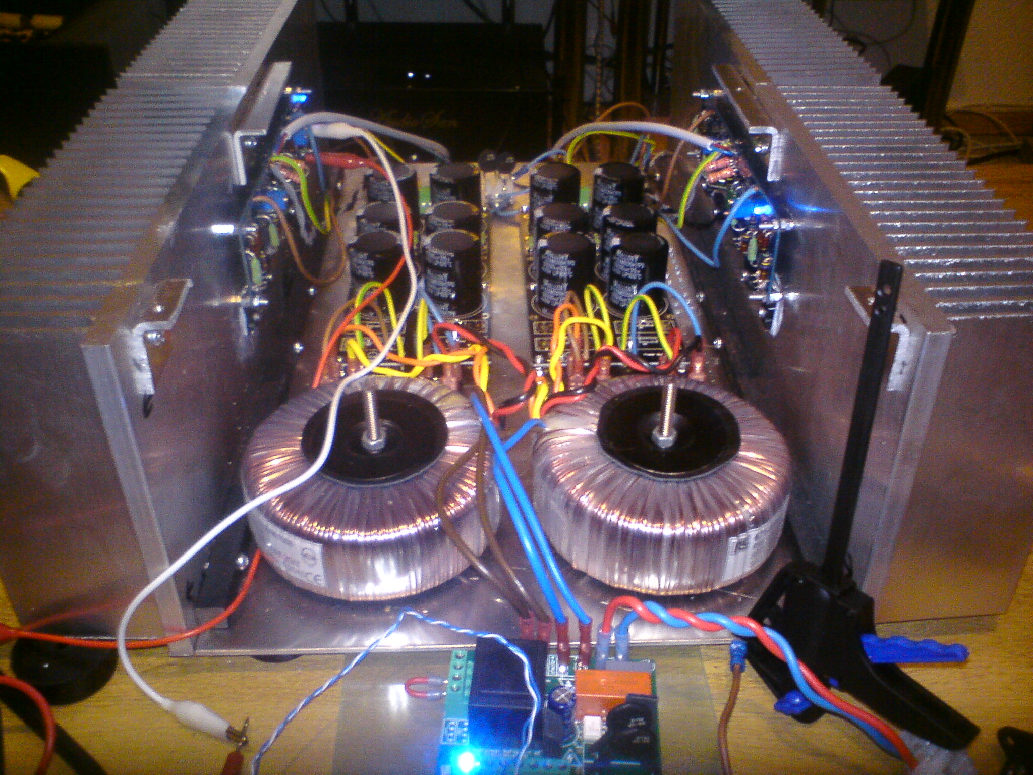

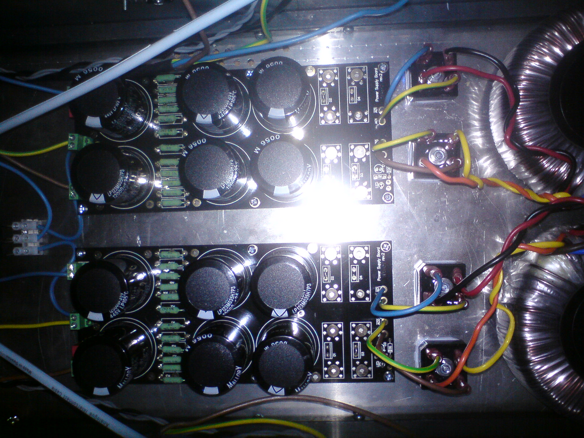

You do not have to change anything...
For a dual mono arrangement, I recommend that each transformer feeds a dual bridge rectifier and that each channel have it's own quite separate Main Audio Ground (MAG).
Then after testing each channel individually, you work out how to connect your two MAGs to the Chassis to make your amplifier user safe.

that looks like 4 diodes feeding the cap bank. 4 diodes = 1 bridge rectifier.
Are there 8 diodes in there that I can't see?
Dual rectifier for a dual mono needs 16 diodes, i.e. 4 bridge rectifiers.

Ah, that must be the gaggle of wires going into the hidden gems behind the transformers !
Can you show the grounding schematic for the dual mono? Or is it already posted?
