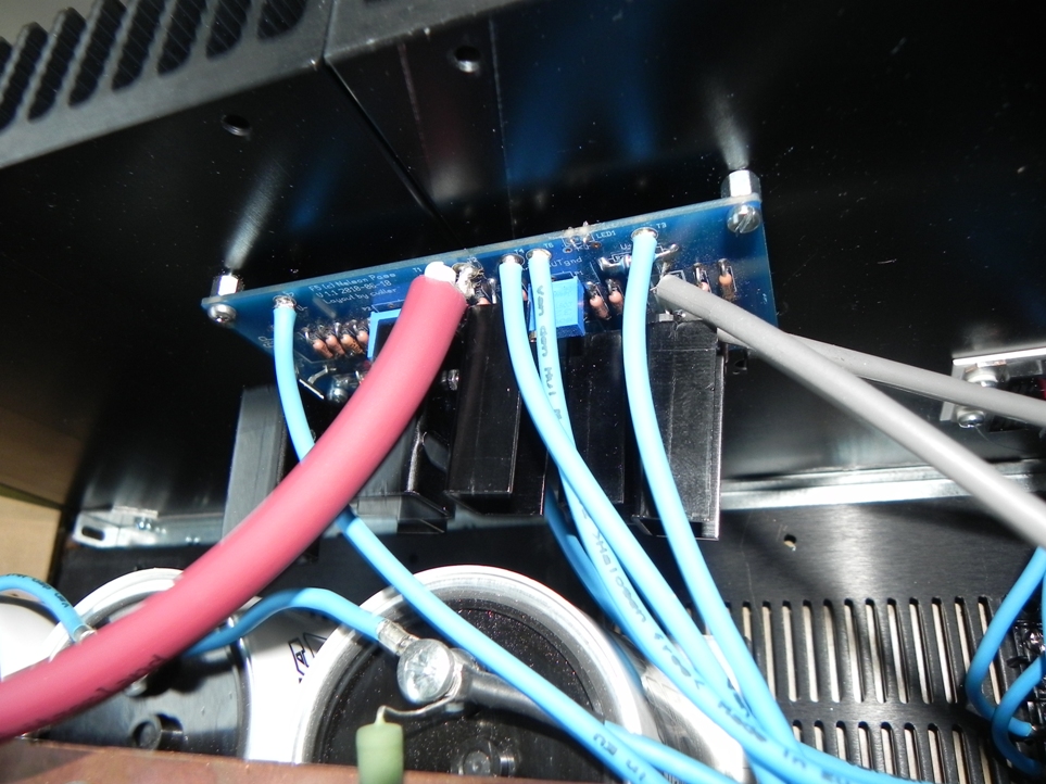

I finally powered up the 1st channel. Hmm... no smoke, the light bulb
in the hot line turns on and fades out but the LED on the amp pcb fades out as well. 😕
Actually the LED should be always on but it's not. PSU voltage is fine @ 24.4V
When I turn off the amp (discharge the caps) and fire it up again the LED is not on at all, even not for a second.
I turned P1 / P2 down to zero just before firing it up the 1st time. When I now start to turn on P1 I get at max 0.02V over R11. So something is happening but not quite properly. The heatsink doesn't get warm at all...😕
Is the LED damaged and shorts now V+ to gnd? Will check this tomorrow...
Any suggestion?

But on the pictures attached there is imo nothing to discover but please feel free!
I've asked the question because it could be the case that somebody experienced similar behaviour and could probably give me some hints. I mean what is a max volatge of 0.02V across R11 indicating. Obviously Q3 is not raming up very well. 😕
Who can help to localize or to isolate the error on y pcb?
Thanks in advance !!!!!

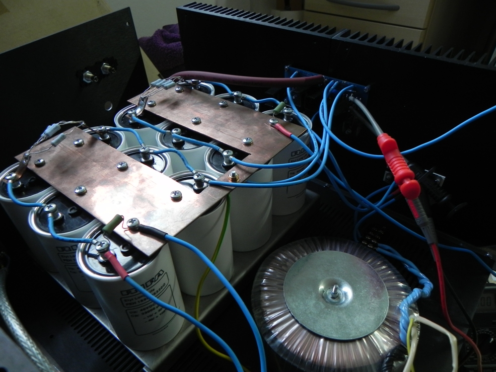

Q : The copper plate at the power supply is treated or is it bare metal ?
It's bare copper/metal.
Better to solder some tin around the mounting hole area, both sides.
(bare copper and sulphur in the air are not a happy couple)

Playing Mr. Obvious here for a minute, but you don't actually state that you took out the light bulb TESTER....?Hi,

Also, how can you NOT create mass-confusion with all the same color wires? Help yourself out a little....
I've done it with an without the light bulb with the same result.
+- 24.4V coming out of my PSU and into the amp in both ways.
I know, all the cable with the same color is bit difficult to handle but I'm
100% sure there is no cabling error.
