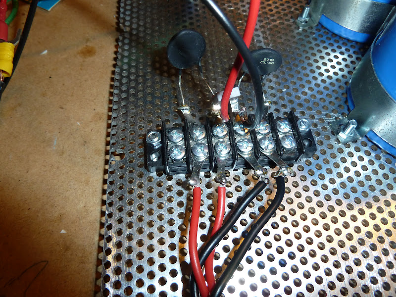

One more question did you Ken / 6L6 mannage to get a temperature on the CL60
Using the extremely accurate pseudo-pscientific method of touching them and guessing, I would say that mine are in the neighborhood of 120-130F. (49-55C)
Very warm/hot to the touch, but not going to burn you, and able to touch for 5-10sec.

Question
your therminal block is rated at 80 C ?
May get britle 6 months down the line.

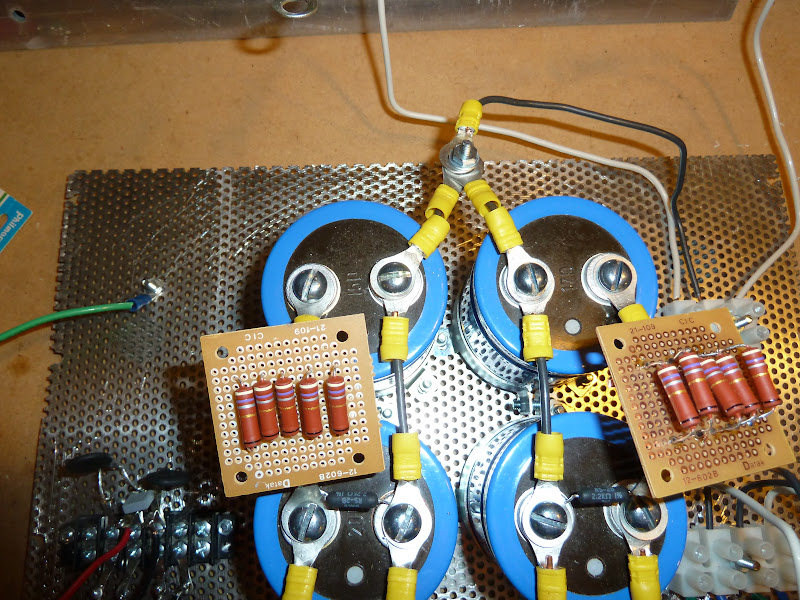

I get a little over 16vac with a bulb which does dim over time. Then I only get 0.6vdc at the caps
Please verify if the caps are orientated as I labeled them.
Also, are the V+ and V- labeled correctly?
Are the green wires from the rectifier blocks to the screw terminals DC positive?
That is correct. Green in positive. The caps are correct also and I have had a second set of ee eyes verify.

Mine are running about the same--warm to the touch, for the two CL-60's on the line side. The CL-60 common to the PSU is running a little cooler. All this, with about 0.63v across R11 and R12, for each channel.
I'd recommend you disconnect your leads from the bridge rectifier outputs, and measure both the VAC into each bridge, and then the VDC (unfiltered) comming out of each bridge.
While you have those leads "open" I'd also measure the resistance across the caps for each rail (do that using the leads you disconnected from the rectifiers. (You may have some residual DC in the caps, to touch both leads together to ground the caps, before you take this resistance reading).
Is your power supply currently (no pun intended....) connected to either/both of the amp boards?
It's not connected to the amp boards. I will check out what you said.
Thanks....that may be the best way to proceed--peeling back the layers of the onion, etc.
From a scan of your pics, your wiring on the primary side of the transformer looked ok.
On other simple measurement--the resistance reading across the two AC line leads (coming into the amp chassis) should be about 6-7 ohms (for a 400 VA transformer).
Are you sure each of the two secondary windings has one blue AND one green wire? (and how do you know which is which?) Have you tried with only one secondary at a time?
