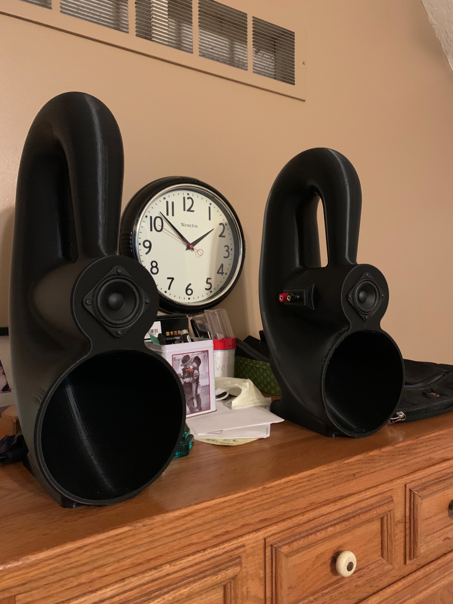

How about 3d printed mini BLH with 2 inch driver, maybe too big for desktop. Just a suggestion.Dear Gurus! Suppose I should not spend on the MonAcoustic SuperMon Mini (because it's kinda expensive) and instead I want to build something in the same category/class myself: the ultimate passive desktop monitor for audiophile classical/instrumental/acoustics playing at low volume with high fidelity.

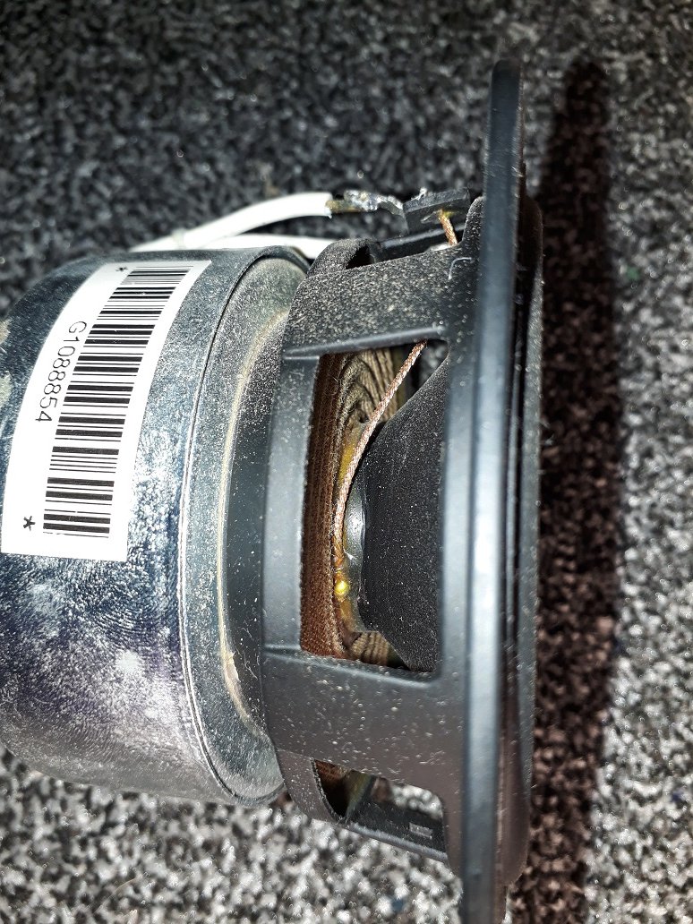

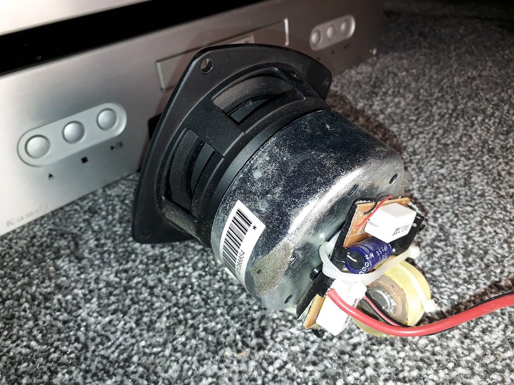

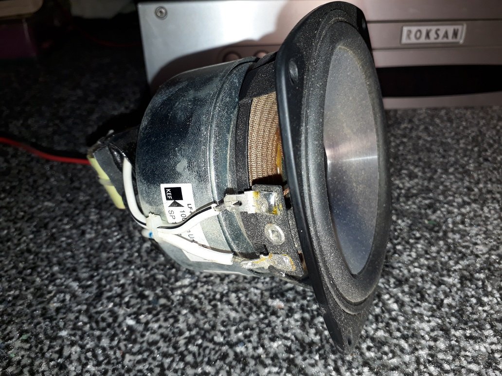

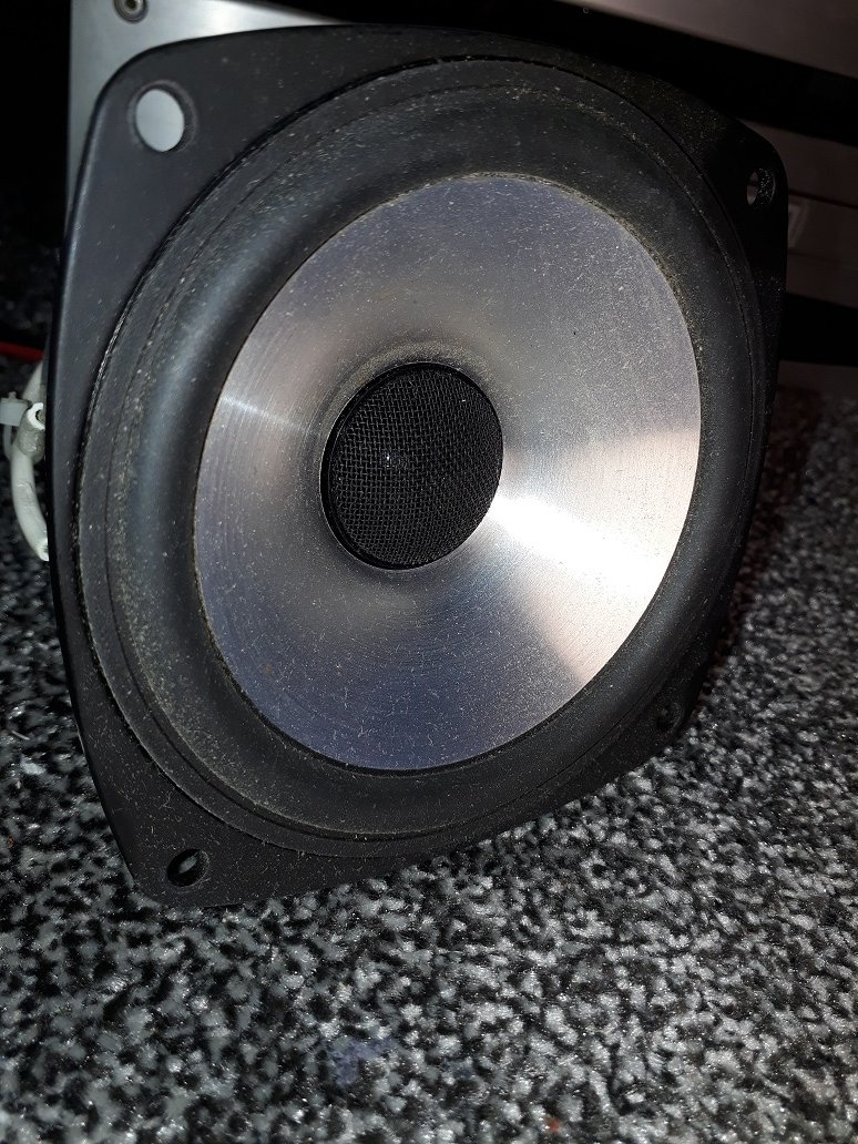

SP1457 100mm 4ohm
I have relocated the crossover there myself.
This is the right driver. The black tweeter is the visual clue. The v.2 is silver. Comparatively no magnet on the back of the silver tweeter one. Which aligns with the Q series, not the R series. These early one's have the internal port tube made of reinforced pvc vacuum hose, cable tied on. It's a diy look. The mass production version it's blow moulded or something. The v.2 is trash. A different speaker, pretending to be the v1 which got reviewed.
