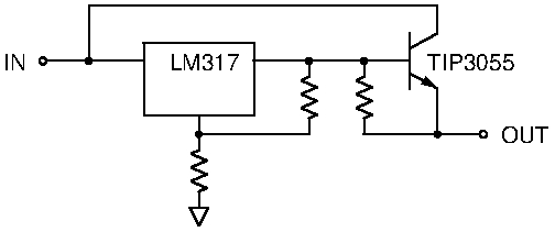

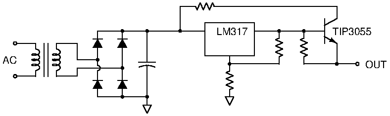

I will claim that I can manage to get 10A regulated out from an LM317 based regulator when using a TIP3055 buffer transistor in a TO-247 housing (my first drawing below).
The TIP3055 buffer transistor will handle almost all the load current and take almost all the drop-power. The LM317 only supplies a stable base-voltage to the TIP3055 and in the order of 1/40-ties of the load current plus the bias current set by the base-emitter resistor of the TIP3055. When the TIP3055 sees a large change in the load-current, the LM317 output sees a much smaller change in TIP3055 base-current and with the fixed bias current (base-emitter resistor), a relatively smaller change. Therefore the output voltage change will be rather small even for a huge change in load current because the output voltage drop is determined by the TIP3055 base-emitter voltage change. The change will hardly exceed a couple of hundreds of millivolt.
Yes, with a low-drop regulator we can perhaps operate with less voltage drop than with an LM317 but the difference is not as important as we could expect. The reason is that the largest change in voltage to be accounted for by the minimum voltage drop of the regulator is the drop in voltage from the rectified transformer - from almost unloaded to full load (my second drawing below). For a 12V supply, this input voltage variation is likely to be in the order of 3-4V. The buffered LM317 shown in the first drawing can work down to an input-output voltage drop of some 2.5V. Which low-voltage-drop regulator can supply many Amperes with a drop much below 2.5V?
Linear regulators are inherently suffering from power loss even if a low-drop regulator is used.
We can replace the transformer+rectifier circuit with an SMPS having an output voltage some three Volts above the output voltage of the linear regulator. Then we can reduce the power loss in the linear regulator but the complexity is increased. Next, soon we will question if we really need the downstream linear regulator or if the SMPS can do on its own.
Yes, the LM317 is an old design with more noise than some modern (and more expensive) ICs. 0.003% noise (ST; less than a millivolt on a 12V output) is absolutely no problem for the majority of general purpose uses. Old, but still good enough (my wife says the same about me). Thus, a buffered LM317 can handle surprising current levels with a sufficient “quality” to suit most of our general purpose needs. The total price is very modest.
However, when adding the buffer transistor at the output of the LM317, the LM317 current limiting function is lost. This is why I added a resistor in series with the collector of the buffer transistor (my second drawing below). Using a PNP base-emitter to detect when the resistor voltage gets close to 0.7V leaves us the possibility to pinch-off the LM317 reference terminal voltage and thereby have the current limiting functionality back.
LM317 is not for delicate low power applications but it is very useful for most general purpose applications with higher consumption.
My defense for the LM317.
