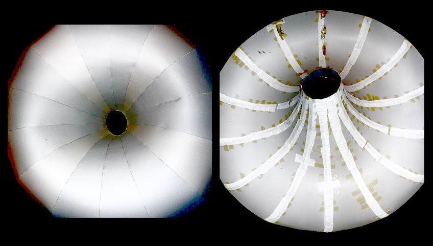

Im trying to find pdf plans to try and make a cardboard one, petal/leaf style would like to try the Le Cheac'h, tractrix, conical etc...
You can buy off the shelf adapters to fit the different options, but 2" throat would be a good start.
Hello,
The last version of my spreadshheet allows a petal /leaf structure of the horn. The rpofile of the petal as you can cut in a shhet of cardboard, metal or plywood is calulated.
Send me a valid email adress at
jean-michel.le_cleachXmines-paristech.fr
(replacing the X by the arobase) and I'll send you that spreadsheet.
Here is a cardboard model build by an audiophile here in France (thanks Haa)
Best regards from Paris France
Jean-Michel Le Cléac'h
