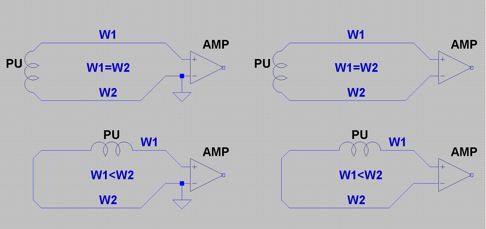

So just to add a little food for thought 😉
If You think voltage wise then Yes, the gnd is just a fixed reference potential and ideally I´d measure from the gnd reference to all other points labelled gnd 0V.
In praxis this isn´t the case and small voltages could be measured as the impedance of a trace or wire can´t be 0Ohm.
That a voltage drop is measurable is the proof that a current must flow.
So of course is ´gnd´ a return path of exactly the same current that is flowing through the ´+´ (signal) wire.
As the current is flowing through both, ´+´ and ´gnd´wire their impedances add.
From this follows that it doesn´t change anything -neither from the voltage between the preamp inputs nor the current- if the wires are of different impedance (or thickness).
As a cartridge is inherently a balanced source one can choose any potential for the returning wire off of the ´gnd´ reference potential.
This will change nothing, neither volt wise nor current wise if You measure between the two wires (two inputs of the Amp)
All four setups sketched in the attachement behave absolutely identical as long as the sum of W1 and W2 impedances is constant.

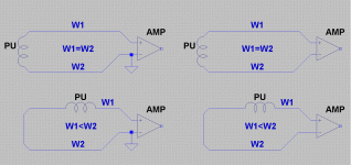

DF96 already told whats wrong with that claim.
