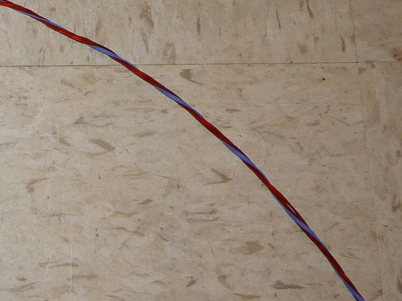

Below is a step by step process for making a terrific phono cable yourself.

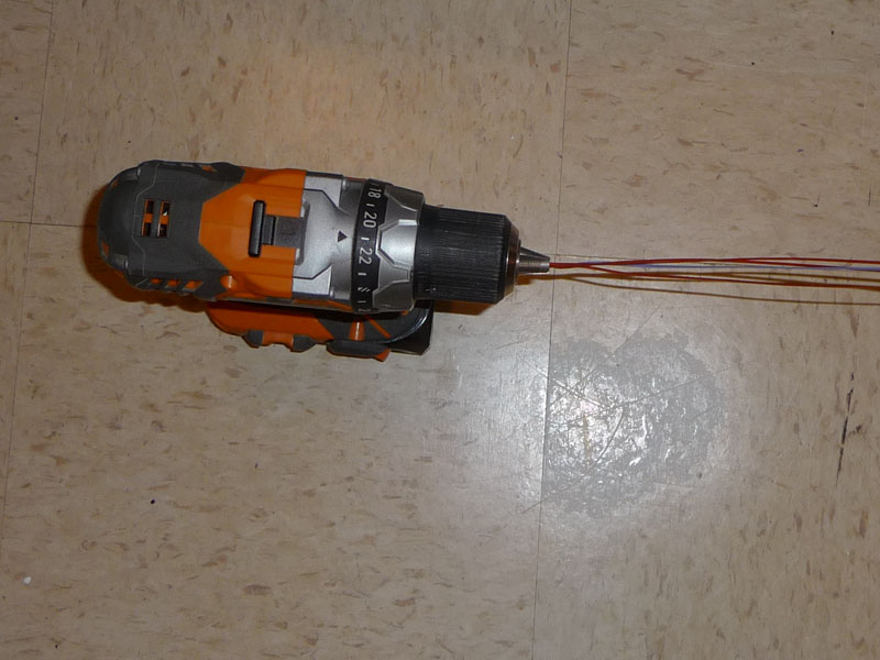

1. Cut the wire into equal lengths (I like to mark one of the wires by cutting back the Teflon as marker will not stick)
2. Tape the ends so the wires are sort of squished together
3. Put one end in a vice and the other in a hand held drill
4. Slowly turn on the drill and let it spin until you have a nice twist- these are solid core wires and will retain the twist when released

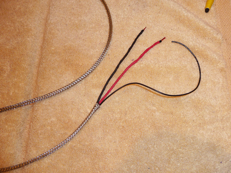

5. Twist the single Pos and Neg run into a Y that will go into your preamp via RCA
6. Put the tinned shield over the cable and trim to size
7. Pull out a little group of the shield strands and solder
8. Solder a short wire on the DIN end and a longer ground wire on the RCA end
9. Put the heat shrink over your Y connector wires- hopefully a different color for + and -
10. Pull the Techflex PET over the shield
11. Put the heatshrink on the ends of the main body
12. Solder on the connectors
