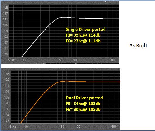

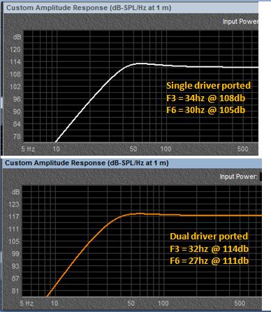

Hi Zobsky,
Please see the attached image.
That is a single driver Vs dual driver PORTED subs I built earlier.
I always tuned the subs higher than drivers Fs to minimize group delay etc.
I never tried extended bass shelf earlier. I will check that.
Current requirement is to find an enclosure design that can go below 20hz or 15hz @F3 or F6 with single driver.

Hey Bentoronto,
Dayton Audio RSS315HF-4 is interesting!!
All the subs I made earlier are tuned higher than Drivers Fs.
The bass is clean and quite enjoyable. (Please see the attached graph in my above post)
Now I want to explore the ways to tube the box down to 20 or 15hz with my existing driver (if thats possible at all)
I want to see how it sounds with the same driver. Trying to see if any unusual enclosure design can do the trick.

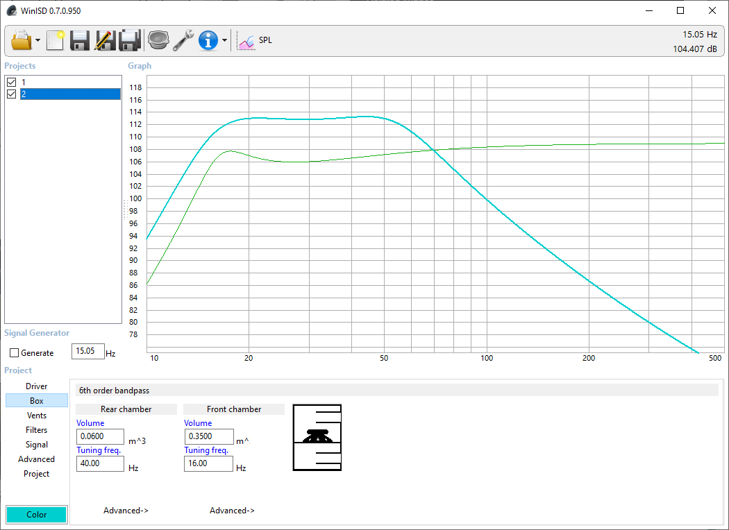

Thanks for suggesting 6th order bandpass. I will try to simulate. !!
(But what is your observation from your experience? 6th order bandpass gives tight and accurate bass or will it be boomy with less transient response?
sorry guys ...the image i attached in post#8 is wrong.
Here is the correct image
So basically 6th order bandpass is one I can try.
Any other enclosure designs that can be tuned very low??
Sonotube will work ?? Or any other ideas??

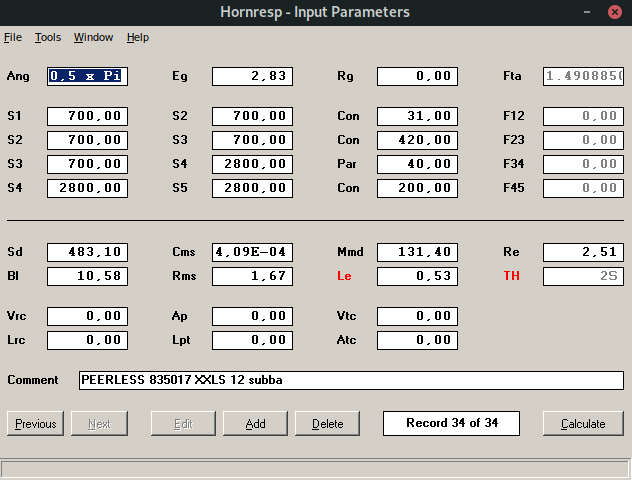

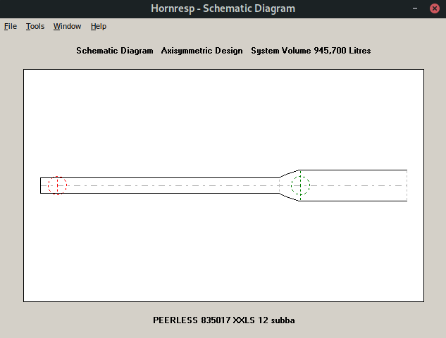

Since you did not define max tolerated enclosure size and did not specify the driver I granted myself some freedom in those regards.
Here is a large SUB-ROAR212 which pressed up into a corner is a quite capable subwoofer down to 15 Hz.
Max spl is simulated with 20 mm xmax and 400 watts for two 12 inch drivers.
I used Peerless XXLS12 is this simulation.
Also, ensure that the T/S parameters are correct, most often they are not. If xmax is not as much as claimed then it will be a big disappointment.

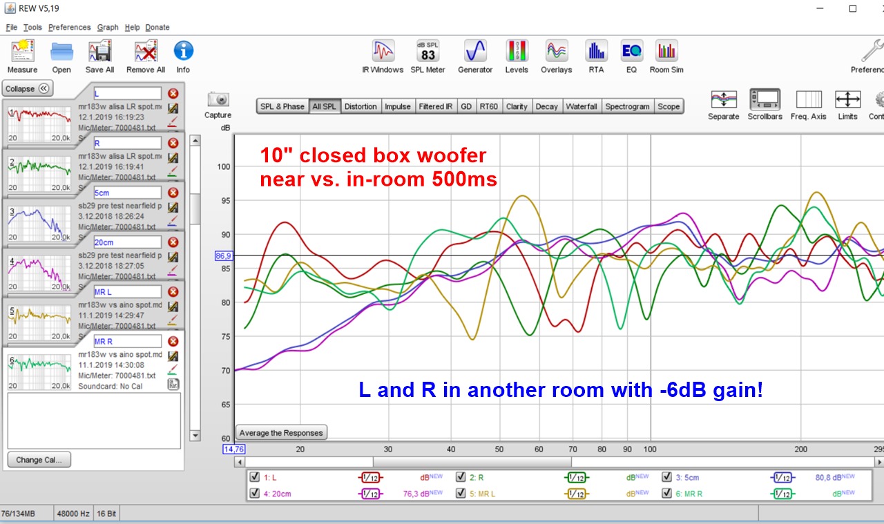

Sealed big boxes put in the corner of a not to big room. If you need more low end you can eq that in until you reach xmax.
Sealing/stuffing the BR ports with a towel might be enough.
With closed box, modern dsp and cheap power, we can have the response we like easily, but sdp capacity/distortion easily become a problem. Room gain helps a lot below 30Hz in most rooms, and below 25Hz we hear mostly distortion.
Here a single 10" woofer nearield vs. room response. I recommend at least a sub per main speaker!
