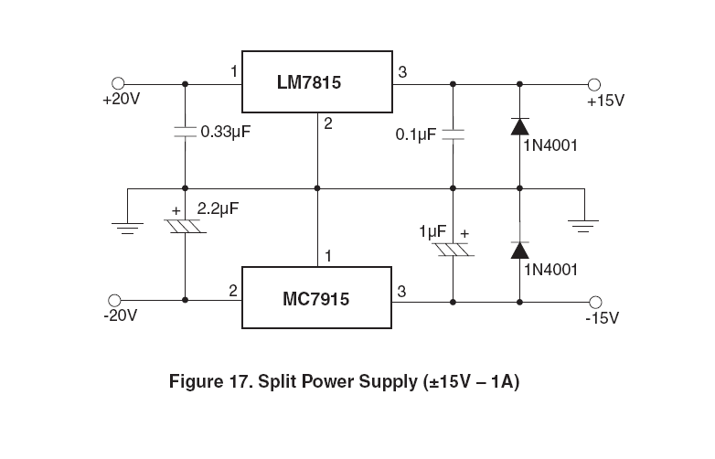

i am doing some modifications to an old cd player and want to build a powersupply for the op-amp. the dac i already done this for. but that was somewhat easier. it just needs 5vdc. but as i can see the op uses somewhere between 4,5-24V pos and neg
i have tried to build a regulated psu for this but i failed twice.
i have ample supply of 78xx and 79xx regulators but i seem to be missing something important,
can someone point me in the right direction? is there any good schematics somewhere?
Yes - the datasheet:
for a +-5Vdc regulated supply you should be using a 6+6Vac to 9+9Vac transformer, not 15+15Vac transformer.
If you pre-regulate down to ~10V and fit big heatsinks you can use your high voltage transformer but that's a lot of extra hardware that can be avoided by buying the correct transformer.

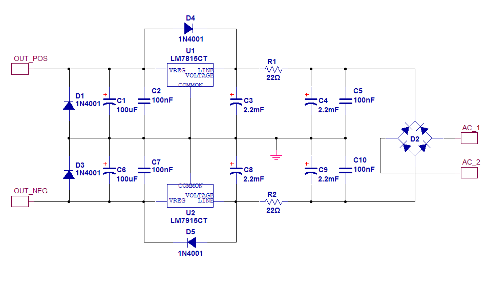

thanks for all the advice.
i managed to get it to work. i used the schematic posted by MJL21193
and some of my own touch. works like a charm. sounds probably as good as a op-amp sounds
