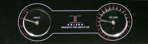

I got mine and did already build a simple magnetic pre ... it was soooo easy to do. I chose 0dB configuration and used an alps source selector and an Alps 23step switch. Until now it did not play for more than three records but even now I am satisfied .... an my expectations were huge after all that hype (and the price, of course)
I'll post pictures etc.next week

I have put my TVC on my website here
I used unity gain, RCA inputs and outputs, connected input and output ground together but SEPARATED ground of both channels as this is already connected in the sources.
Sounds wonderful! Just neutral, no hum, no noise, but yes: dynamics
Cheers
Christian.
