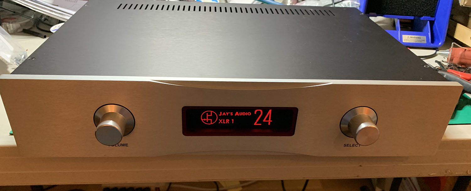

Khozmo makes a relay based stepped attenuator where each board handles two channels (or one balanced channel). Multiple boards can be controlled with the same encoder. I'm using two in my fully balanced stereo preamp, but I believe you can use an arbitrary number of boards stacked together.
It may be overkill for what you are looking for, but it's very high quality. The one I'm using has an OLED display which shows the current volume. It always starts at zero on power up.

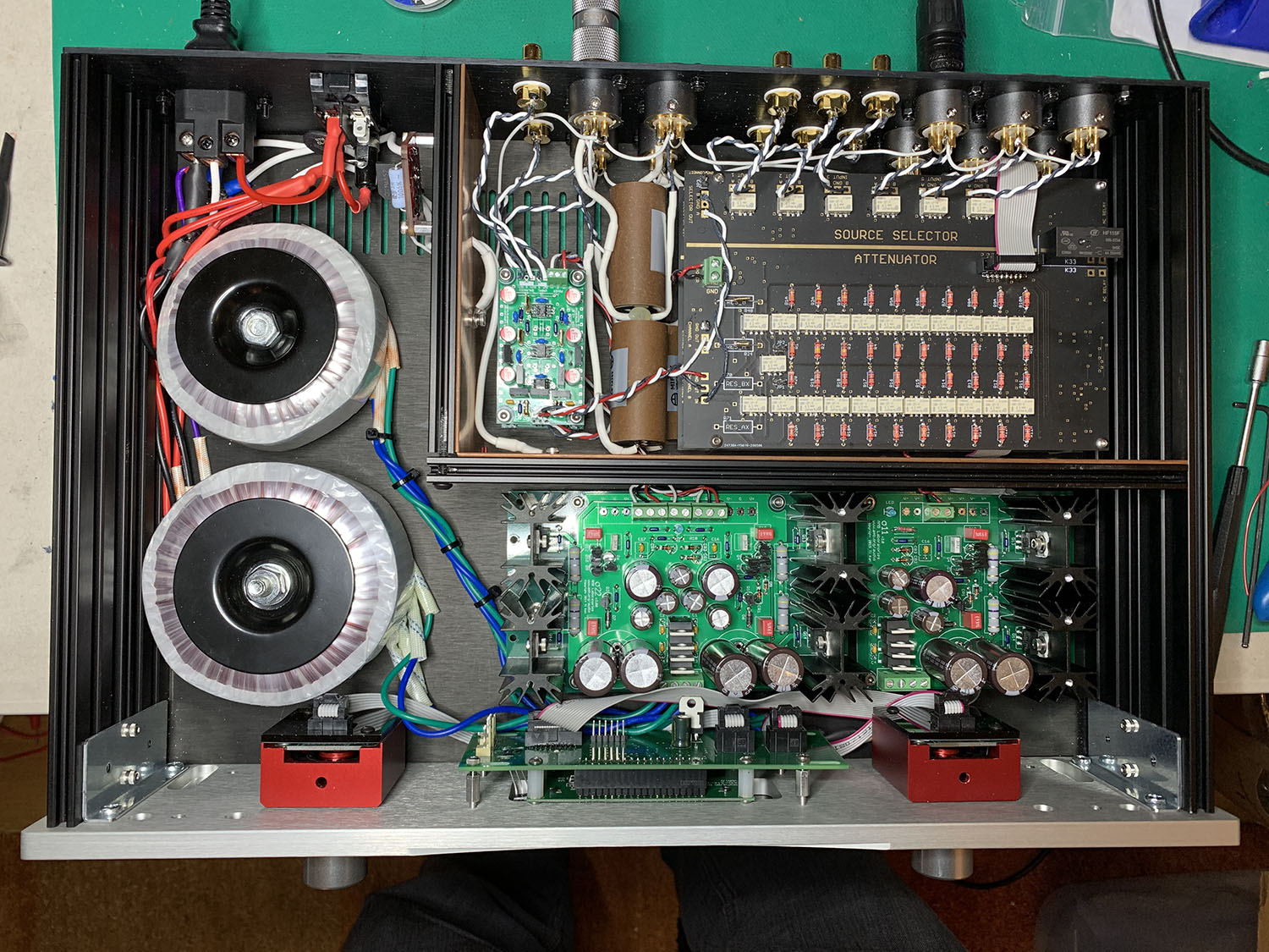

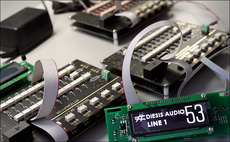

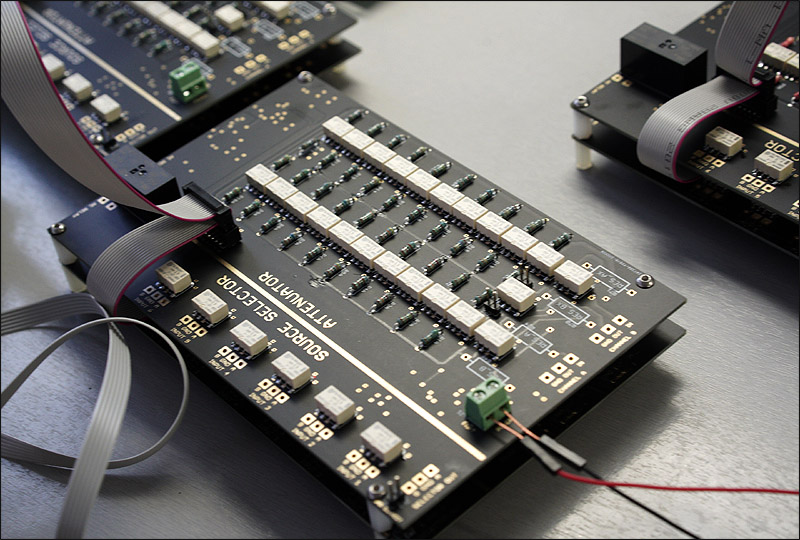

I don't think they have the product I bought listed. I've attached a couple of photos that they sent me, as well as photos of my preamp.
The ribbon cable from the controller is daisy-chained between boards. I'm not sure what the limit to the number of boards is, so you'd have to contact them to find out.

Thanks @armandhammer. I've only had it running for a week, so still running in the caps. I have two balanced outputs - one DC coupled from the buffer, and one through Miflex copper caps. The latter is intended to roll off the low-end since I use stereo servo open-baffle subs up to about 80Hz, and this makes it a bit easier to blend the towers (also OB) with the subs.
