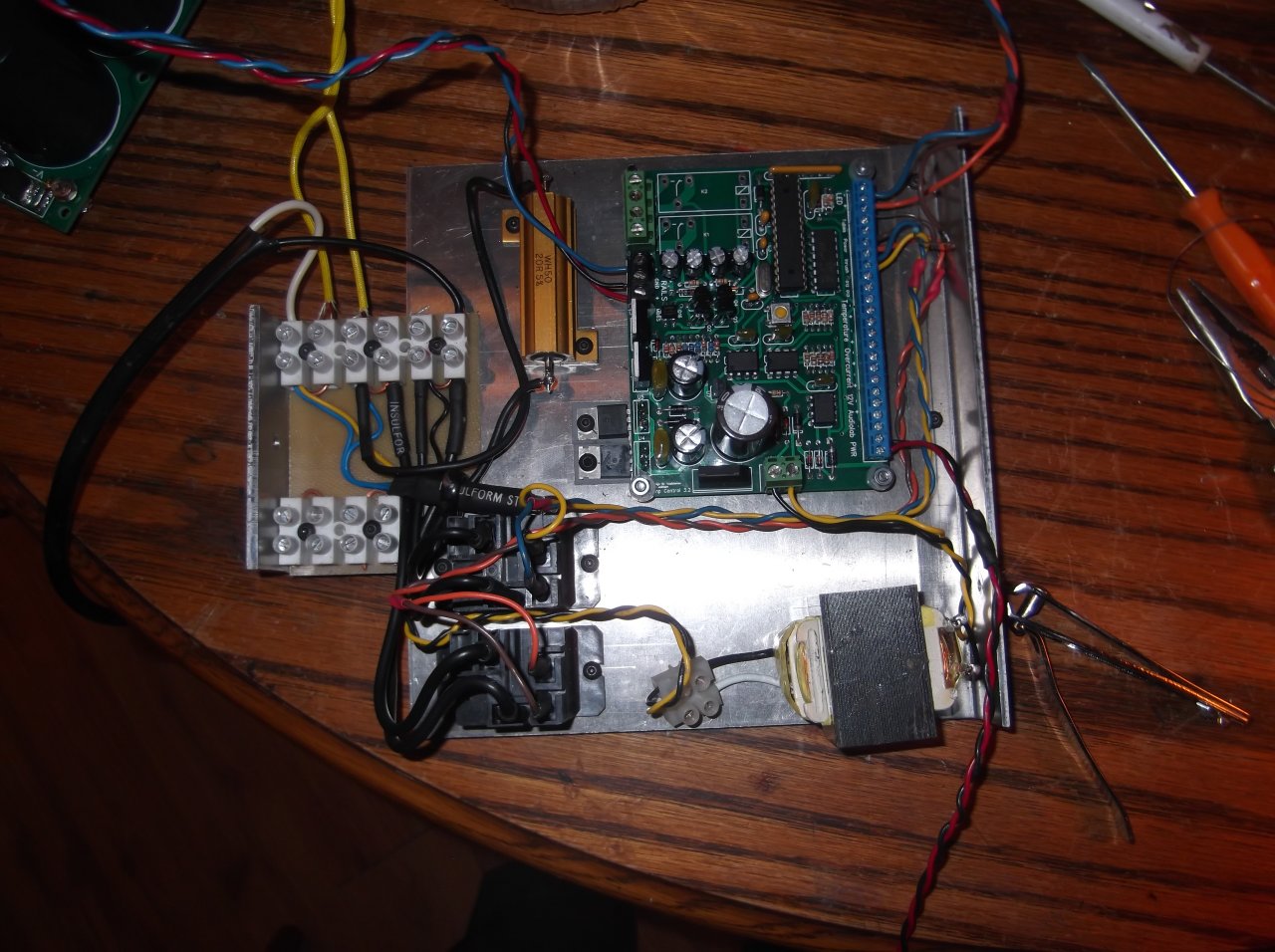

I sacrificed usability in favor of "visual design" minimalism, using one red led for everything :D
Sure, more leds/colors are easier to see across the room. That's the great benefit of this design - enhancement flexibility ;)
Whats wrong with "fancy" .... the UNO is SO easy to use.
I have decided -
- standby is dim green
- startup is bright green
- speakers on is bright yellow
-faults are combinations of flashing red/green.
(I can't get rid of the green and still have "standby" :()
Colors are far more "final" than brightnesses (as indicators), especially with these higher efficiency new LED's ...
. the 4.7K "standby" resistor actually might have to
be 10K-15K to actually get a dim green.
All this with one extra digital port and one external 270R on the LED cable.
And , I tested my "summer mode" script - where a thermal fault won't shut down
..... but switch "tubes" to turn on a fan - it works so good - VERY pleased !
PS- 6V triggers offset , about 60C thermal (w/mje340) , the 2 "ice-storm" brownouts triggered
the AC , and 2.1+V gets the overload.
(tested all - below) That's the better control module ! :cool: AC "creep" considerations,
neon AC indicator - totally overbuilt - but it's controlling a 1KVA... better safe than
sorry !
I have decided -
sorry !
OS

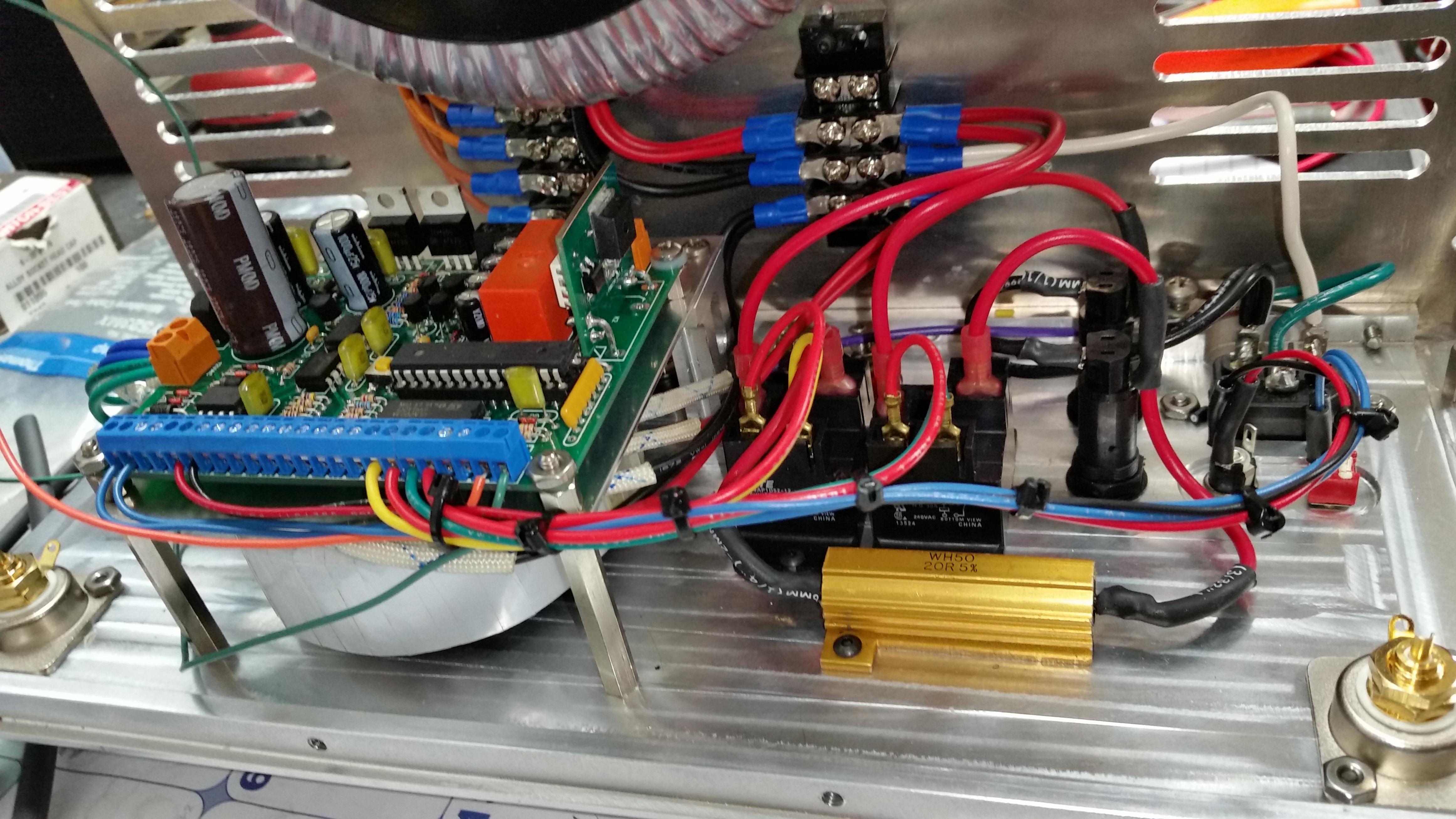

ready to rock ! ... almost.
Just a few more questions -
One for Jeff -

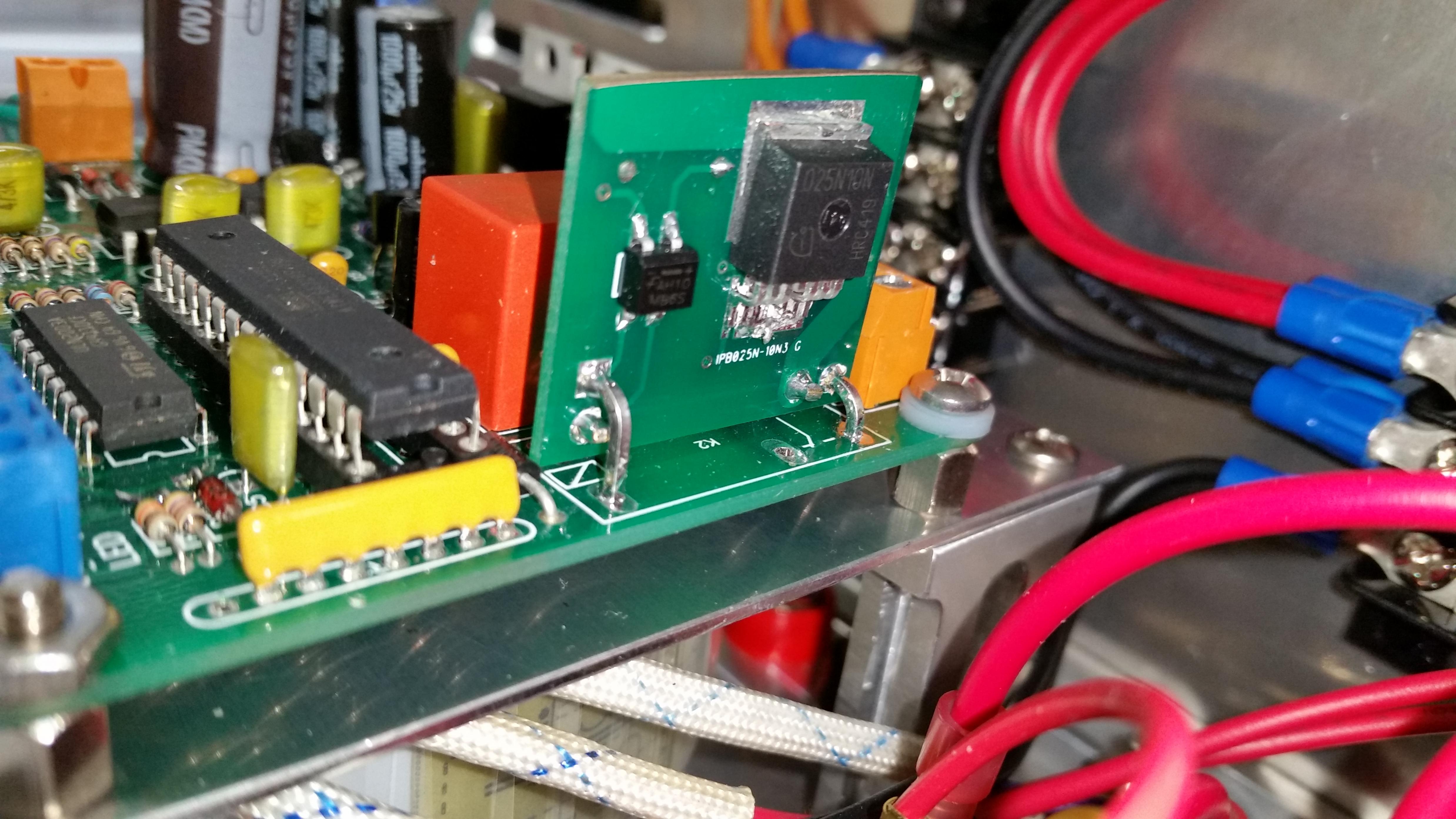

On the solid state relay boards -
Could you give a close-up photo so I can see how you
position the "adapter pins" . I'm going to have to shave a centimeter
off the tops of the PCB's to fit my case. Maybe a little
more as the big foil is the actual speaker voltage ??
Any other hints/tips on them would be appreciated.
For Valery - On scripting
I can't seem to get any "action" (operation) out of D12/D13.
D4/11 work perfect and I just substitute "HeatingLED2"=D11 plus add
digitalwrites to run my bicolor led.
I want to make the bi-color work but free up the heating , in case someone
would want my cool setup for a "valve job" :D
Do D12/13 digital pins require different commands ?? - Arduino says they are
digital but not full PWM like D2-11. I know D13 flashes the built in UNO/nano
led.
Can I post the fine tuned 2 led script , or is it a secret ?
PS - (below) is bright yellow during softstart/pre-speaker run. :)
I have dim green ,> yellow ,> bright green ,> + red/orange for alarms (super fancy -
still one led + inline 270R hooked to "heating").
Any 1A 12V walwart trafo salvaged can be used for this board ,as well. :D

You can cut the relay down to the top of the mosfet pad. I can only get a picture of one side of the relay board. You will need to drill the pads on the relay to 1/16" to fit the header pins through. Polarity on the 12V pins doesn't matter but you will need to chop the excess pin off the top of the lower one or it will touch the upper one. You likely see by now why I want to mount them on the main board. These are a PITA.

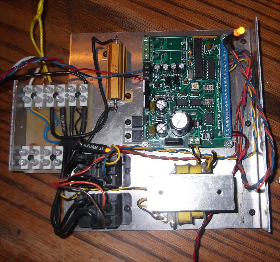

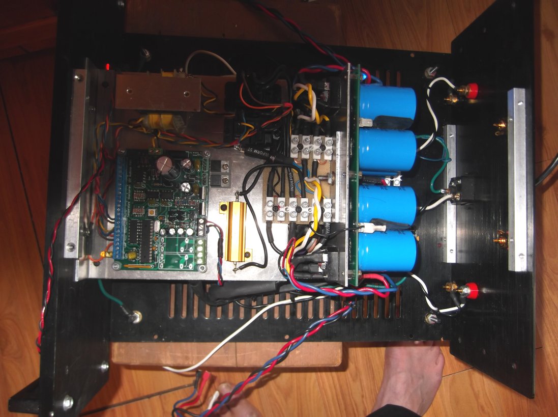

Yup - I could not wait. "Absorbed" the whole arduino site last night , all functions/
variables/structures are "in" me now.
not only did I get D12/13 going , but made second "mini loop" to auto reset after
thermal ( to test out my new-found knowledge:D).
This thing REALLY rocks now. The designed LED just did level changes which
were hardly noticable , even the flashes had just the low/high 12 and 7 V. Not
much "contrast" :( that why I did what I did.
Now I have ...
-Red - standby
-Green /w red flashes on inrush
-Green - good
- and Red flashes for alarms.
"Tubes" are restored.
Just 1 common anode dual LED with a 470R resistor on the anode.
The original LED is a onboard indicator for the main /standby start sequence.
const int PowerLED1 = 12; // PowerLED1 On HIGH
const int PowerLED2 = 13; // PowerLED2 On HIGH
const int OnboardLED3 = 4; // Onboard LED3 on LOW
(script file is 3.5K now )
Just rename any LED function to the appropriate choice of 3 outputs.
I respect keeping the script from counterfeiters/ and other vermin. That's why I asked. :vampire:
(below) Is the "deadly" power supply running safely on the control board. :):)

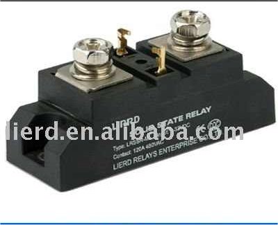

I'm thinking about SS relays for the transformer controls. It might be good to loose all mechanical contacts. Especially in the plate amps. Do triacs run cool like mosfets do in switch mode? They look fairly easy to implement.
Just use the drop-in industrial SS relays. (below) 12V opto triggered 50A device.
Used these to fire up indoor growroom halogens :D (tomato's).
Keep anything like this OFF the control board. Below relay mounts to a plate
(aluminum) to dissipate that max rating.
PS -Have 200A versions of these relays (3 to a heatsink) controlling the whole freezer section
of a supermarket. They refurbished , I took what was in the e- waste bin - they worked !!
Edit - our 30A contact relays just see the inrush through the resistor and the second one
just feeds an additional 5V rise in cap voltage. Neither relay is seeing any real surge.
once the relay is closed .... don't matter. Val's "overlap" has both relays feeding the
caps after "inrush" , as well.
