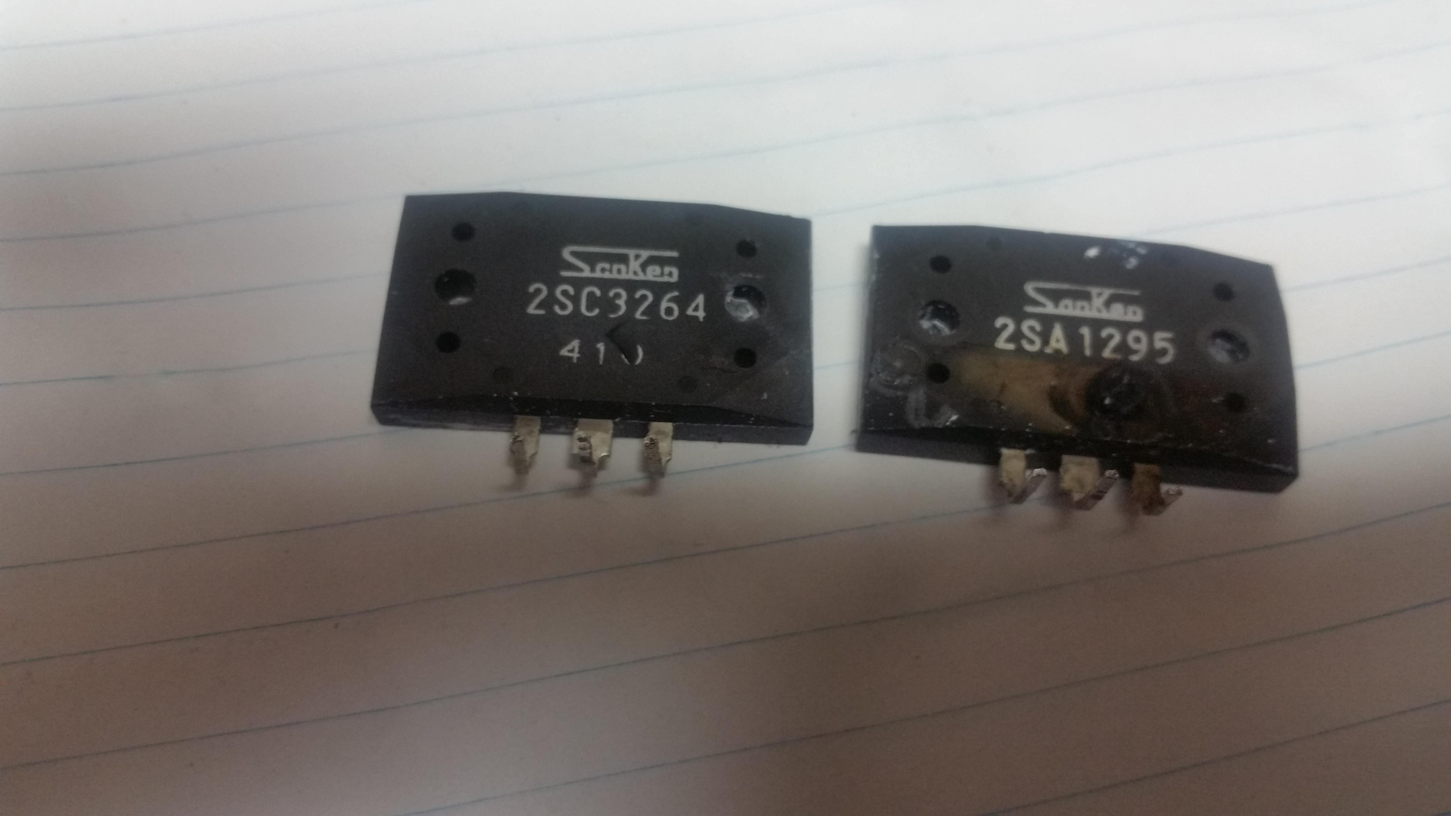

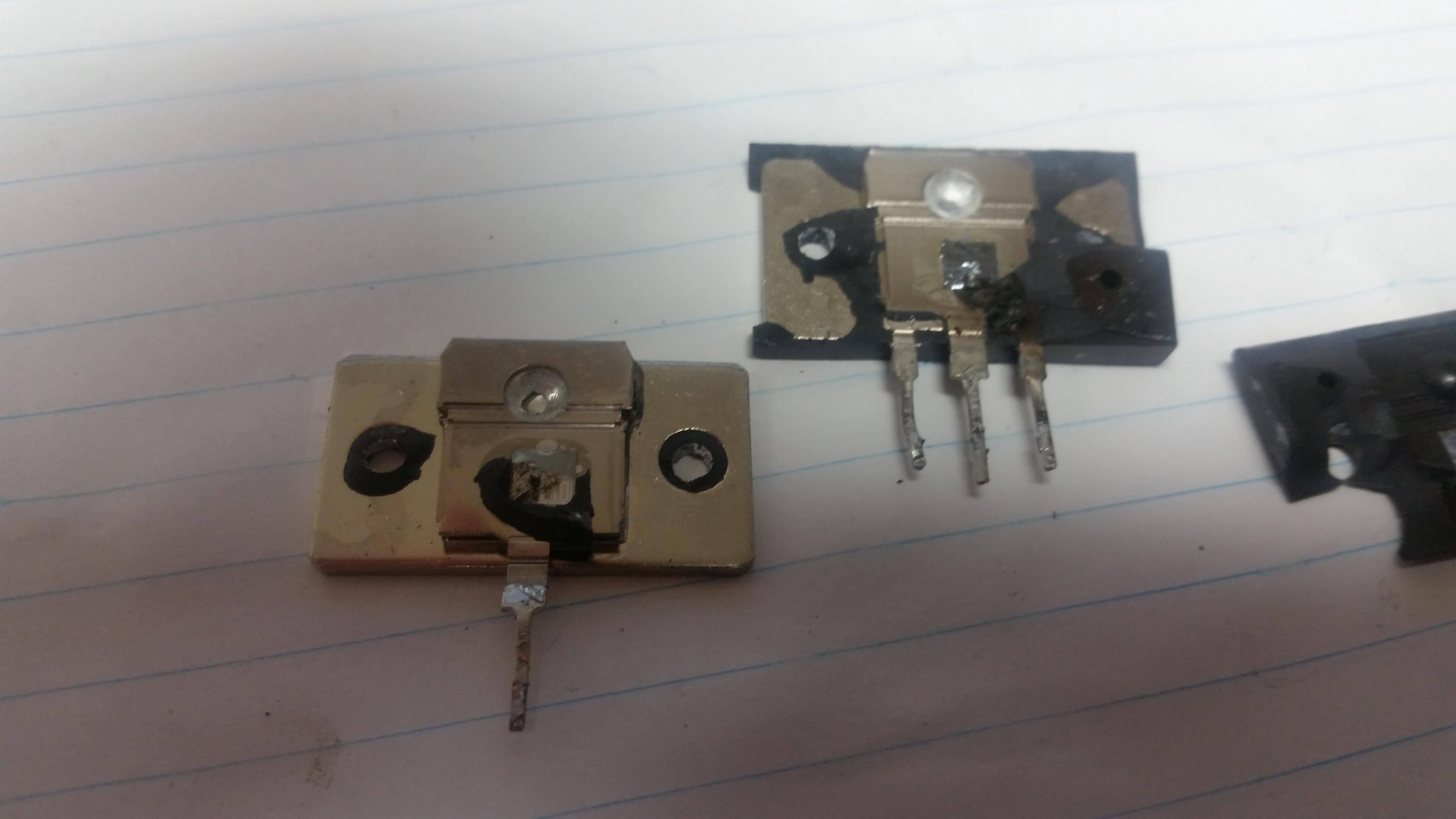

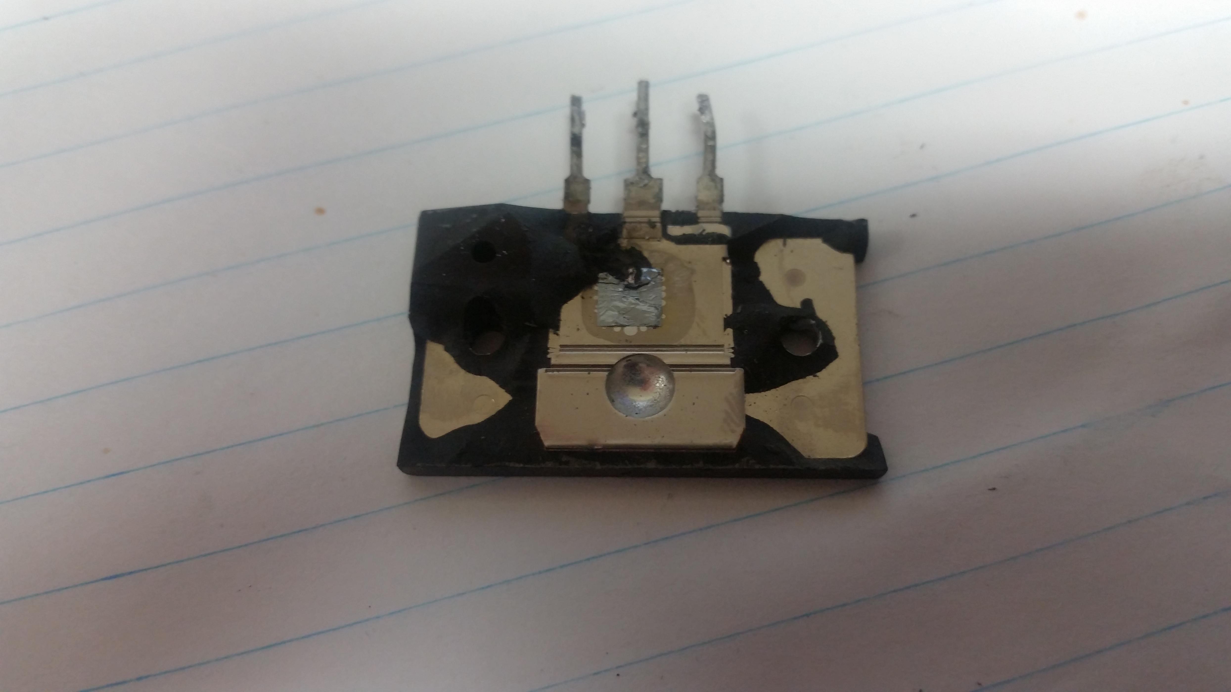

I managed to blow up a solid state relay. It blew open like I was hoping. I still need to disassemble the relay from the protection board to see if the actual mosfet failed or if it was the clamping diode. It took a Slewmaster with 63V rails in full oscillation into 4 ohms to the damage. The MT200s let out a pretty good bang at the same time.
WOW ! break one open so we can see ...😱
Oscillation might of caused thermal derating (SOA dropped).

This was an intentional failure. I assembled a two pair board and set it up to oscillate just to see what would happen to the relay. It was actually a pretty tough go to fry it. I think normally the current limit and temperature limit would have shut the amp down long before this point. I had Thimos' glowing Zobel resistor happening too.

If there's any chance of danger I test a prototype to death in my office. Stainless benchtop, fire rated drywall and a fire extinguisher under the bench.
These MT200s look like beefy TO3-Ps bonded in a bigger case. The case rupture happened right over the emitter leg connection in both. I'll dissect the mosfet when I get it apart.
