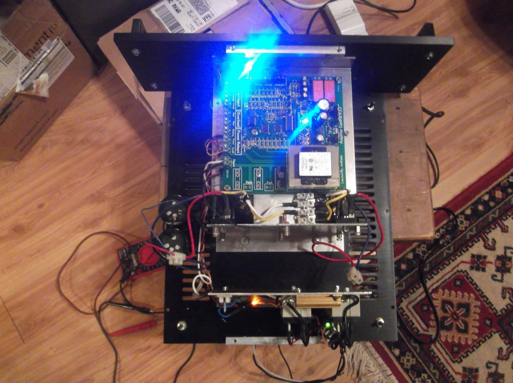

Real board test ....
OK ,
Did the recommended updates as Jwilhelm suggests -- bridge trafo secondary and
chassis mount the 7812 regulator. Trafo barely gets perceivedly warm and the
7812 just makes 1/2 the aluminum plate slightly warm with all 4 relays on. 🙂
Triggered the thermo , overload , rail sense , and AC - all works.
Start- up of INRUSH - main AC - Speakers - OK.
Adjusted ms timings to 5000/
5000 , a shortened inrush to AC delay and a longer AC to speaker delay.
I have this PS wired to be able to turn off the inrush delay after the "AC" initiates.
I'm not quite sure where/what to insert a line of code into the script to do this.
It would also be good to "overlap" the timings of the 2 relays (just in case
there was a highly biased load present.
How would you do this , Val ????
PS - I can "verbosely:" see my relay states with the neon and green led at the front
of the photo. 😎 I have a temporary 8200u/100v X 2 cap bank to test @ +/-76V.
The 1 kv trafo will trip the house breaker without the inrush - one massive block
of copper / ferrite - thanks.
Excellent design ... Val , it works better than I anticipated ! 🙂🙂

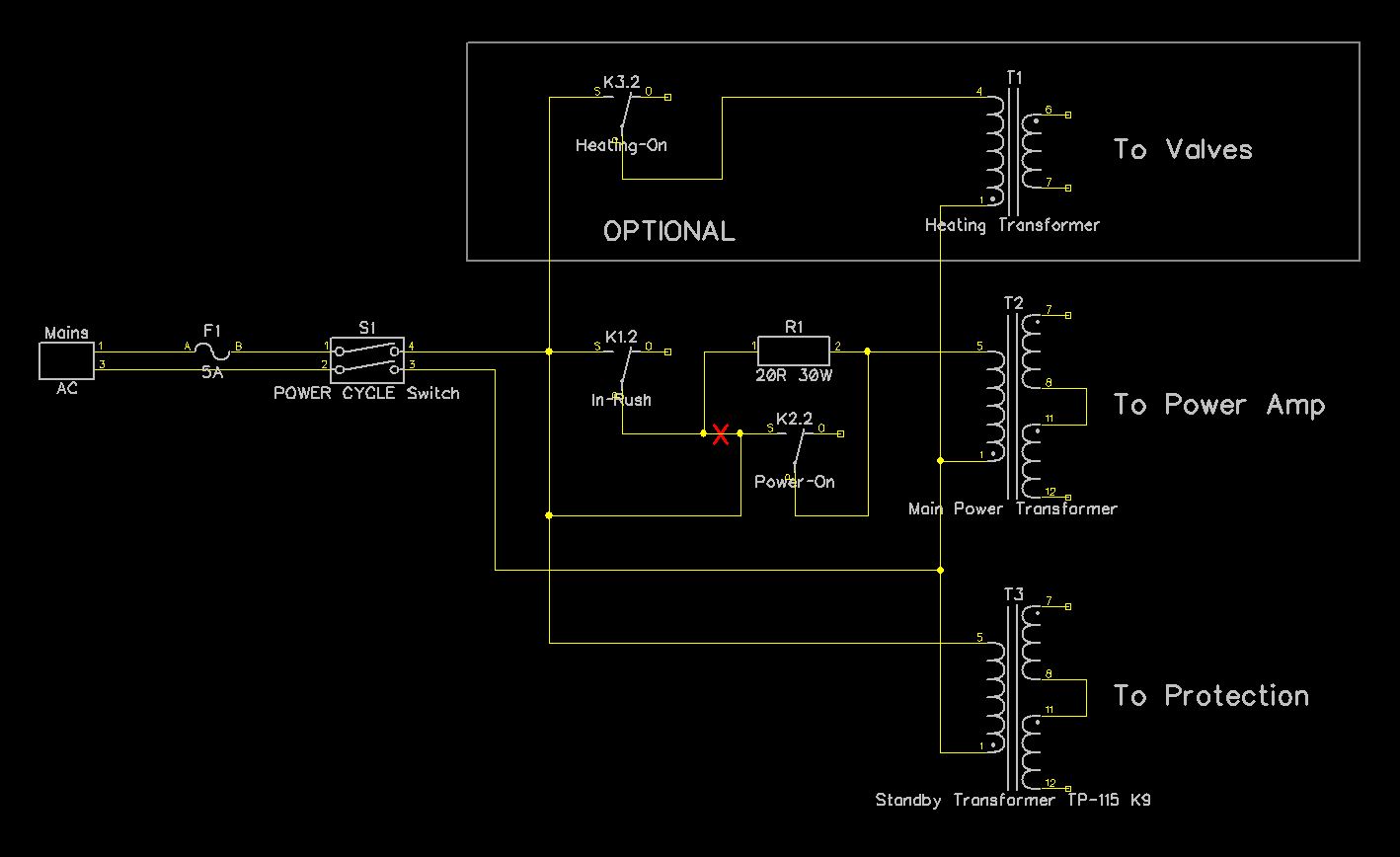

Hi OS, thanks for the feedback 😉
I initially designed it for my own use, so, you know, I tried to do it well... just joking 😛
Pls. drop your email in my PM - I'll send you an updated firmware with inrush switch-off and overlap management.
Valery
Just tested the updated firmware on my Arduino test-board with LEDs and buttons.
Everything's perfect 😀

yep , jeff's suggested bypass of inrush - as your schema shows.
But , power-on goes off 3 seconds after "overlap" , ac failure flashing (led).

Is it possible that you've got the PowerOn and Inrush relays swapped?
On V5 sketch , I also checked by disconnecting inrush .... AC relay is working
by itself. On V6 , AC shuts off before the final speaker engage - showing as
"AC fault" .... as it should.
Nope , I thought of that .. too. Even that would not make BOTH relays turn off
8.5 seconds into the loop. If either stayed on , there would be no "ac failure" , correct?

AC failure doesn't make sense physically. It senses AC off the 12 volt transformer on the protection board.
This is what happens every time I try to adjust code myself.🙄

It may be the case, is something shortens the mains, so that the small protection transformer suffers as well 😛
I think that just monitors that little AC trace off the control transformer. I'm not going be near the office until later today. So I can't test here.

Maybe lengthen the inrush delay. I wonder if you're browning out. Or use a separate power source for your transformer.
If you're sure that it's really PowerOn relay that goes off, while Inrush stays on, you can change the ID in the code (digitalWrite(PowerOn, LOW)), so that the new part of code will look like:
ROCK steady 121V - all through the cycle.
Ahh - fixed it. It was script related.
Commenting the last 2 makes it work as it should (with the mS overlap). 🙂case 4: // We are in ON state
checkDCoffsetAlarm();
checkOverloadAlarm();
// !!!! Uncomment in production version !!!!!!!!!!!!!!!!!!
// checkACFailureAlarm();
// checkOverheatAlarm();
// ************ Continue with cases if any *************
Perfect 5000mS inrush , 250ms overlap and , 4500ms till speaker (timed it).
ALL fault triggers work.
Edit - V5 had these commented , V6 uncommented.
