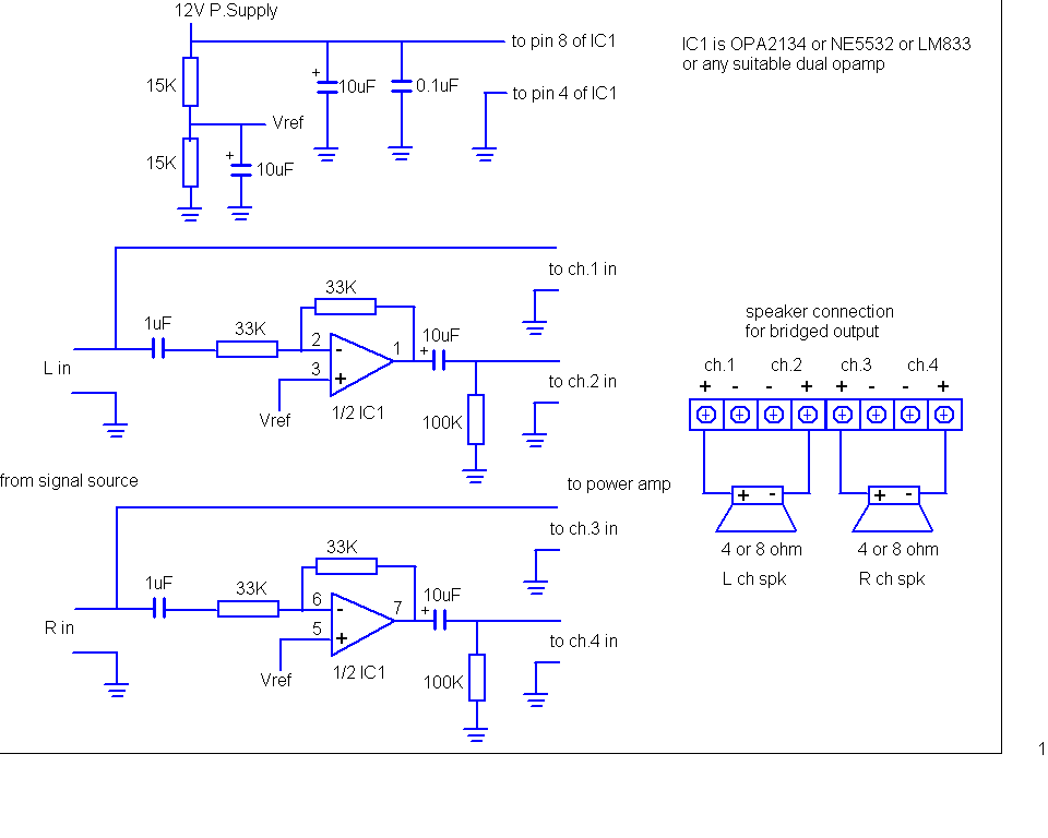

Your amp is still possible to bridge although there is no built in
facility to do that as stated in the spec. You can add external phase inverters in between the signal source and the input terminals to the amp. and also need to reassign the meaning of the speaker out terminals of the amp. If you need any schematic to do it, I will email to you.

How expensive are phase inverters?
(I am trying to do this as cheap as posable since the amp was free)
Can I make one myself?
I know how to read a schematic and have a basic knowledge of electronics.
Just an opamp and two resistors, assuming you have a split supply to power it from?.

Here I have the schematic to bridge your amp. its size is big (2.3 MB) so I will email to you. Please give me your email adderess.
The bridged amp will ouput about 80 watts at 8 ohm load and 100watts at 4 ohm load, you don't get 160 watts because the amp could not supply so much current as the spec. says 50 watts into 2 ohms.
Talking about the cost: NE5532 cost less than a dollar, you can build the whole thing for under 5 dollars.
Floating ground does not mean that the amp has been bridged, the easy way to find out is to measure the continuity of the -ve terminals of the speaker outputs, if they are shorted, the amp has not been bridged.
Here is the schematic, I managed to convert it to jif format so it is much smaller.
