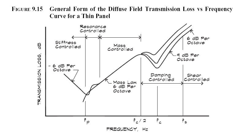

I just read through a long thread in the Construction forum on cabinet materials. This chart was posted there (without provoking any comments), and it seemed appropriate to this discussion:
I think it drives home that different approaches are needed for different frequency ranges. Does anyone know the source? Google image search was no help.
What would "Shear controlled" mean in this context?

Hi Bill,
See this link.
https://books.google.co.uk/books?id...s vs frequency curve for a thin panel&f=false
Peter

A link to a similar chart was given in Post #174
