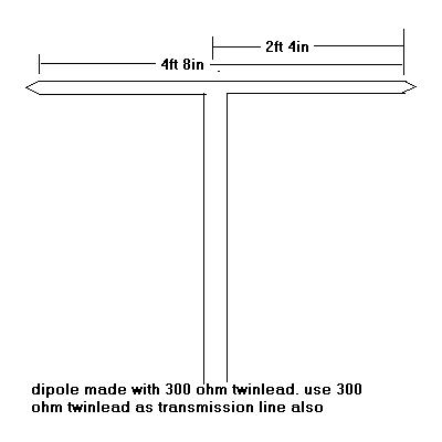

a good passive way to get better reception inside the building would be to have a high gain antenna outside the building and connect it to a high gain fm antenna inside the building, a pair of dipoles would also work, but not as well, but dipoles are easily built.
You know, I thought about that but it seemed too simple to work, I thought it would require some elaborate power setup. Okay, point me to a tutorial on dipoles or high gain antenna construction. I'd Google it, but I'm sure somebody on this forum knows right where to find a good design.
here's an fm dipole made with 300 ohm twinlead.

a good high gain antenna would be a 5/8 wave vertical. these have about 6db gain over a dipole. google "J-POLE" antennas. these are the simplest, and can also be constructed with 300 ohm twinlead. most of the ones you see on the web are for 2 meters(146Mhz center freq) and would need to be recalculated for FM broadcast (about 100Mhz center freq). it's just shy of 1.5 times the length. try multiplying the lengths given for 2M (146Mhz) by the ratio of the two frequencies (146/100) and it's 1.46. so your dimensions for the antenna would be 1.46 times longer.
j-poles usually need to be adjusted for SWR, but since you're using them for receive-only and a passive radiator, just make sure you make both exactly identical, and you should get good results. if you have a way of testing the SWR of both antennas at 100Mhz, that would be even better. if you end up a MHZ or two, it's ok, as long as both antennas are identical.
it would oscillate. those antenna amplifiers have a lot of gain, and to pad one down to the point where it doesn't oscillate would defeat the purpose of having it. a passive system would probably be best. any active system would have to be direct connect to the receiver, or a frequency translator (shift everything up or down 1Mhz) to keep it from oscillating. even if you could get the antennas positioned properly so that an antenna amplifier wouldn't oscillate, all it would take is somebody walking around within a couple of wavelengths of either antenna for it to begin oscillating.
