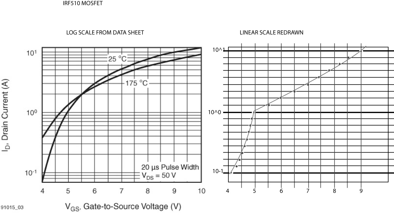

In looking at the Vgs vs Id graphs on the data sheet, this makes sense if the input signal is in the 1Vpp range. But in my case, where the signal driving the gate is relatively large, what to do?
The graph in the data sheet has Id drawn in log scale, so I manually redrew it in a linear scale, so I can see the curve correctly (attached).
What I see is a large hump at 5V which is where I presume the FET goes from linear region to saturation? Because my input signal spans almost 3Vpp, this is larger than the whole linear region.
So my choices, in my mind, are to voltage divide the original signal down to around 1Vpp, and set the Source to around -4V. Or I could use the full 2.75Vpp input signal as is, and bias the source pin to -6.5V or so. Here I presume I would be running the FET in saturation mode, which according to the graph, still has a very nice 'linear' look to it.
Are these observations, assumptions correct? Am I interpreting the graph correctly? Could someone give me some informed advice?

Your re-drawing of the curve has distorted it, so the 'hump' you're seeing is an artifact of that. The ten lines below the 1A level need to be compressed down to one line as that range is from 0.1A to 1A. As it is now, the lower half of your graph has 0.1A steps and the upper half, 1A steps.
Mosfet biasing
Ahh, yes you are right about that. Thanks for catching my mistake. It is difficult to see the linearity of the gain when they use the log scale. Any tricks to eyeballing this as I browse for appropriate FET's?
I can't see any reason not to feed the full 5.5p-p signal into this circuit. The -4V bias is only the quiescent (no signal) condition and its determined by how much current you want through the FET in this state (set by the 2 750R resistors). As you apply more voltage, the source voltage will follow the input as its effectively a source follower, so it will range from -1.25V to -6.75V. If your supply rails can handle this (seems they'll be high, around 80V?) then no problem as the signal is only a small fraction of the DC bias.

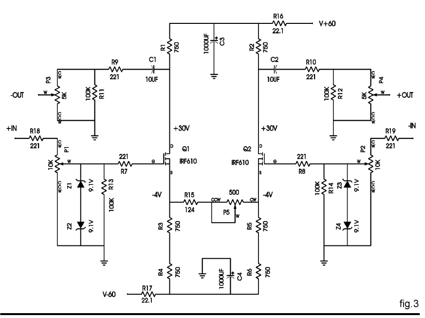

Good point. Actually it reinforces how I think I have learned anything in electronics.
Lets look at the pass circuit again (attached). If we could just look at the left half of the circuit, how were the values pf R1, R3, R4 determined?
Furthermore, what are we looking at on the datasheet of the FET, that allows us to make these design decisions.
http://www.vishay.com/docs/91023/91023.pdf
r1,3,4 are based on design currents.
Look at the circuit, as a first guess set r16,17 to 0r0.
Now use the design voltages and the resistor values shown to determine the currents.
Now imagine you have a datasheet in front of you and previous experience of using this device. You look at what you think would be a suitable operating current. Check the dissipation to ensure sufficient reliability.
Set your target voltages.
Using voltages and currents determine the resistor values.
You'll find that that first stab at setting r16,17 to 0r0 introduced a voltage error of <900mVdc
Here are the steps I'd take if I was designing this circuit.
First, I'd want to estimate how much power I could afford to dissipate in the FET. This depends on whether I have a heatsink and what the thermal resistance of that heatsink is. This allows me to set a power budget based on the maximum temperature of the heatsink. Let's suppose that my heatsink calculations mean the FET's going to be fine below 12W dissipation.
Next stage, what's the maximum current I can tolerate through the FET if all the power supply voltage (120V) is across it? This is just a worst-case figure, to allow me to get the feel of the circuit - here its (from I = P/V) 100mA.
Having set the boundaries, I'll next look at the datasheet fig3 to see what VGS (gate-source voltage) I can expect at 100mA. This turns out to be about 4V - again, its a maximum figure because the 100mA is a maximum. Note that this figure is strongly temperature dependent for the FET, but given the high power supply voltages in comparison to it, we don't need to be worried overly much about that.
Now I'm in a position to estimate the various circuit voltages. The gate will be at 0V and the source at -4V. Given the source voltage, I now choose what the quiescent current will be through the FET in selecting the values of R3 and R4. I am guessing there are two resistors here because they'll get quite warm. We have a voltage across the pair of (60-4) = 56V. The series value is 1500 ohms setting the bias at 37.3mA. Notice that this gives me a very big safety margin - its only about 1/3rd of the maximum. Dissipation in each resistor will be I2R = (0.0373^2*750) = 1.05W so we really need to specify 2W parts as a minimum. Preferably mount them a fair distance from any electrolytic caps too.
Having chosen the source resistors, its only necessary to choose the drain resistor R1, depending on how much gain we want and what output voltage levels are acceptable. Note these two parameters are strongly interlinked. Because audio signals are generally symmetrical, we want as much freedom above the voltage as below it. This is what leads to the choice of 30V as the output quiescent level. Given the drain resistor will drop 30V, its simple to calculate its value as (30/0.0373) = 804R. We're already using some 750R so its not much of a compromise to use one of these, the dissipation is the same as for the source resistors so it also needs to be 2W.
Now, looking at the schematic again, I see there are 22R resistors in series with the 60V power supply. So these will change the circuit voltages somewhat. I had no idea how much before I calculated the FET currents, but it was necessary to start somewhere. Now then, a quick sanity check to see how much difference those resistors are making. We have two FETs running at 37.3mA which is 74.6mA, this current through 22R gives a voltage drop of 1.64V. Not very significant in the scheme of things, so I don't need to redo my resistor calculations.😀

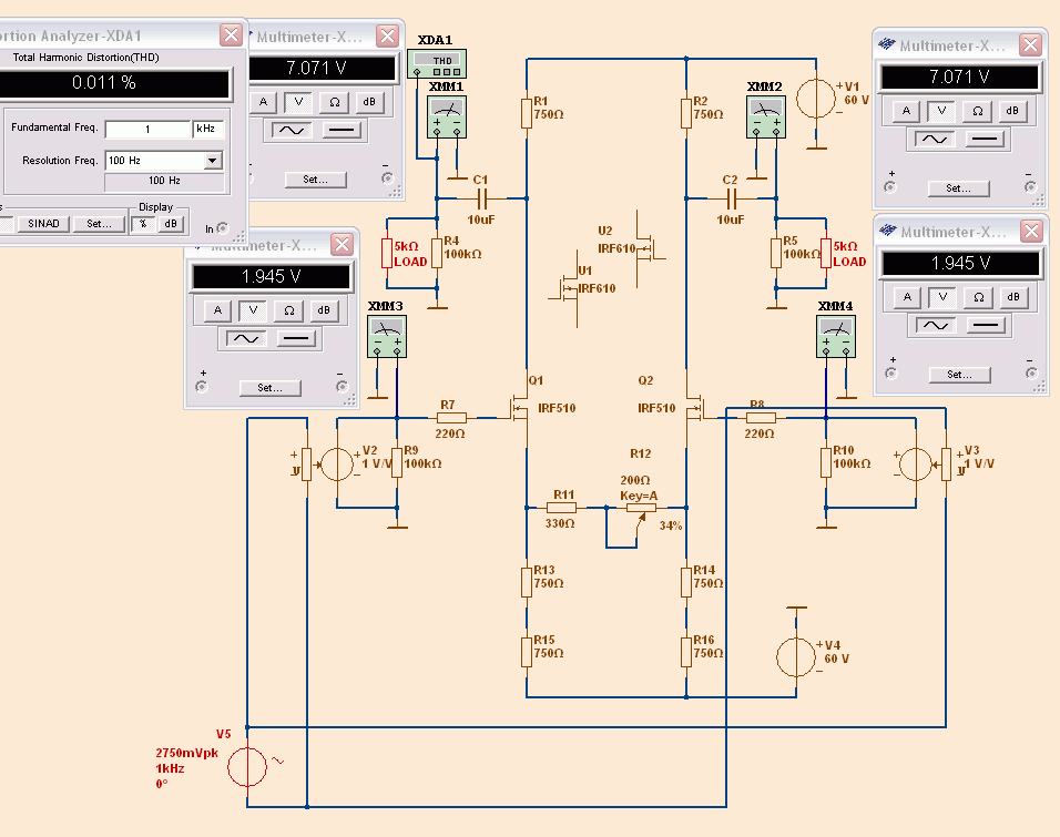

Thanks for the posts above. The step by step descriptions is very helpful. If others have different approaches I'd love to hear them as well. Hopefully others can benefit as well. Biasing is pretty key to building amplifiers!
I have setup your circuit in SPICE.
Input signal is 2.75Vp + 2.75Vp
Output is 10Vp + 10Vp (same as 7.071Vrms at each output)
While testing it shows that IRF510 has less than half THD% distortion than original IRF610.
At least those SPICE models I have tells so.
I have replaced the original 124 Ohm resistor with 330 Ohm + 200 Ohm trimmer.
This way you can adjust to get the gain around x4.
The gain is a bit load dependent.
With only those 100k at output the gain is higher.
But putting a load, 5k in my circuit, the gain will be lower
so you need adjust the 200 Ohm trimmer a bit to compensate.
The gain depends on R1 750 Ohm / the impedance below the source.
Load resistor 5k will be parallel with the R1 and give a resulting impedance
at the DRAIN of ~652 Ohm instead of 750 Ohm.
This means gain will be only ~86% of the teoretical value.
Finally.
At output swing of 10 Volt peak with only 0.011% THD
this is a remarkably good circuit! Without global feeedback.
Well done Mr Nelson Pass 🙂
