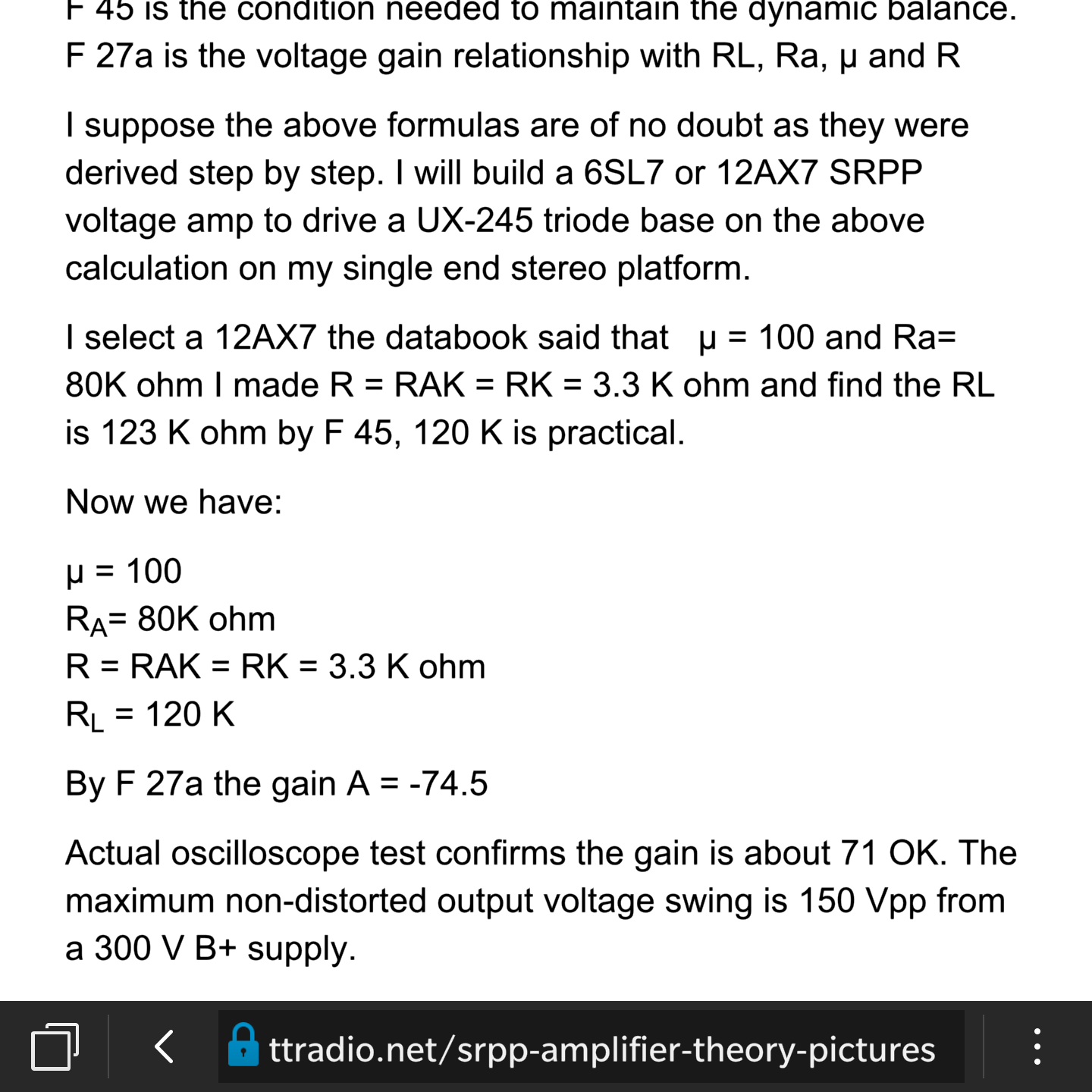

my question is his bias point
in the last page he wrote that:R=RAK=RK=3.3K ohm
we know that in srpp for two identical tubes,the current for both is equal when we input no signal,and the voltage for each one will be half of the B+
I wanna know that for finding the optimim point of bias,he used 150v for the exact point of bias? or the same 300v?

typical newbie reaction is to look at tubes as if exact values to the decimal point is possible..
a triode common cathode will seek its plate current with a given cathode resistor, tube variations will not make exact results if that is what he is asking...
nor 1/2 b+ with 300 vdc will not give you exactly 150 vdc, it is possible, but expect a slight variation of a few volts...
I suspect that analysis is flawed. He replaces each valve in turn by a short circuit. He should have replaced each by their anode impedance, in my opinion. Hence it is likely that all his formulas are wrong. See the Valve Wizard site for a better analysis.

With "identical" and ideal triodes the plate of the bottom triode should be at exactly 1/2 of the supply voltage, assuming identical cathode resistor values. In real life it would not be unusual to see this vary by 5-10% or so due to manufacturing variations causing no two triodes to be perfectly identical. Matched triodes can make things closer to ideal, although this is rarely required, as it won't make much of a practical difference in use.
