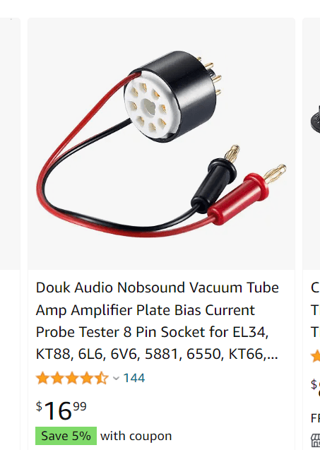

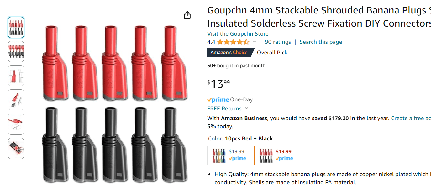

Instead of poking around with a multimeter under the hood. A breakout jig like this would be better: But even this kit should be using shrouded banana plugs instead of these exposed ones. If I owned a biasing jig I would cut off exposed banana plugs and replace them with shrouded ones.
Shrouded banana plugs:

Oh, and I've broken 2 tubes with one of those bias testers mentioned above, they put pressure on the pins and break the glass. I'd stay away from the Noval bias tester. Octal tubes don't have pins passing thru the glass like that, they're prob ok.
