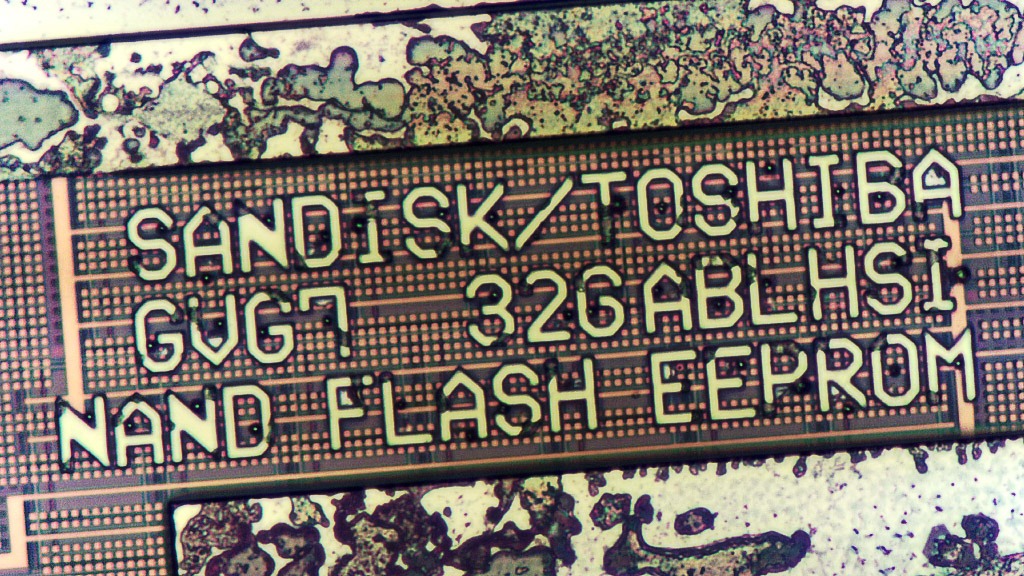

Accidentally I bought EOC E-203 metallurgical microscope(a copy of TMR-1 Yashima Optical Co. Tokyo Japan), it was just too tempting $150 for a nearly new machine. What can I say?
The right type of the lens-objective does matter. When my VST machine-vision pipe uses the lens borrowed from EOC E-203, the image quality is way better than with my cheap bio-objectives. I uploaded two short videos VST+5X lens, and EOC E-203 with the same 5X, if don't care about the shaking problem and the worse light source, IMHO, VST+5X is almost the same good as E-203.
5X looks optimal because of VST's 1-3X zoom, I found that objective on Aliexpress for $26 i.e. 3x more than bio but it is worth it.

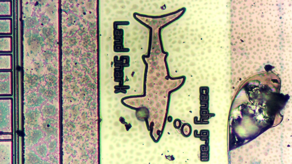

PS: 40X is also impressive if you like to see some hidden logos and internal product names like "Land Shark" for ADAU1701 etc:

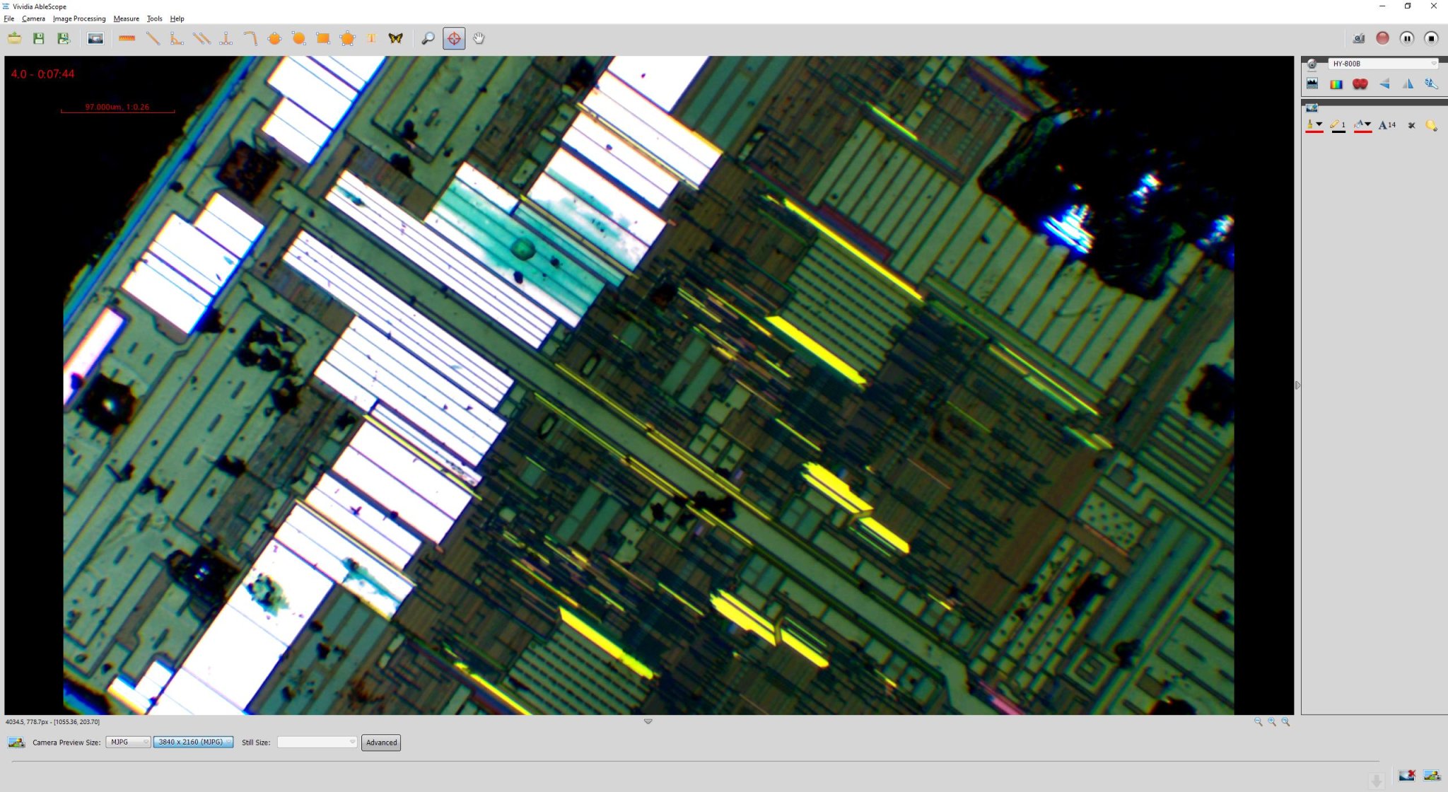

E-203 has a polarizer-analyzer pair, actually, it is a pair of linear-polarizers 90+/-25dg oriented. That trick makes the image colorful and more contrast for some parts of a silicon die.
Another interesting shot is a tiny mems oscillator, it looks like an LC-based one.

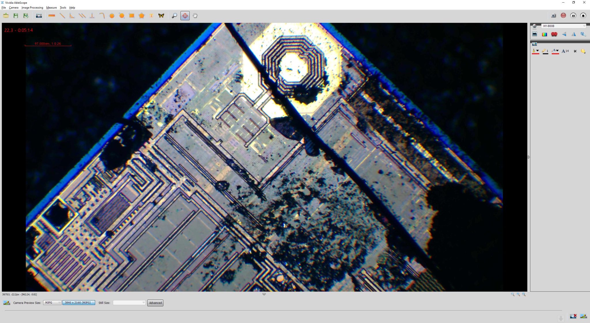

They appear to be the input pairs for the opamps. Emitters are the middle contact, you can see the metalization between the pair, the bases are above them still within the inner oval, collectors are connected to at the edge of the die. The larger purplish oval appears to be the isolation tubs for the transistors.Actually, 700x700 um for a simple opamp like that is kinda large. But then again, it's probably limited in size by the bond pads. At some point the signal does need to come off the chip... 🙂
I'm puzzled by the round structures near the bottom. ESD diodes?

I think pics are just ok, at least I saw the Olympus BX51 result and it was a lot cleaner. However, for <$100 my true DIY variant is probably unbeatable indeed 😉These are very nice pictures!

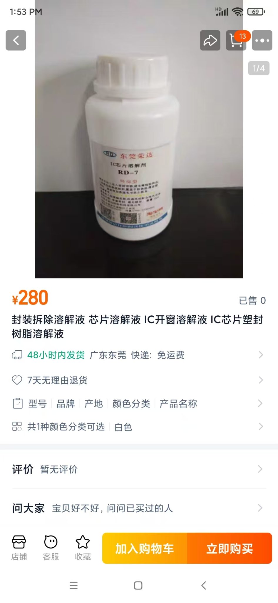

jneutron, lgreen I have a question for experts. Is there any better staff for the decaping than H2SO4+HNO3 mixture 200C heated? I found in Taobao some "special and improved solution" for decaping ICs, see attached. So, I wondering, is it well well-old acids mix or some advanced, perhaps more active organic compound?
We had a chemist to do decap. I was not involved in the chemicals. But removing stycast epoxy or the globtop stuff used to protect the chip was very messy.
John
John
I would be concerned about an agressive plastic/epoxy solvent in a plastic bottle. It seems like a prescription for a very bad mess. Am I missing something?
I get your point, yet I would hope that the composition of the bottle could be correctly chosen.
Epoxy resin is cross-linked and is robust against solvents, strongly oxidizing acids are used to decap by reacting directly with it, not dissolving it.I would be concerned about an agressive plastic/epoxy solvent in a plastic bottle. It seems like a prescription for a very bad mess. Am I missing something?
It wouldn't surprize me if that bottle is PTFE which is unaffected by even the strongest oxidizing acids like aqua regia, and is often used for chemical storage containers.
OPA1611 has bipolar input whereas LME49990 was JFET input.... Either we are fooled or designs are partly reused?
Landshark was a character in a series of "Saturday Night Live" skits from the 1970's. I believe that it was "Candygram" which got Gilda Radner or Lorraine Newman to open the door.PS: 40X is also impressive if you like to see some hidden logos and internal product names like "Land Shark" for ADAU1701 etc:
"Candygram for Mongo" also a line from "Blazing Saddles"
