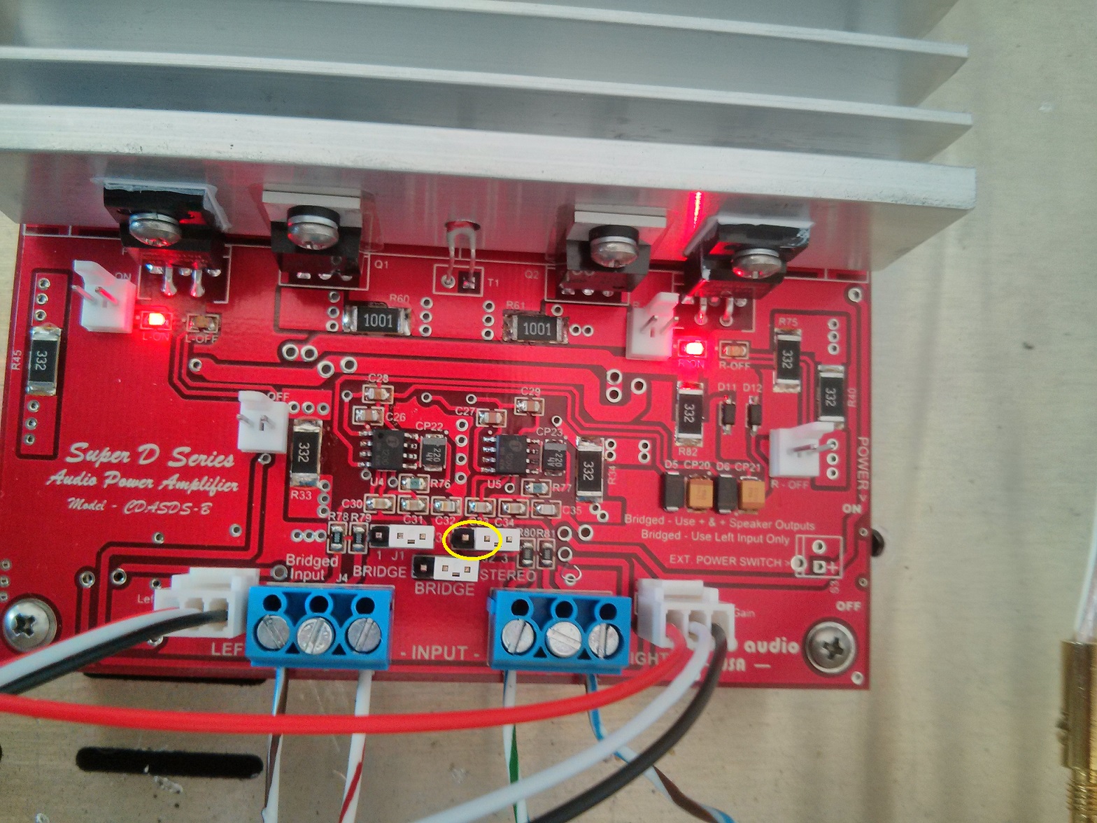

thanks for the tip, exactly what I should do? see the pic below, so just jump another side (in yellow) for one channel, then switch +/- on speaker of this channel? any change on input? (reverse the polarity of input of this channel?)

Yes correct , Jumper in yellow , speaker reversed on that channel . that's it .

tried but didn't work, jumper in yellow made no sound, and reversed input caused a big hum noise
Don't you have a manual ? The website states that you can reverse the input polarity by changing jumpers : "The balanced input stage is one of the finest available and normally only found on very expensive high-end equipment. When using single ended inputs, you can change a jumper to select inverted or non-inverted input as well... useful in some instances"

If you figure this out , the buspumping will be gone or at least much less.
