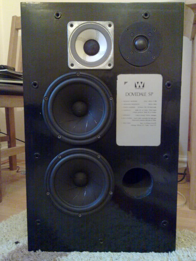

In other words, ive kept the cabinet the same, and used the same Mids, or im trying to anyway, the bass are scanspeaks 18w/4531G00's and the tweeter is D2905/950000 and the Xover has been upgraded with new better components to suit. Im thinking an alternative would be to try find some 3.5" mids with similar charactristics but at 90dB response to flatten out the overall freq response. Anyone got any view on this - or should i just do as badman said and use a line-level EQ?
Heres a crappy pic of one cabinet so you can see what it looks like and drivers/placement etc. - sorry for the quality.

Wow, looking at the bass drivers and tweeters you are using I would be sorely tempted to:
-1- Shell out for a midrange that is in the same league as the bass and tweeters,
-2- Invest the effort in a new cabinet (OK I am making a wild assumption here, but the odds of the alignment being ideal is pretty low).
-3- Spend the time to get the crossover optimised for the drivers. (This is unlikely to affect the bass end - but will make a massive difference to midrange and treble.)
Probably the most significant issue I see here is: If you have not tweaked the cabinet volume and tuning for the drivers, there is a very significant chance that the bass is indeed coloured. Have you modelled these drivers in your cabinet?

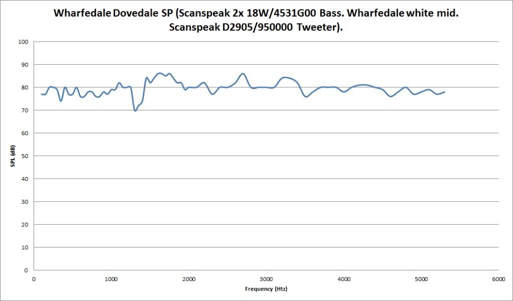

yes i modelled the drivers in this cabinet and it came out actually very well surprisingly. This is one reason why i bought them in the first place. Also the cabinets are 50litres on paper and according to my measurements they are 55 litres and the reccomended size on modelling came out at 53litres so its pretty much spont on size wise. The dimensions are optimal as well, the only thing is that the lower midrange possibly slightly resonates but i am not sure if that is due to my room which is quite small. Ive just played about with placement of the cabinets and i got a significant improvement already by pulling them away from the backwall. Also, ive been looking at every last piece of info on the midranges i still have and im not so sure if they actually are 87dB now. :S ive emailed an old tech guy that works for wharfedale to try get more info on them which i know will be correct. Failing that ill just have to find some new mids. Also i was thinking when i have more £££ and possibly a new midrange eyed up ill go and get the cabinets professionally tuned at wilmslowaudio because i just dont have any access to decent equipment.
OK all thanks for the advice, I have found success! I am still awaiting a reply to my email about the wharfedale midrange's from the tech man i emailed but i am starting to think their sensitivity might actually be 90dB after all.
