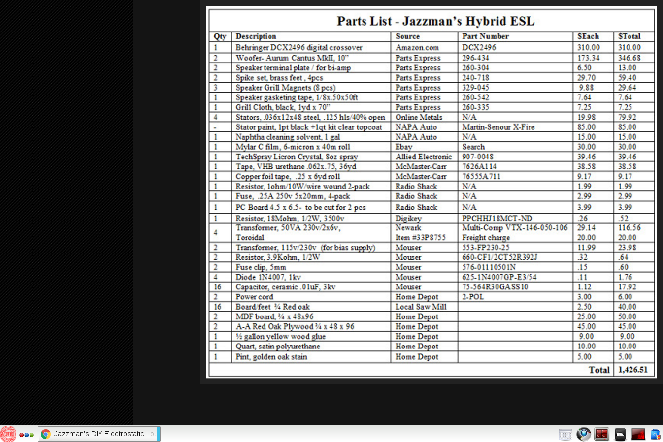

Here is a snapshot of his partslist and it shows the model number of the VHB tape he uses from Mcmaster Carr.
Jazzman's DIY Electrostatic Loudspeaker Page: Parts/Price List (updated 4/5/13)
