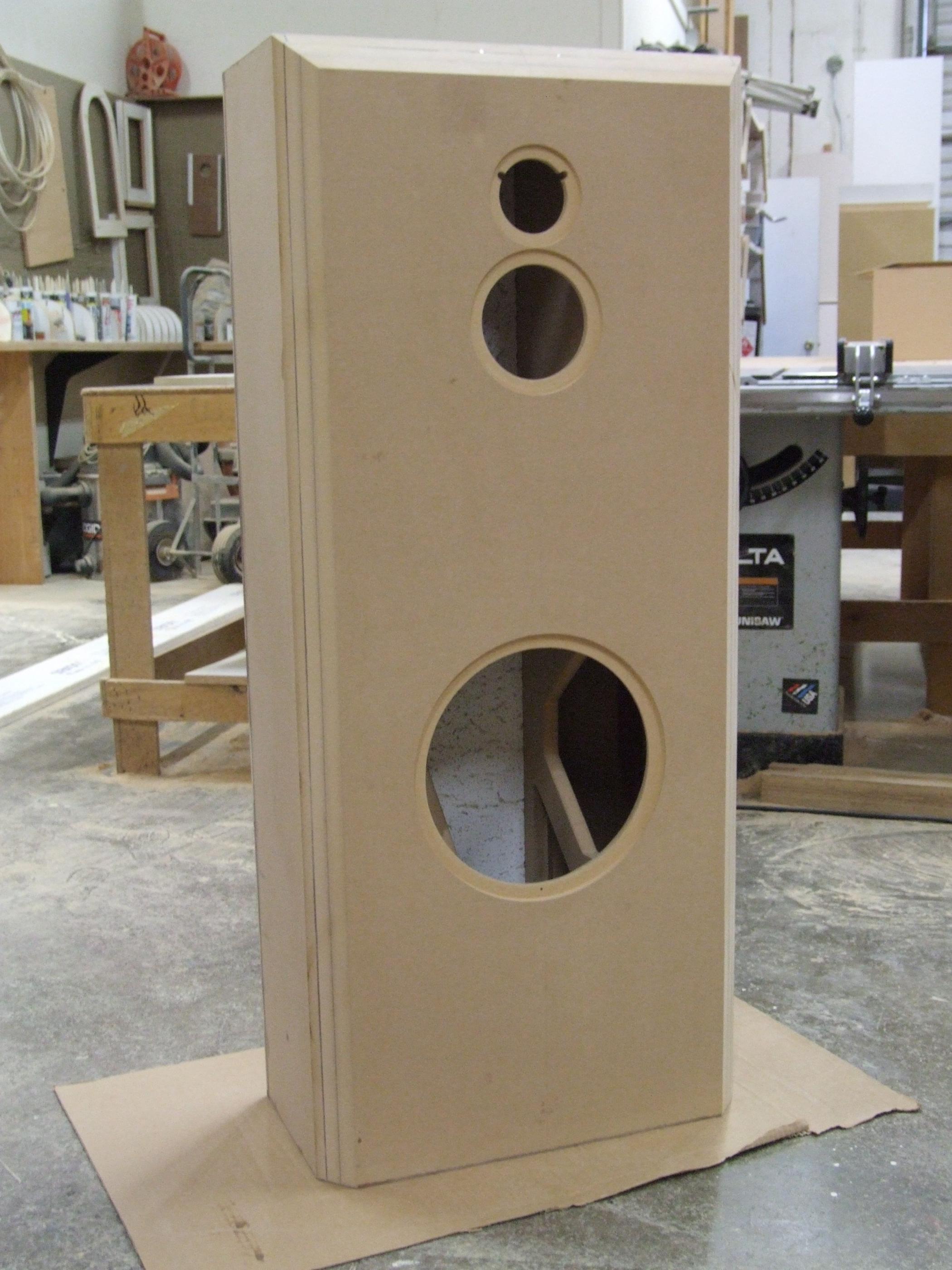

Butt joints and drilling end grain didn't seem the right way to do things when I put my speakers together. Butt joints can a pain to align and clamp. Whilst drilling end grain on MDF, even with pilot holes is a lot of work and the MDF can bulge.
I instead used biscuit joints. Once I'd played around with a biscuit joiner for an hour or so I realised that I could produce very strong joints that aligned perfectly and stayed align when I clamped them up.
The speakers were build with an inner 18mm MDF carcase, cross braced, all biscuit joined using PVA. Wrapped around the inner was another 18mm MDF box, again biscuit joined but epoxied together and to the inner. Heavy and very strong.
And a couple of pictures...
The final speaker, one of two 🙂
